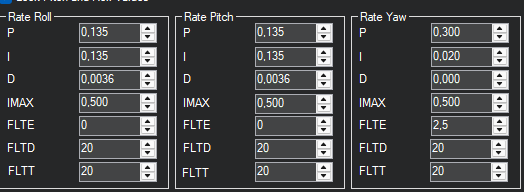

Can someone send the default PID values? I don’t know if I messed up but now with the new build I get potential thrust loss on althold, but no problem in stabilize. But I don’t seem to be losing altitude during the “thrust loss” period

AMC shows you the default of each parameter in it’s mouse over tooltip.
And if the parameter has the default value it’s presented in cyan. So it’s very fast to see which parameters are not default

The parameter default values are different for each FC board. You can only get them by extracting them from YOUR flight controller.
AMC does that automatically for you.

The default gains do not change per board. Other default (primarily hardware oriented) parameters do.
It’s possible one might find that the OPTIMAL tune changes on a per board basis due to measurement differences. You’d have to be pretty dialed in to notice this.
Like @Yuri_Rage said, PID default values do not change, but other parameters do.
Some change depending on the compile options. Some might change if you overwrite their value while compiling.
That’s correct, but you need to know parameters names. Novices usually use GUI and configure PIDs in Extended Tuning tab, but it’s not clear what parameters are really changed, it would be good to have the real parameter name if you hover over label, same as you get description if you hover over value itself.
