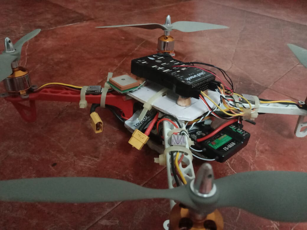

Hardware:
Pixhawk 2.4.8
F330 frame
A2212 1000 kv
(:backhand_index_pointing_up: yeah, yeah, hardware to avoid :sweat_smile: )
3S Molicel P45B battery pack (self-soldered :slight_smile:)
Emax Bullet 15A ESC
9045 props (very good quality, it seems to me)
Neo 6M GPS module (Just for AutoTune)
The FC is mounted using earplugs I cut with thing gel tape on either side plus some superglue like stuff on the bottom plate (I guess the earplugs are longer that required). Do you suggest I rather place the pixhawk on another plate that will be supported by the earplugs which get inserted through holes at the corners sort of like in the wiki page on anti-vibration?

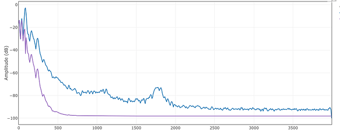

Here is my filter review with a single harmonic notch applied and using ESC telemetry (fundamental freq: 85.779 Hz, attenuation: 40 dB, bandwidth: 40 Hz, loop rate: 400 Hz):
only showing one axis due to clutter. X and Y are almost identical.
→ Any idea why there are peaks at 7.9 Hz and 39 Hz? Are these bad? Could it be because of the longer than necessary earplugs?
Get rid of the soft mount entirely and simply mount the autopilot with some 3M mounting tape or screws. Those soft mounts can actually induce oscillation modes that screw with the tune more than they reduce vibration. There are few cases where they are actually warranted.

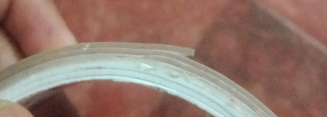

3M mounting tape OR screws? You mean hard-mount with screws? Also since I don’t readily have 3M tape available, would normal double sided tape or a few layers of this thin gel tape (photo attached) or a layer of some sort of sponge do the job?
Yep. Hard mount (or thin gel tape). Your mounting solution should transmit frame motion as directly as possible. Resort to those damping solutions when they prove necessary as a last resort, not as a rule.

It’s dangerous to do autotune before you setup adequate filtering. I doubt you need 8khz imu rate on such big rig, all motor noise will be in 100-300hz range, so try to disable fast sampling - this will give you better frequency resolution to analyze.
INS_LOG_BAT_OPT,4
INS_FAST_SAMPLE,0
I see you have bdshot working, so RPM filter is a way to go, but you get errors in communication, try switching to dshot300 or 600 (bdshot should not work with dshot150 you configured now)
after errors are gone try filtering like this
Also looks like the PIDs are messed up, try with default PIDs, they are good for 9”

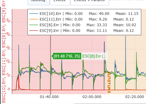

I was using DShot300. I didn’t see the error logs. Will check that and find whether the errors are on the two forward motors whose cables I had to extend using jumpers.
Can you confirm whether Motors 8,9,10,11 correspond to ports 9,10,11 and 12 respectively?
As for the PIDs, the aren’t the defaults higher? With these values I still have oscillations in Rate out for pitch and roll
ESC number starts from 0, so yes, usually ESC 8 and 10 means output 9 and 11, they have 11% error rate. Try twisting the cables, maybe need to shield it with some foil and keep far away from power. You can lower PIDs from default by 50% for test.
5 is DShot300.
Yeah 9 and 11 are my front motors. The jumpers aren’t twisted. I’ll twist them.

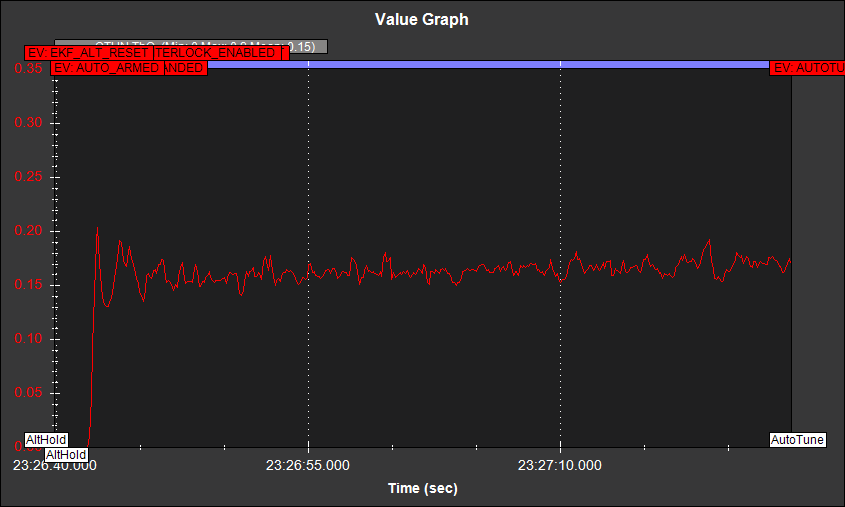

Do you think that my MOT_THST_HOVER of about 0.17 is a bit too low? I mostly flew in AltHold because I can’t reasonably hover in Stabilize given the fact that I also need to pitch and roll to keep the copter in position. Its that hard for me lol
No. That’s a good thrust to weight ratio. You just need practice.
So there couldn’t be a possibility of an error in this parameter since I flew in AltHold instead of Stabilize? The docs say to fly in Stabilize, that’s why
You need to fly in an altitude keeping mode for the hover throttle parameter to be learned.
The docs recommend stabilize for the first flight to minimize chances of fly aways.
Here is your throttle output while hovering in altitude hold. ~0.17 looks perfect.

Should I apply the tape on the four corners or paste one large strip down the middle? The width of the tape is 1 inch
I’d do two side-by-side strips about the length of the autopilot to give the most security.
Okay cool. I’m going to try this but why does everyone suggest soft-mounting, using 3M foams on 4 corners of that vibration isolator mount with the rubber gummies?
You’re looking at decades of forum responses, some of which are overcome by events by now.
Those techniques aren’t necessarily invalid, but they should only be employed when necessary rather than as absolutes.
