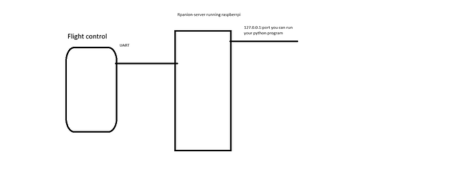

use this,
You don’t need to do any configurations. directly like plug and play.
Thyank you @stephendade for developing such a great tool.
if need any help how to setup i will guide
all the best @Yash_Shaw
please use your time will save, and with this rpanion-server you can do a lot of developments
