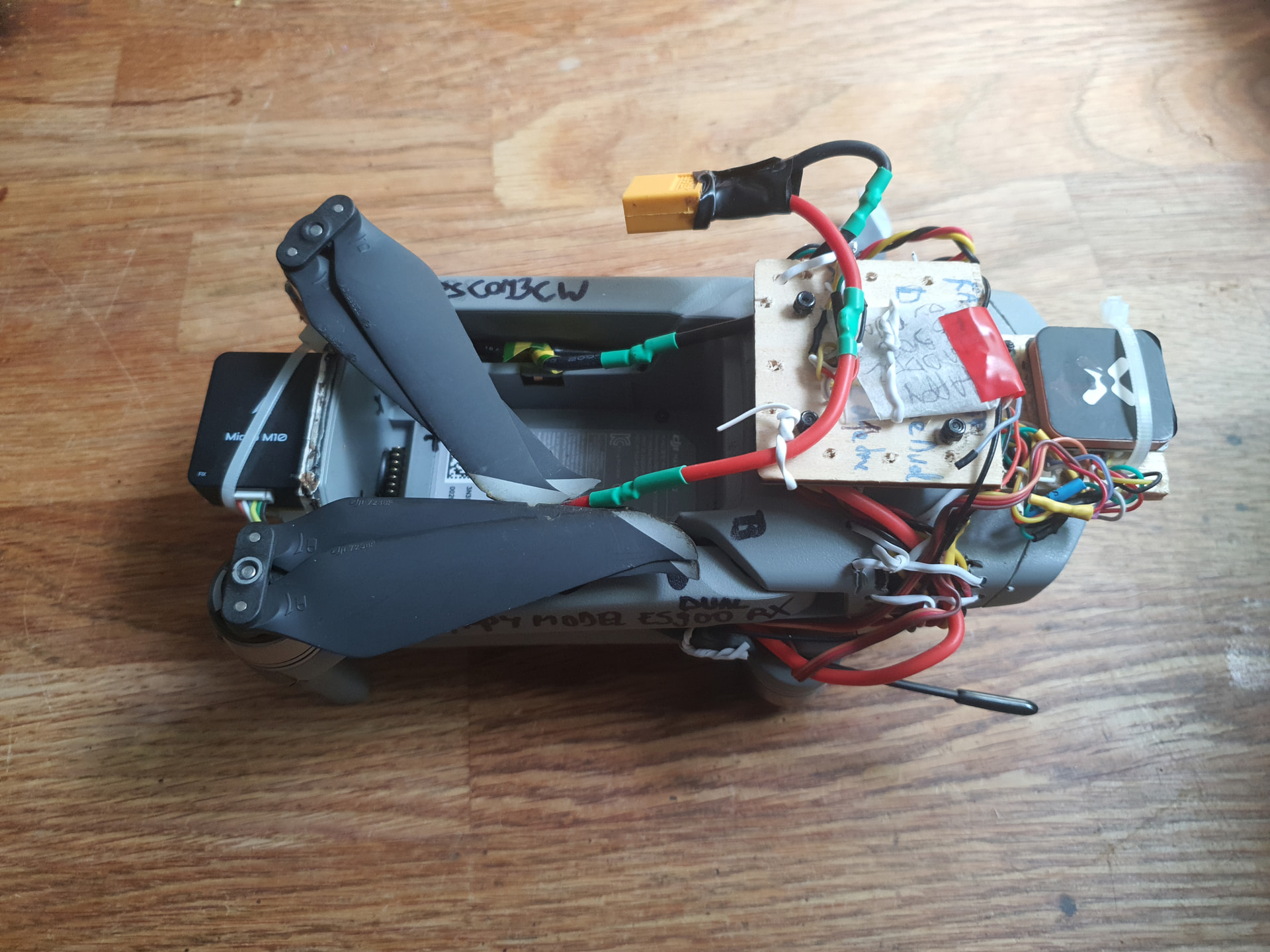

I have problems with assuring a smooth ride of a converted DJI Mavic Air 2 drone. It is reasonably stable in Loiter, and when flying AUTO, it looks great from the ground but logs show some oscillations (which sometimes are that big that make visible jerks in the video footage).

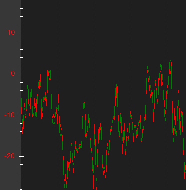

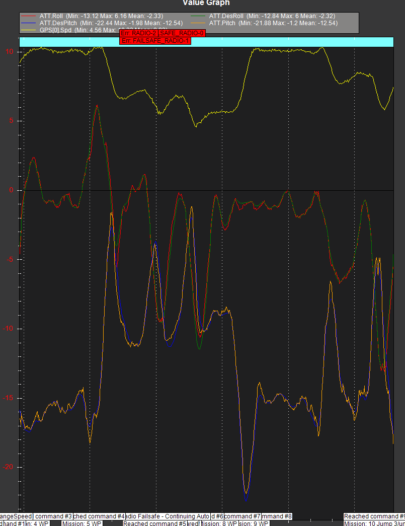

-there are both pitch and roll oscillations, which seem to be commanded (so not bad tuning?). How to fix this, or diagnose that it’s a problem with say airframe stiffness?
-why there are so big pitch increases in turns? This happens in every turn.

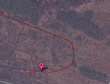

First of the two pitch excursions in the right side of the graph happens here (entering the turn):
Is this expected? Should the copter slow down for some reason? (too big lateral acceleration?)

Hi @maciek252,
The roll and pitch tuning looks pretty good. There are some small overshoots so perhaps reducing the ATC_RAT_RLL_P/I/D and ATC_RAT_PIT_P/I/D by 5% might help a bit.
.. but I think in general you just want the vehicle to be smoother when flying? I think you could reduce some of the WP_ or PSC_ parameter values to do this. So for example these two will reduce the acceleration (and change in acceleration) of the planned path.
  • WP_ACC : try reducing from 2.5 m/s/s to 1.5
  • WP_JERK: try reducing from 1 to 0.5
To reduce the reaction to position disturbances you could reduce:
  • PSC_NE_POS_P: try reducing from 1 to 0.5
  • PSC_NE_VEL_D : try reducing from 0.25 to 0.15
These are just ideas, I normally leave my vehicle with the defaults.

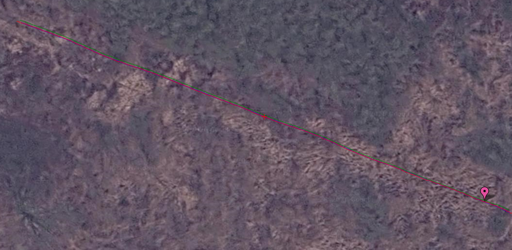

Thank you so much for your kind response, and in particular that you’ve given the exact values to try. I guess this part of tuning is covered to a much smaller degree than the Attitude/Rate PIDs. And also not adjusted by any autotune, in principle this should be possible, should it?

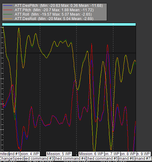

I’ve flown the same pattern. It was quite windy, but the pitch excursions are still there. It seems that before every turn the copter pitches positively, as if it wanted to slow down?
For example, there is a pattern of a “trident” in the pitch graph corresponding to the three turns one close to another. First of these turns is quite gentle, so no reason to slow down?
The log
(fw upgraded to 4.7.1)
Is this circuit too tight for flying with constant speed? How to recognize this?
There are significant pitch oscillations also in a straight fragment of the track:

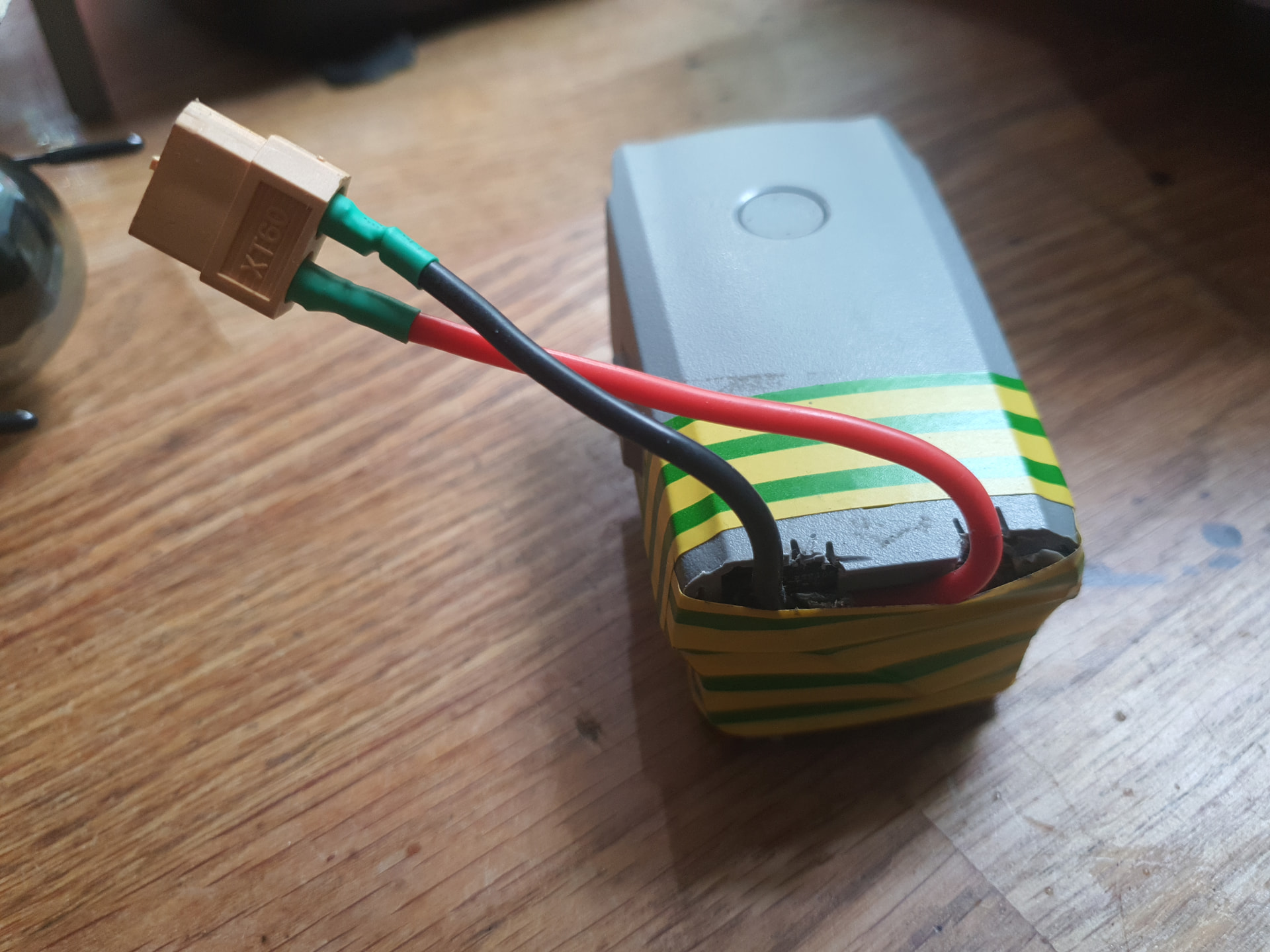

I think you have a 3S Lipo, so you need to set these:
BATT_ARM_VOLT,11.00
BATT_CRT_VOLT,10.50
BATT_LOW_VOLT,10.80
BATT_FS_CRT_ACT,1
BATT_FS_LOW_ACT,2
MOT_BAT_VOLT_MAX,12.60
MOT_BAT_VOLT_MIN,9.90
They are really mandatory, not optional. Don’t skip any.
If you have a different battery type then please provide that detail.

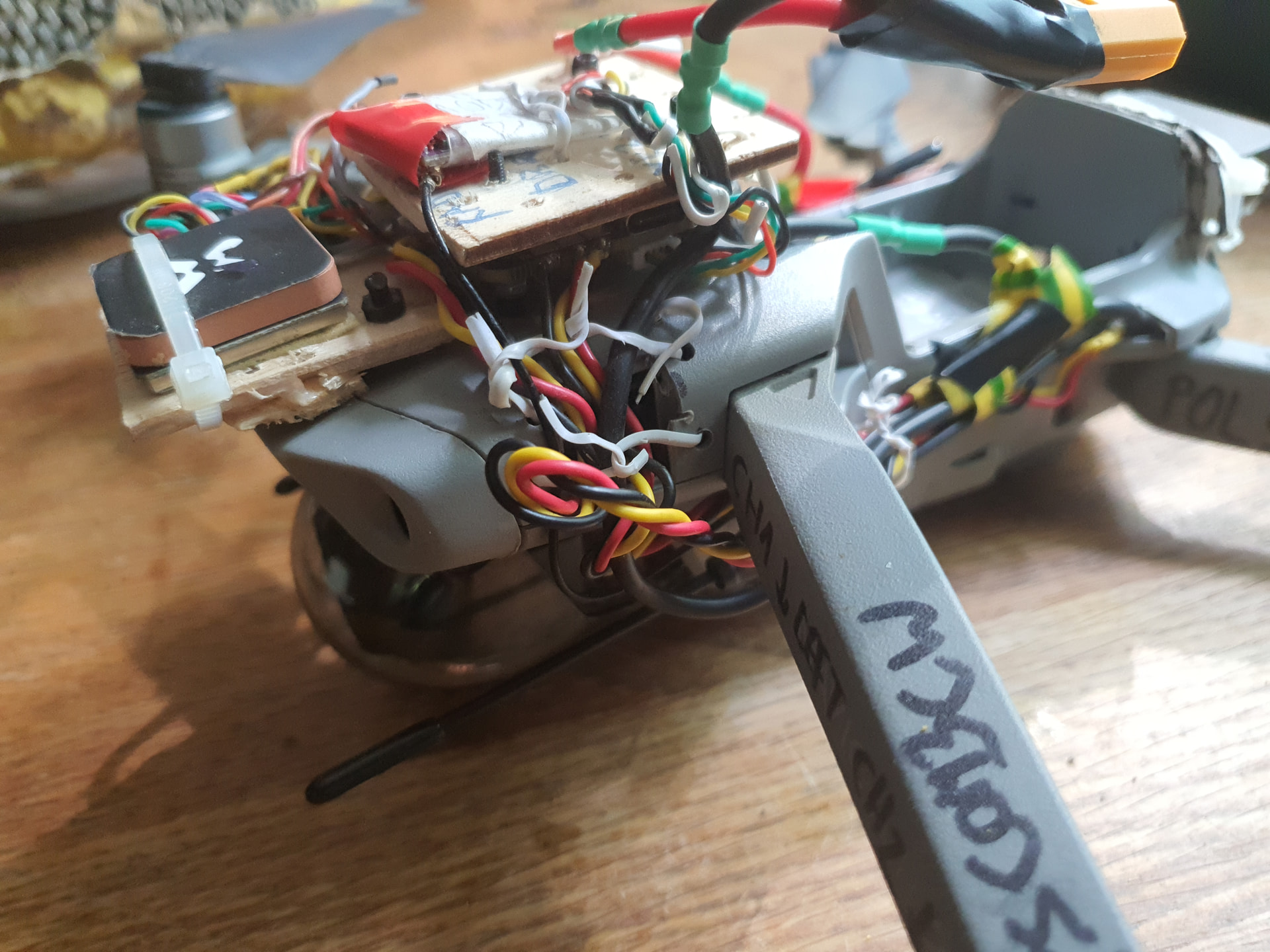

The copter is no longer DJIish, its soul is already ArduCopter :slight_smile: I just want it to fly inside the gimbal’s envelope, these oscillations are sometimes too big for what this gimbal can take (mostly around turns, usually fine when flying straight or ligthly curved fragments). But this is not necessarily specific to DJI, all the other gimbals behave simillarily.
What is strange to me is that these oscillation seem to be commanded, so not related to vibrations, flexible airframe etc. Or is this conclusion not justified and some problems can result in this desired control?
BTW I think the conversion DJI->ArduCopter is maybe the most cost-effective solution nowadays to get a decent gimbal+video running Ardu. Used DJIs are quite cheap (even better when crashed and not flyable but still recording), you need just an MicoAir AIO H743 v2, a gps and an ELRS RX and thats all. And you get really good quality camera/gimbal and a well-proven airframe.
Yes, and once the tuning is a little better we can adjust a few more things to give the gimbal a smooth ride.
If you’ve been able to convert a DJI you might want to do a blog post on that with some photos.

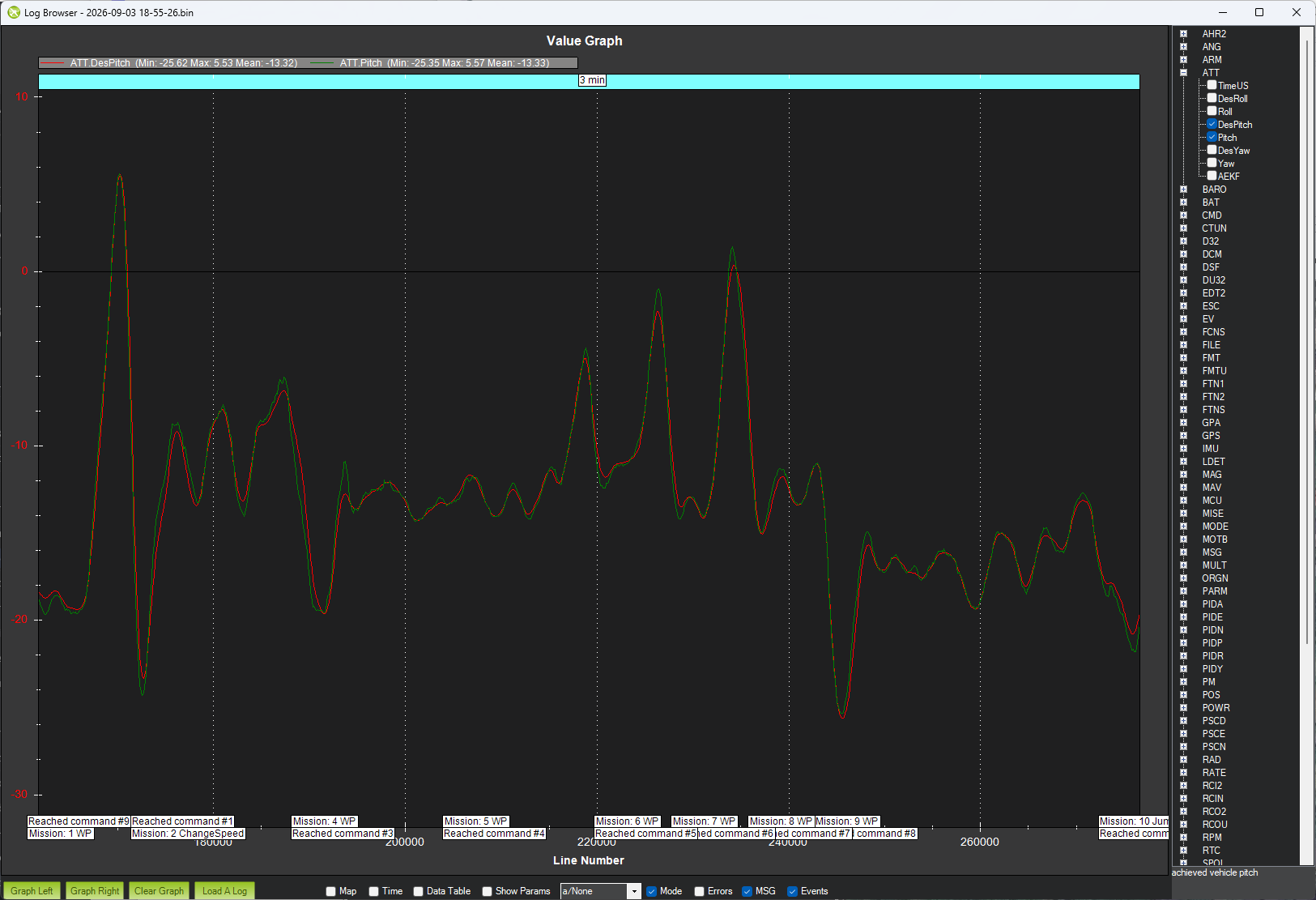

So I’ve tested the suggested settings. But I’m not sure about the conclusion. I have a feeling that some micro-jerks appear now (not the big ones in turns), which were not present when I started tuning. I’ve need to experiment also with the DJI’s gimbal setting, they have some settings such as Speed, Smoothness and Rotation Speed for pitch and yaw, I wonder what is the relation of these with the ArduCopter’s auto turn curves and yaw speed/acceleration).
I present two movies and corresponding parameters: from today, with the changes:
the parameters
and when it started flying decently but before optimizing PSC (I used the automatic video settings here, and now I know this was not good as it used 1/60 shutter and this causes motion blur, better to use manual settings and select 1/100, 1/120 and adjust ISO depending on the conditions)
and the parameters for this case

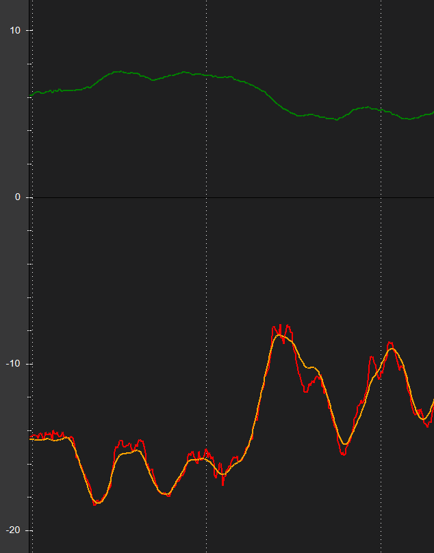

I’ve analysed the logs once more and the problem is that the airspeed changes because of the turns, and accelerating/deaccelerating causes the pitch excursions.
Look at the graph (the final track uploaded above):
GPS speed (how to get the estimated airspeed?) is plotted on the top (the yellow line), and pitch in the bottom. It can be seen that when starting to accelerate, the copter pitches much too aggresively.
Should I further reduce WP_ACC and/or WP_JERK? How are these two parameters related? Is WP_JERK defining how quickly the horizontal acceleration changes? (a kind of a third distance derivative?) It can be seen in the graph that the acceleration is constant for most of the time (airspeed growth is linear), so what is causing this very big pitch change? Is this an attempt to reach the constant acceleration, so should WP_JERK be further reduced? Do you have some practical recommendations?
The same for the much smaller airspeed changes in the left part of the shown graph fragment: the airspeed changes are just small humps, but the pitch excursions are significant, so does this mean that the copter wants to reach the constant acceleration much too quickly?

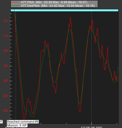

-the only problem still present and preventing the DJI quality is that the copter accelerates and slow downs with a jerk. As shown in the graph, even for a relatively small change (8->6 m/s) the pitch changes around ~ 10 deg, it is not much but unfortunately visible in the footage. I’ve reduced both WP_ACC and WP_JERK, but I have a feeling that these values do not work as they should. The WP_ACC range is 0.5 to 5, does it work when set to say 0.4? WP_JERK range is 1 to 20, does it need to be an integer? Can I set it to say 0.3?
In the graph I show the speed (taken from the GPS) and the commanded and actual pitch:
Can you advice how to make these pitch variations smaller, even if taking longer time? Int his
footage, the problem occurs around 0:44. As it can be seen after 1:33 and the final turn, the speed has been reduced with a DO_CHANGE_SPEED and there are no gimbal jerks, however it would be better to limit the acceleration and not the speed.
The log
RPM sensor library isn’t used used for filtering so it shouldn’t matter.
Ardupilot uses max lean angle and speed parameters for feedforward so if you have decreased max speed feed forward may be too strong. There is a parameter for yaw rate in automatic modes. IIRC the copter will keep moving while pointing sideways, we don’t have coordinated turns for auto.
