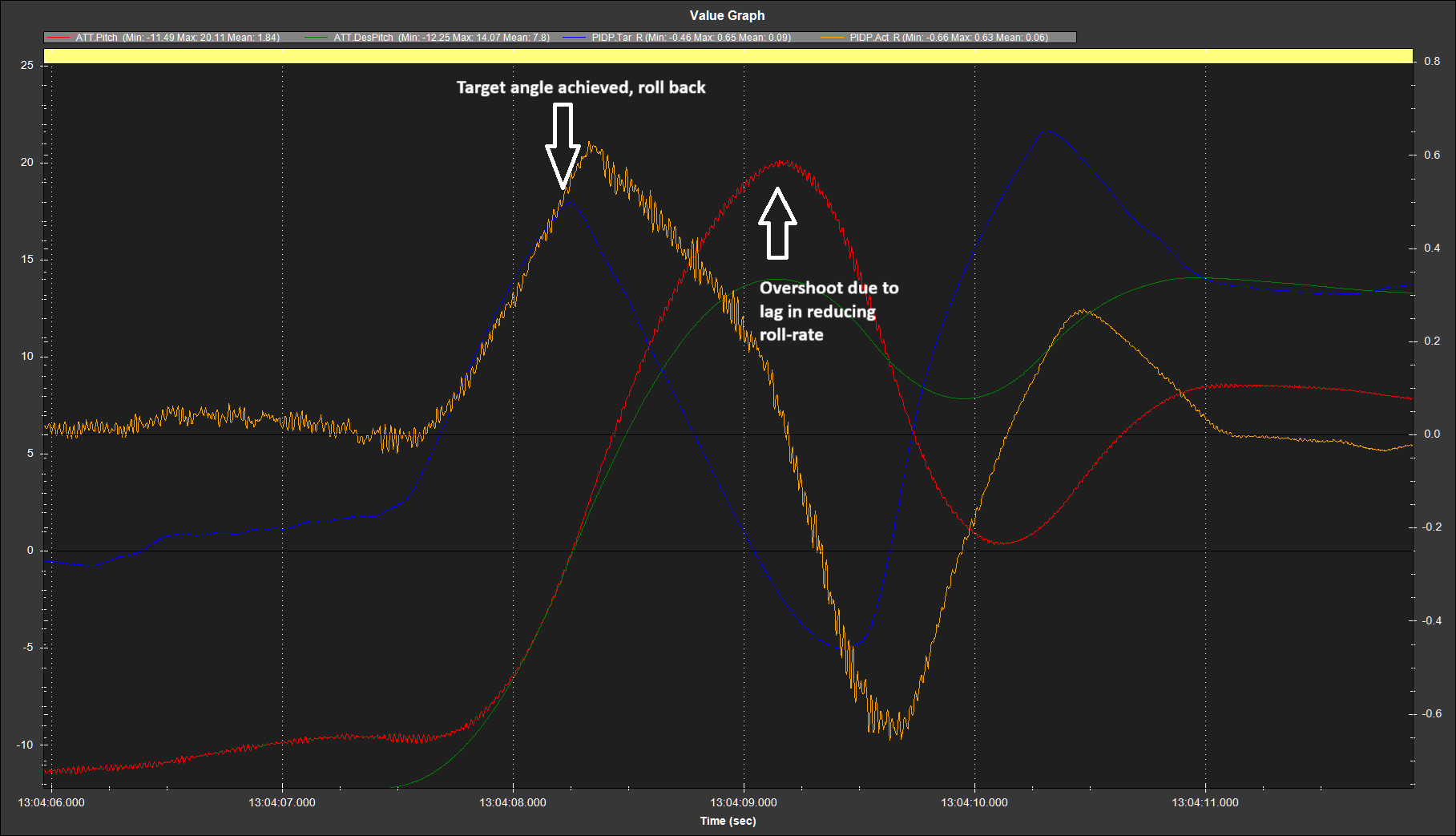

We have a heavy lift copter that is exhibiting severe oscillations in the pitch axis when braking in loiter mode. Here’s what we know so far:
  • The issue only happens in the pitch axis (where there’s more inertia), roll axis is flawless.
  • Visibly, we see the vehicle pitch back to brake but it keeps going past the angle limit, and then it quickly snaps back to level and enters a oscillation. Sometimes the oscillation dies out on its own, but with a full payload it goes unstable until we take over.
  • We have detuned PSC quite heavily at this point, but the issue persists.
  • In the logs we see that the roll rate controller requests a very large roll rate change which the Copter takes some time to hit. But by then there seems to be some I-term buildup and we enter an oscillation.
  • Turning down ATC_ACCEL_P_MAX seems to help, but even with a value as low as 3800 the issue persists.
I’ve attached two logs that show this behavior. In flight 1 the oscillation recovers on its own. In flight 2 (with more payload) the oscillation did not stop and we took over to save the vehicle.

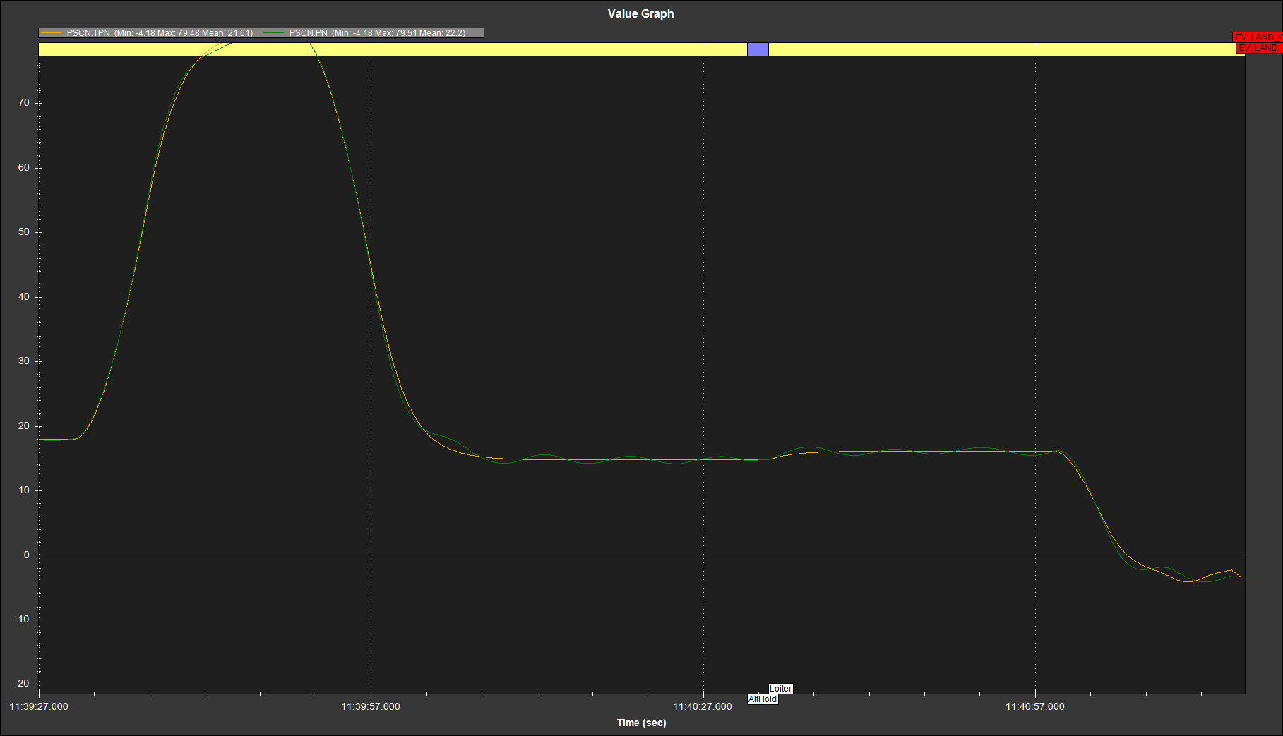

We did 20 flights today trying a whole lot of stuff. Here’s a summary of each flight and the log:
Flight 80: No payload. Updated ATC_RAT_PIT_I to 0.055 and PSC_POSXY_P to 0.5. This led to a wobbly position hold in Loiter. We saw oscillations in PSCN.PN and PSCN.VN:
Flight 81: No payload. Kept ATC_RAT_PIT_I at 0.055 and set PSC_POSXY_P back to 1.0. This mostly fixed the wobbly Loiter but we noticed that the copter would make noticeable position corrections to position after coming to a full stop. I think I see this in PSCN.PN as well as some oscillation around the target:

So overall we haven’t really made any significant progress towards root causing this issue. Here are my takeaways from today:
  • D-term is (for some reason) very important for this vehicle’s stability, which seems very suspicious to me.
  • I get the feeling that lowering the PIDs and rates doesn’t seem to be addressing our root issue. It seems to have an impact for sure, but the issue seems to always be there the faster we go.
  • In all of the overshoot cases we seem to have the same chain of events: PIDP.Tar requests an roll rate to achieve the braking angle, which the vehicle hits. Then PIDP.Tar drops to try to hold that angle but due to inertia the copter keeps pitching. I-term builds up, and at some threshold it suddenly corrects and overshoots. One thing I’ve noticed that the PIDP.Tar has a pretty steep “triangle” shape where it requests a roll rate until the desired angle is achieved and only then starts backing off:
@Leonardthall would it be possible to have the rate controller start backing off the target pitch rate before the target angle is hit? Basically as we get closer to the target angle we want to reduce the pitch rate instead of waiting until the target angle is hit to reduce the rate. So when the target angle is hit the pitch rate is already close to 0. I’m hoping that this would allow the rate controller to keep up with the inertia of this vehicle without needing to build up I-term.
