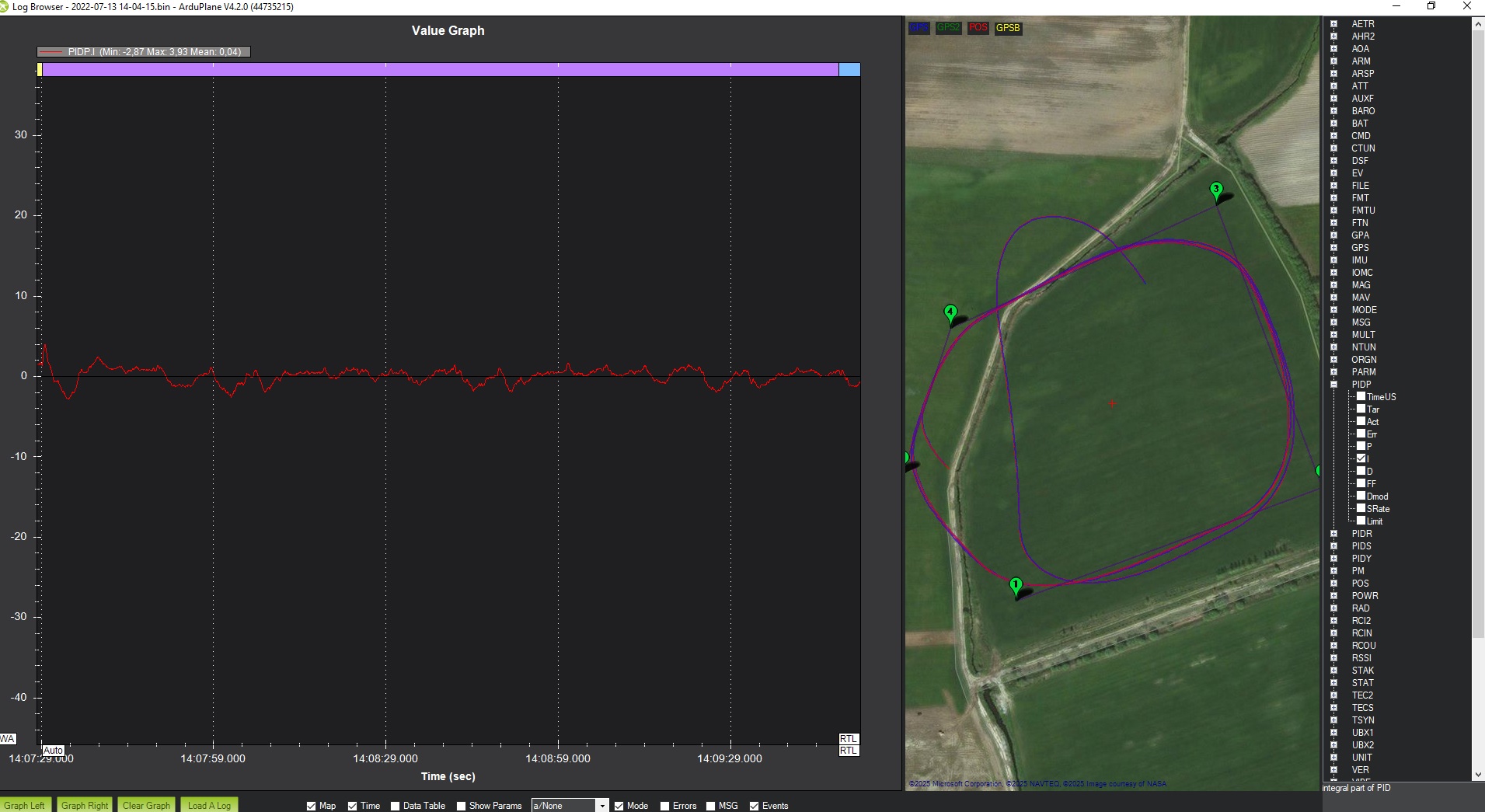

One of the key things you should check after your first flight is whether your CoG was in fact correct. Check your flight log and look at the state of the pitch integrator. The pitch integrator is in the PIDP.I field in your dataflash log.
If your plane showed a value of PIDP.I consistently above zero then your plane was needing to put in up elevator to stay level. Your plane is probably a bit nose heavy, or your elevator trim is incorrect.
If your plane showed a value of PIDP.I consistently below zero then your plane was needing to put in down elevator to stay level. Your plane is probably a bit tail heavy, or your elevator trim is incorrect.

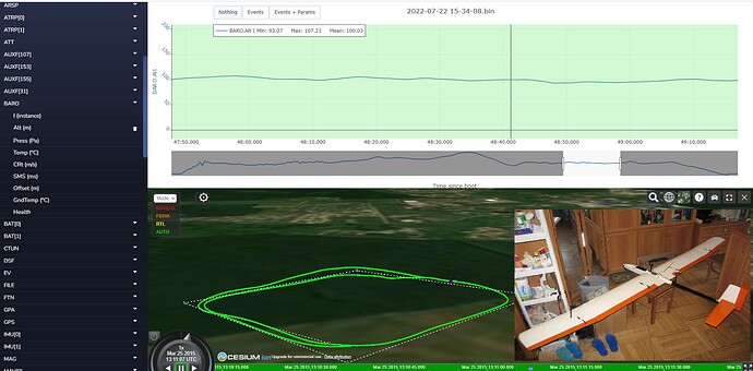

For example, I show screenshots of logs that were obtained during the flight of the Paragon training aircraft and the F3B glider. The airframe has a rear centre, so the PIDP I parameter is below zero. This centre of gravity was chosen on purpose. In other screenshots, I show the accuracy of the flight in altitude. However, I didn’t fine-tune the PID parameters because my planes fly quite steadily on their own without a flight controller. When your object can fly itself, it only needs a flight controller to turn in the right direction during autonomous flight.
When setting up the aircraft, pay attention to the quality of the data from the IMU and the convergence in the EK3, which can be estimated by the parameters of the quaternion covariances. Perfect convergence is the proximity of these values to zero. As an example, I show a screenshot of such convergence.
My center of gravity is normal. You can see this on the graph. I checked and adjusted it. PIDP.I fluctuates around 0, so the problem is something else. In general, the plane flies well in MANUAL, very agile, powerful, although it weighs 5 kg, but I need FBWA and CRUISE modes, in which it constantly fluctuates.
I made these graphs that you suggested, but I don’t quite understand what they show. Are they correct or not?
