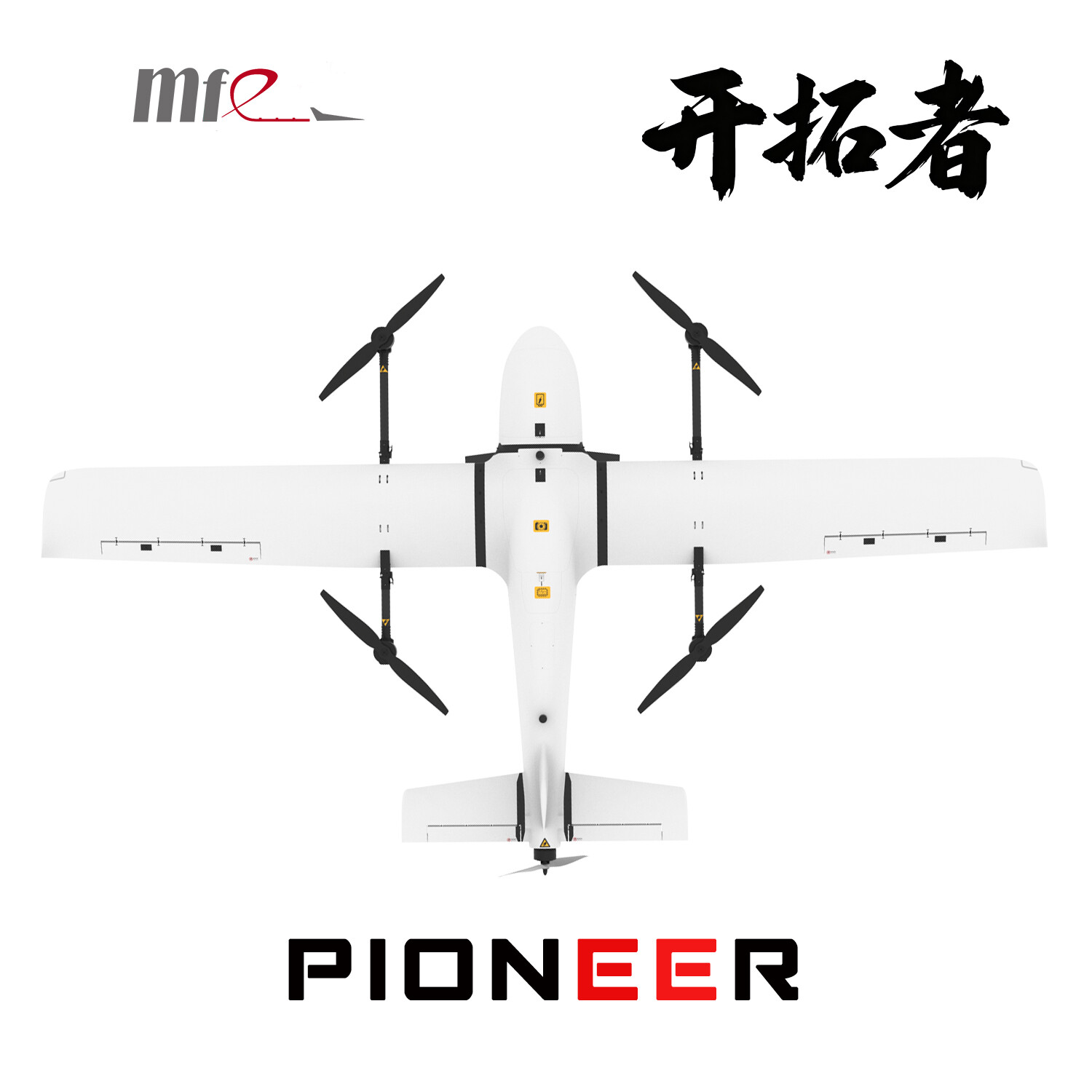

Pioneer VTOL -24kg Class 4+1 QuadPlane
The Pioneer is a 24kg-class vertical takeoff and landing fixed-wing aircraftequipped with a 3-5kg LiDAR system.
Material: EPO, carbon fiber, aviation aluminum alloy, engineering plastic, etc.
Wingspan: 3.2m
Fuselage length: 1.68m
Fuselage height: 0.41m
Distance between rotor motors: 1m
Maximum load: 5kg
Wing area:100dm2
Maximum airspeed:35 m/s
Conversion speed:16 m/s
Stall speed:14 m/s
Maximum altitude:4000m
Wind resistance: Level 5
Maximum takeoff weight: 24.9 kg(at 500meters above sea level)
Disassembly method: quick disassembly with-out tools
