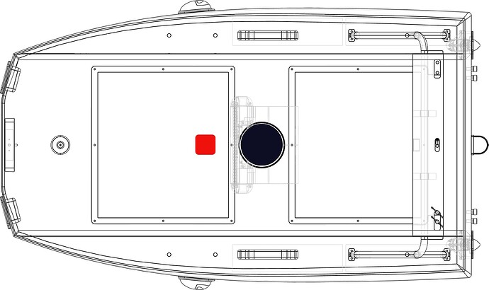

  1. I have to specify the offset between the GPS antenna and the FCU in GPS_POS1, which I haven’t yet.

Photo:
Here is a photo of the boat with the black circle denoting the placement of the GPS antenna on the boat and the red square as the FCU:
