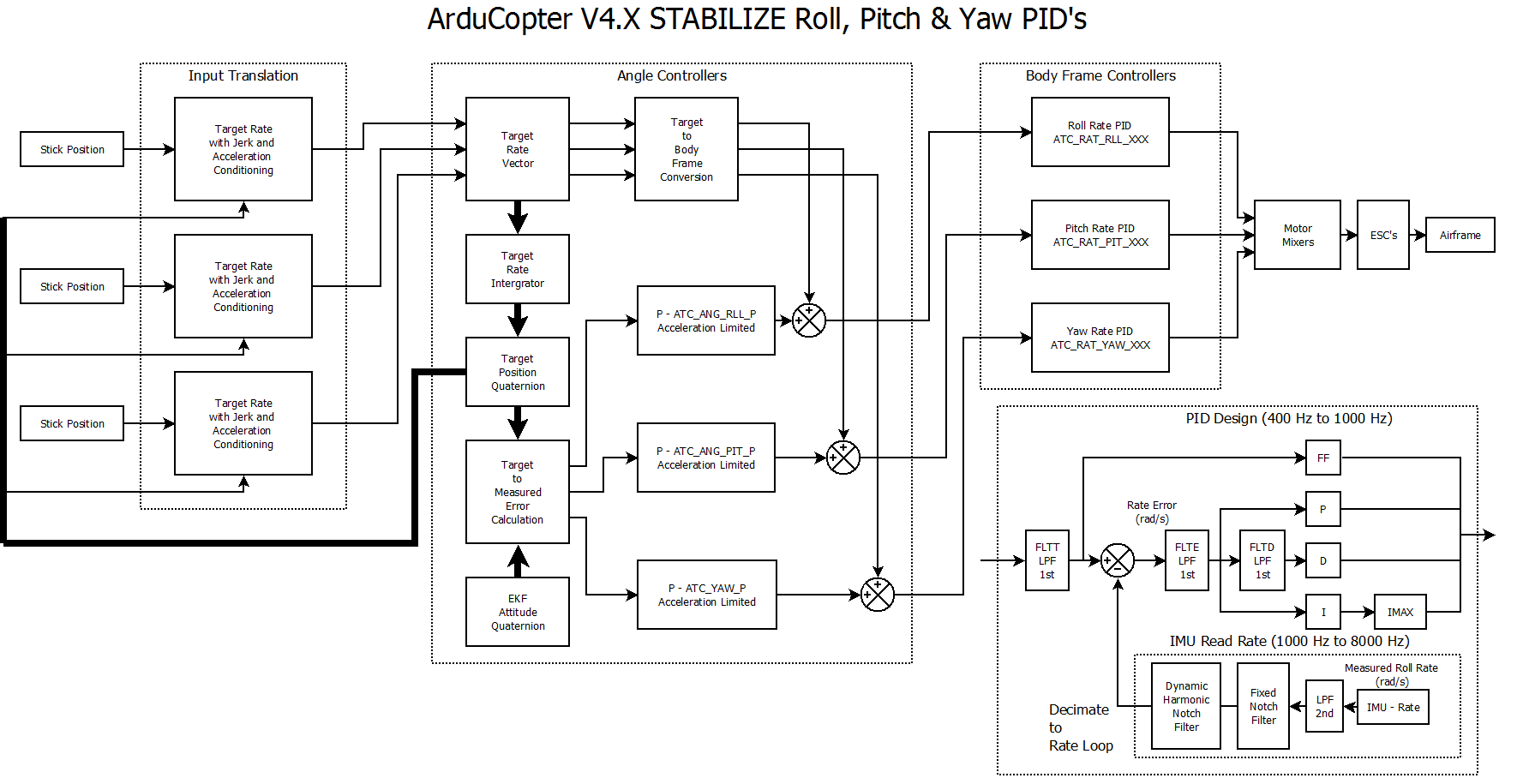

In the meantime, I am wondering whether the model for flight dynamics listed in the book “Flight Stability and Automatic Control”, by Dr. Robert C. Nelson, is to be ditched completely, in favour of what ardupilot expects? If so, how does ardupilot model short-period pitch rate dynamics ?
I don’t know that you should disregard Nelson, but you can’t just plug in an arbitrary (if popular) algorithm and expect an apples to apples result.
See here for a high level block diagram overview. From exactly where this derives, I can’t say. I’m not super involved in Plane’s code development.
