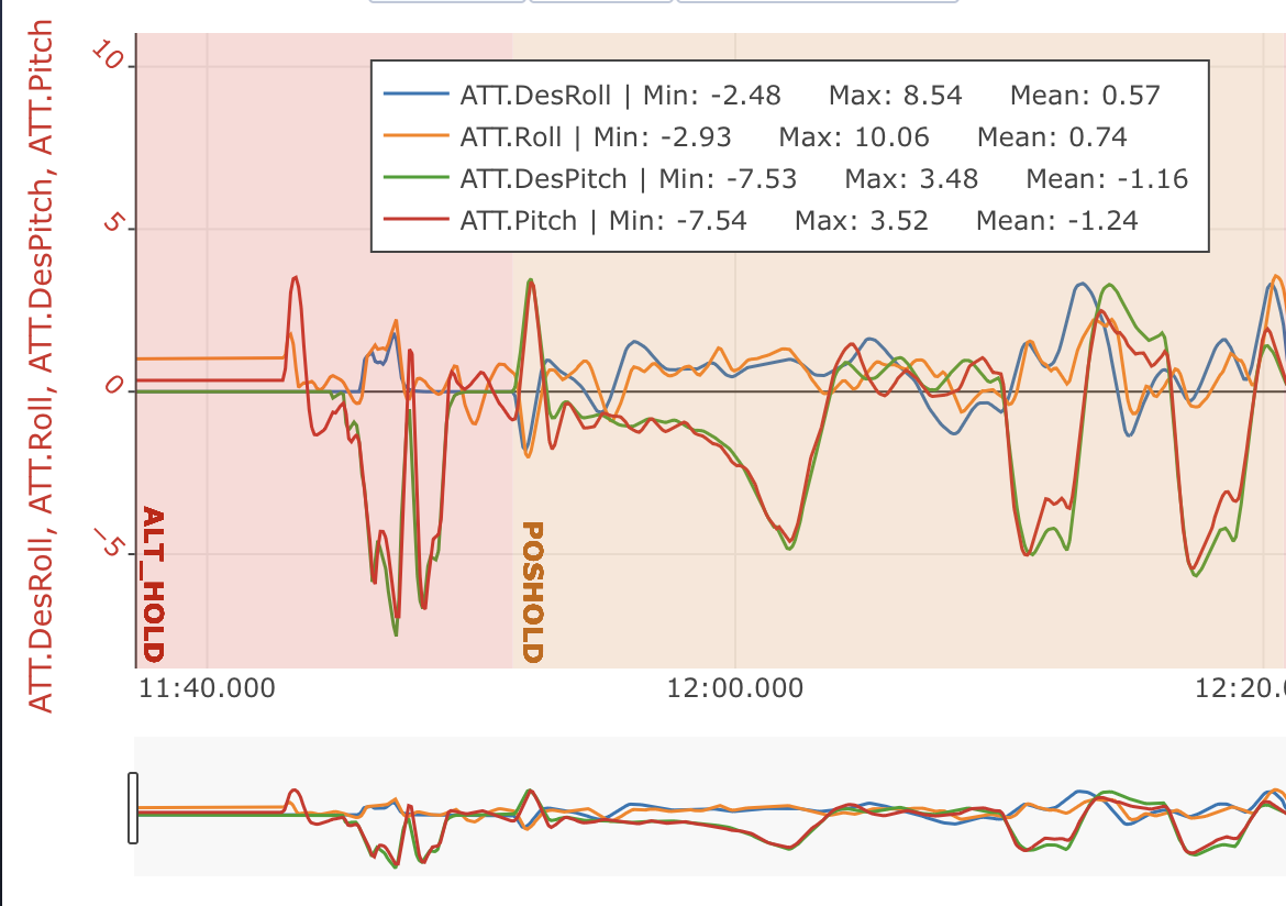

Our 20-kg quadcopter experiences severe oscillations in position-controlled modes (Loiter, PosHold) only when RTK is enabled . The issue persists even after significant tuning and in different environments.
The oscillations seem like this, and if we don’t give any input to correct it, the last 2 cycle continues and sometimes it even gives GPS glitches:

OK, I know this post didn’t get any traction, but we solved the problem and wanted to share our solution with the community if someone has a similar problem in the future.
We found out there was a problem with Wren Mini, and even if the RTK was not enabled, when the Wren Mini was primary GPS, we had those oscillations. There were some forum posts about some firmware update but that wasn’t very clear to us and we didn’t have much time to try that, so we switched the Wren Mini to F9P and our problem was solved! It flies like a dream with default PSC gains. We also performed an autotune after those logs, that also helped with the performance (not with Wren Mini, but with F9P)
So if you see any problems similar to this, keep in mind to check the hardware and chip used on RTK capable GPS system on your drone side!
