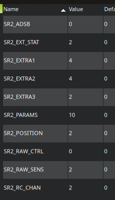

I really hope that someone can help me out here because I have tried different things for days but I can´t get ardupilot telemetry to taranis x9d sensors list through ELRS.
I have a Pixhawk 1 with Copter 4.6.3 official firmware. I have tried serial 1, serial 2 and serial 4 ports so far. Setting: SERIALx_PROTOCOL = 23; SERIALx_BAUD = 115200; RC_OPTIONS = 15136; RSSI_TYPE = 3; RC_PROTOCOLS = 512
On my Taranis x9d is EdgeTX v2.11.4 and Yaapu 2.1.0-dev. I have enabled CRSF in yaapu conf.
I have a Radiomaster Nomad dual band transmitter. Settings in ExpressLRS script: 2.4Ghz, Packet rate 100Hz full, telemetri ratio 1:4, switch mode 16ch Rate/2. Firmware 4.0.0 EU868
RX is GEPR dual 900/2.4. protocol CRSF and firmware also 4.0.0
I get only TX and RX sensors in the sensor list. And in the yaapu script I get no telemetry. What am I doing wrong? What do I have to do to get ardupilot sensors there?

yes CRSF telemetry passtrough is enabled. I just tried elrs mavlink configuration and throug that it works. MAVLink - ExpressLRS I still can not understand why it does not work the usual way.
For mavlink i had to di the following:
  1. Configure all SRx_ parameters to be 1, except for SRx_ADSB, SRx_PARAMS, SRx_RAW_CTRL that should stay 0 (otherwise yaapu will see a few sensors only and GCS might not be able to connect) Maybe if I had done this before then it worked?

  1. Configure SERIALx_PROTOCOL=X(1 for me), SERIALx_BAUD=460, and RSSI_TYPE=5
  2. Configure all SRx_ parameters to be 1, except for SRx_ADSB, SRx_PARAMS, SRx_RAW_CTRL that should stay 0 (otherwise yaapu will see a few sensors only and GCS might not be able to connect)
  3. Save parameters and reboot the flight controller & radio
btw i too have the Radiomaster Nomad dual band set to “X-Band” and the Packet Rate set to 100Hz, Link mode “MAVLINK”. telemetri ratio 1:2 (this is auto setup on firmware 4.0 you should upgrade). I did hear yappu & GCS only works with elrs 4.0 and higher.
  • When your configuring the expresslrs in your radio lua you must turn off model matching during setup. you can turn it back on after everything is working. (They don’t tell you this in the elrs setup but i had to do it).
If you doesn’t set the SRx_ values the mavlink data “floods” the CPU and the GPS and other serial ports don’t work!
