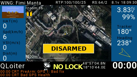

Hi Alex, in all of my airplains is your script working well, but now I’ve put together a plane, where I see on the screen a different value of RS: 64-72/2. For all other plains it is 100/2. I checked all telemetry sensors, all is the same. The radio is TX16S with OpenTX, Rx are Crossfire nano or nano diversity. Please, is the first RS value RQly? Do you have an idea why can it be different?
yes it’s RQly, I explained it here
RSSI is calculated just as ardupilot does and evaluates both antennas (if present)

Thank you very much, Alex. I found that the cable to one antenna (nano diversity Rx) was broken inside. After antenna replacement I have RS: 100/2. Great, that a faulty antenna can be detected using this value.
Alex, one more question: if Ardupilot evaluates RSSI the same way, why did I see RSSI=100 in MP even before the fix?
good question, you are indeed right, the algo used to scale the value is the same, the criteria to select the second atenna should also be “similar”, value may differ if you choose to use link quality as rssi though

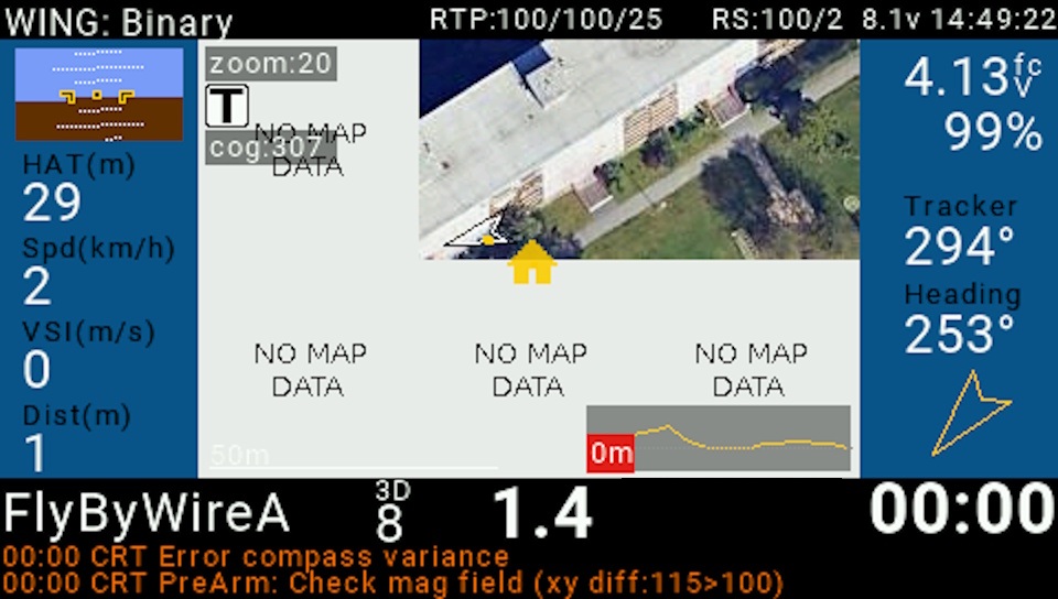

Alex, please, why can’t I see all map tiles when I set the zoom to 20?
Probably because you are missing these tiles.
Hi, most likely you haven’t downloaded them
ok, that may be, but how do I find out which tiles didn’t download? Can I use the coordinates to determine which tile numbers are missing? (I’ve been downloading this map for almost two days)
Or should I download only that missing part?
go for the missing part and copy to the same folder
