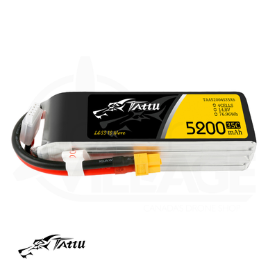

A 4S 5200mah LiPo will give you good performance. You’ll have to do some careful maths on a LiOn because you’ll be hovering around 15 amps and that’s going to be hard on some batteries. If this is your first build or you’re new to the set up, then I’d stick to LiPo now for that size.

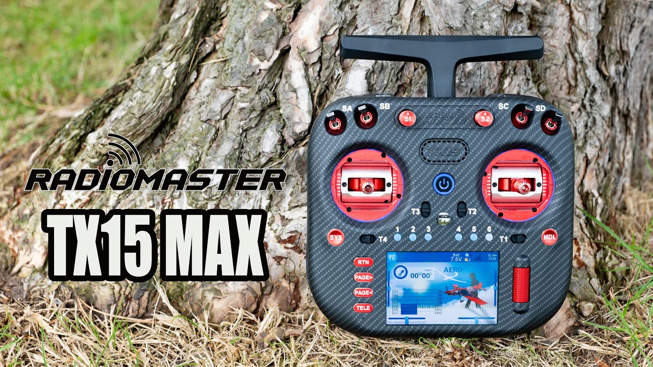

If you want to do mavlink over ELRS then look for gear with the new 1121 chipset. I’ve been using the XR4 receivers with a nomad module in my TX16s. But if I was buying a radio today I’d look either at the RM- TX15 or the GX12. (GX12 will give better data performance because it has the gemini dual radio system, but the TX15 has the better screen. Your call.)

Also, any specific suggestions for the 5200mAh LiPo? I’m not too well aware with the reliable brands. I’d assume going the AliExpress route for the battery wouldn’t be wise.
Go with the Tattu battery from Rotor Village. I have some of those.
For what it’s worth, I think the GX12 is currently the best transmitter for quadcopters and airplanes. I’m pretty sure the GX12 is the only transmitter which uses the ELRS X-band/Gemini internally.
I was initially reluctant to give up the TX16S’s nice color touchscreen for the smaller black and white screen on the GX12 but after using the GX12 a while, I realized this reluctance was not based on anything rational. Color touchscreens are nice when entering in data about a new model but once a model as been created, the screen isn’t really needed for more than identifying which model is in use. When flying FPV, the screen is hardly used at all.
In case you are not aware, the GX12 is now available in a variety of colors. If you purchase gear directly from RadioMaster, make an account, put the items you want to purchase in your cart and then leave these items in your cart overnight. The next day you will be offered 5% off.
While I think the GeminiX feature is cool and likely useful, I think the main advantage is being able to use the radio for both 2.4GHz and 900MHz receivers. The 2.4GHz receivers are nice when used with small quadcopters. Many bind and fly quadcopter come with 2.4GHz receivers. 900MHz is nice to have if you plan to fly long range. The GX12 lets you easily switch between the two bands.
You will likely want to use the Model Match feature in ELRS if you get a GX12. I’m pretty sure you need to use Model Match in order for the radio to remember which band to use with each of your models.
I have multiple XR4 receivers myself. I like the idea of having both bands being used but I’m not positive the range is any better then just using 900MHz receivers.
To get the best range possible, I think the antennas on the GX12 need to be upgraded. I haven’t done this myself yet. That said, the only times I’ve had range problems is when I forget to fold out the antennas on my GX12.
The main reason I’d go for a GX12 over a TX16S with a Nomad module is weight. The weight difference is huge. IMO the GX12 is much more comfortable to use than the TX16S.
Yeah, I think the GX12 is the one I’m going to have to go with. I also want to get into planes and fixed wings so that kind of helps that it’ll support those as well. I’ll have to look into the features of GemX and the GX12 much more after I get it. Seems like it has a lot capability. Regarding the receivers, the RM XR4 I was looking at wasn’t in stock. Are these 2 on par with it, or is the RM one much better?

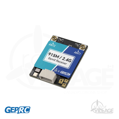

I’ve installed one of the Geprc receivers. It was a little frustrating because the firmware on the RX didn’t default to having the wifi turn on. So I had to use traditional binding then force the wifi on so I could update and do all the other stuff I wanted. I haven’t flown this RX yet but just on the bench something about it just doesn’t seem as polished as the radiomaster. All subjective, and in the end it’s done everything I’ve set out to do.
But next time I’d buy the XR4. EpicFPV has them in stock.

GX12 vs TX16S/Nomad. Ford vs Chevy. I would have totally agreed with @ddegn’s comments until I picked up a TX16S mk III. It has the same internal TX as the GX12 so that’s equal as far as I know. It really comes down to personal preference. I do a mix of FPV and LOS so I see value in the colour screen with Yaapu. I like the form factor of the GX12, but when I tried it the switch positions got in the way for me (I fly pinch and I will admit this is also another personal preference). My advice: Pick the one you want that fits you. Buy it. Never watch another radio review video until you’re ready to buy a new radio. If you’re debating between GX12 and TX16mk III, you’ll be good either way and it will be a few years before you need to spend that money again.
Edit: I was wrong.
I don’t think that’s correct. I’m pretty sure the new TX16S can do 2.4GH or 900MHz but not both at the same time using GeminiX.
I’ll edit this post with a link to information soon.
Edit: It looks like I was wrong. On the new TX16S product page one of the features is:
Internal RF Module: Dual-band Gemini 2.4GHz and Sub-G 900MHz
Edit again: I’m likely biased towards lighter radios. I’m over 60 and I had neck surgery a couple years ago. Any reduction in the weight on a transmitter is greatly appreciated. The large color touchscreens are really nice. The large screen is really useful for displaying telemetry. The GX12 is the best transmitter for me, but it isn’t necessarily the best transmitter for everyone.
I have a strong bias toward the TX16S because there isn’t much that competes with it for my use cases and desired features at its price point. I don’t much care about the touchscreen itself because I do most of my model editing via PC. But the large color display is great for telemetry on more complex craft. If I were solely into FPV, I think my opinion would be different.
Yeah, I think the GX12 would really be the top line for me as well. The TX16S looks like it can do everything I need and much more but I just know I’m not going to use a LOT of the features on it. I probably won’t even end up using a lot of the features on the GX12. I’m new to this world and really want to just get something that will last me a decent amount of time. These are my first purchases and I think the GX12 is more suitable
I was trying to figure out why I thought the new TX16S didn’t support GeminiX. I’m pretty sure I got the specs of the TX16 MK3 mixed up with the RadioMaster TX15.
As Ian explains at 6:10 in the video linked below, the TX15 only has one RF module so it can only transmit on one band at a time.
I’m glad I was corrected.

I am using batteries from both Gens ACE (Tauttu) or CNHL. They are both work great.
In the past I used batteries from GOLDBATT, they were always less than the specifications and were really only good for ground vehicles.
CNHL is all out of stock on their website and Amazon only sells them in pairs, which I don’t really need. Searched up some company called HRB and it seemed like alright enough. Is that a reputable enough brand? I’m trying to get something that is reliable enough for the time being, don’t want to go complete overspending. The Tattu one that sells at RotorVillage is supposedly a “smart battery” and I don’t exactly plan to also get the Tattu PSU/Charger so it’s like do I even spend an extra 30 for that
