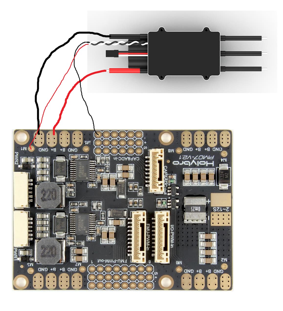

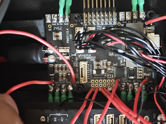

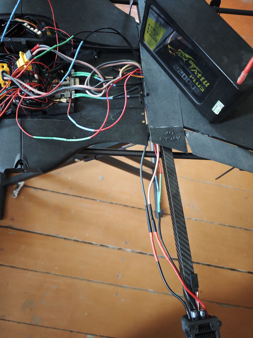

At this point, I’m starting to suspect a hardware or wiring issue, so I’d love a second opinion on the physical connections.
Here’s my configuration:
  • Flight Controller: Pixhawk 6C
  • Power Module: Holybro PM07
  • Battery: Tattu 6S 22000mAh Li-Ion
  • Horizontal Motor: AT4120 + ESC T-Motor FLAME 70A
  • Horizontal Propeller: T-Motor FF15x8
  • Vertical Motors: T-Motor MN501S
  • Vertical ESCs: T-Motor FLAME 60A 6–12S
  • Vertical Props: T-Motor P16x5.4
What I’ve tried:
  • Rechecked PWM signal wiring (M1–M4)
  • ESC calibration (Q_ESC_CAL = 1) successfully applied
  • ESCs receive power and ground directly from the PM07
  • External UBEC provides 7.2V to the servo rail
  • Ground lines between ESCs and Pixhawk confirmed
Questions:
  1. Does anyone have experience connecting the Flame 60A to PM07?
    Are there known issues with these ESCs when used with this PDB?
  2. What is your opinion on using standard “banana” connectors (the 4mm type) between battery → PM07 and PM07 → ESC? Could resistance or loose fit affect ESC startup?
  3. Would it be beneficial to add capacitors (e.g. low ESR electrolytic) to the PM07 output lines to stabilize current spikes for the ESCs?
I’ll add detailed photos of my wiring and schematic shortly in this thread.
Just want to make sure I’m not missing something basic on the electrical side.
