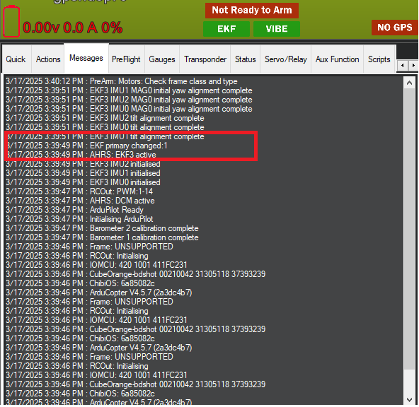

I’m not sure why this didn’t pop up in my search before starting this thread - an old post of mine about IMU issue: EK3_IMU_MASK - CubePilot caution to set to "7"
The value of EK3_IMU_MASK is indeed 7. There’s also an additional mavlink message at startup about changing the EKF primary to 1.
Maybe that’s how it’s suppose to work - or maybe there’s a parameter change that has the EKF primary start out at 1 so it doesn’t have to change.
Yes, working as planned.
If you updated to latest stable firmware and reset all to default it should be good to go.
Update the bootloader too, for good measure.
