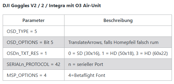

@Target0815
Thanks for the reply. I’m not using the O3 VTX—it’s the first-generation DJI Air Unit.
The O3 isn’t permitted for use under Japanese regulations.
I tried it just in case, but the OSD still didn’t appear on the DJI Goggles.
Then as I mentioned, but MSP_OPTIONS = 0
I also assume that you have connected RX/TX from the FC crosswise with TX/RX of the AirUnit. How serial interfaces are normally connected.
I have the RX and TX cross-wired to the FC’s SERIAL2 port.
The issue was resolved by changing the following parameters:
MSP_OPTIONS 4
OSD_OPTIONS 32
OSD_TYPE 3
SERIAL2_PROTOCOL 33
