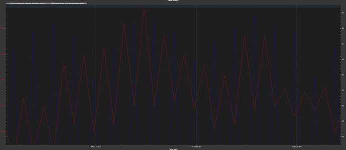

Here’s a plot of your Servo 1 output, vs. your X-axis vibration. Your servos are responding to vibration.
I think you need to fix this first.

I am not sure this is the issue. The helicopter flies steady in any free mode. The servo rods, blades and everything else was checked and mechanically calibrated. I think it’s having vibrations because the serves are moving, not the other way around.

Yeah… OK, cause and effect. What do you mean by “flies steady in any free mode”? What is a “free mode”?
