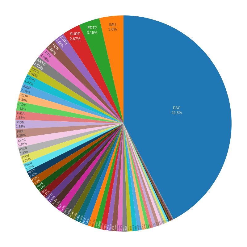

I’ve done a bit more digging.
The HardwareReport tool indicates that over 40% of the log file content is ESC telemetry.
Looking at the logs in APM Planner, it looks like ESC log records for all four ESCs are added at roughly 10 millisecond intervals. Aside from the timestamp, each ESC record has nine elements, four of which are always zero. Of the other elements, RPM & RawRPM seem redundant, Err (%) is typically 0, and Temp R is slow moving. That’s sparse data at a high rate.
I’m using DShot300 and have SERVO_DSHOT_ESC set for BlueJay+EDT. Setting SERVO_DSHOT_ESC for BlueJay (without EDT) disables RPM logging per motor, which I think is the most useful of the ESC metrics. Is there a way to reduce the ESC data logging significantly whilst retaining the useful data at a sensible rate?
ESCs are only filtered by LOG_BLK_RATEMAX (when logging to flash) and LOG_FILE_RATEMAX (when logging to SD cards). On machines with 8Mb of flash I have these set to 5 or 10, depending on the craft, and this actually helps. With the value of 5, I believe about 15 minutes of logs are possible (the most recent flight of 500 seconds took just above 4 megs).
This is I believe a bit less than what is tested on a regular basis, and occasionally some entry descriptors appear to get logged in a way some GCSs do not expect, but generally it works.
That said, I use these sparse logs mainly for battery discharge tracking and debugging occasional in-flight issues that are big enough to manifest at 5Hz logging. They may not show you particular problems with tuning, for instance, if that problem requires a high logging rate, so whenever I evaluate tunings, I perform short flights with ratemax back at zero.

I’ve re-tested with LOG_BLK_RATEMAX,5 and the log files from todays flights were all under 5MB. The ESC portion of the logs is now down around 7.5%. The longest flight time was 6m35s.
It’d be preferable to have higher resolution log data, but I estimate that with LOG_BLK_RATEMAX,10 the dataflash would be filled in a fraction over six minutes, which tallies with my previous experience of logging failures during gentle full flights.
