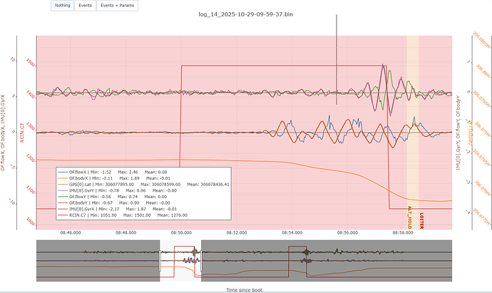

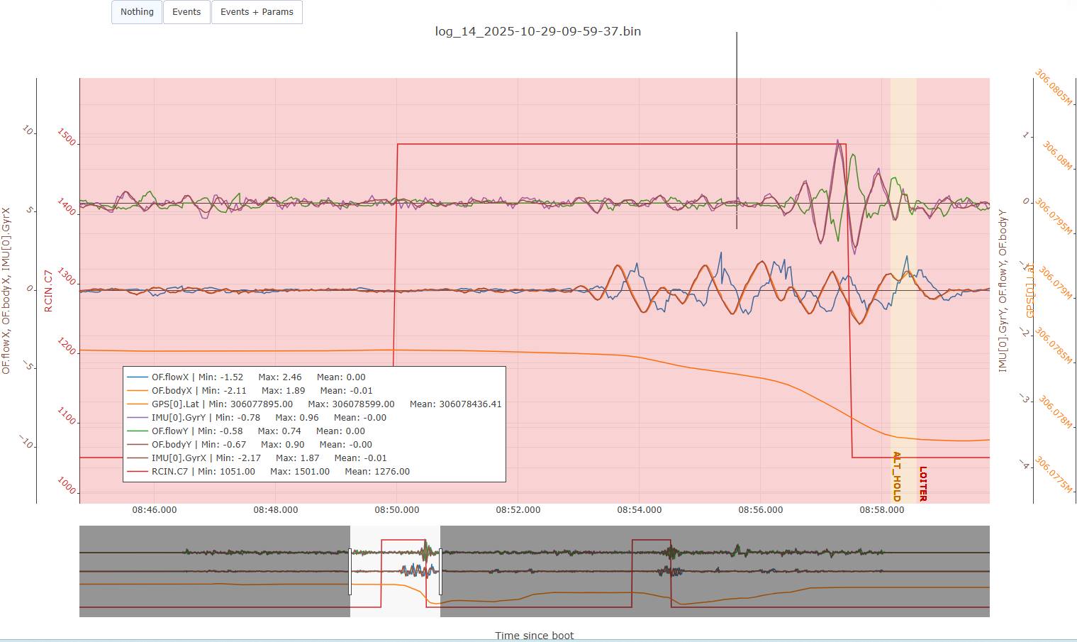

Any idea why it is oscillating with increasing amplitude like this?
This plot shows flowX being a little smaller in amplitude than bodyX, but I adjusted it in a later log to match much more closely and it is still unstable.

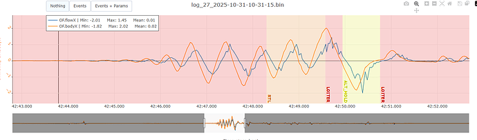

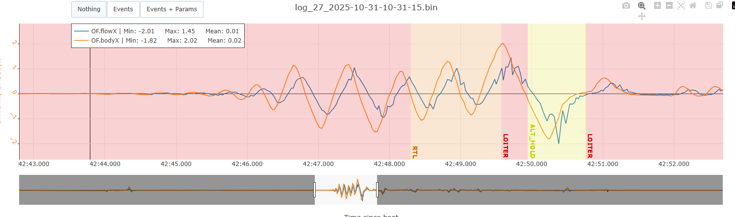

Ok so more on the latency, plus another question on FXSCALAR…
Latency: I have probed the living daylights out of my script, and I’m confident that the time from image capture to pymavlink mavutil’s master.mav.optical_flow_send() is roughly 60ms.
I connected directly to a serial port, and it’s still 230ms latency. I saw it go down to 120ms but I think that was a fluke. The average is definitely 230-250ms. Interestingly, this is no quicker than going through mavlink-router TCP or UDP connections.
I wondered if it was a timestamping issue, so I tried to use TIMESYNC, but Ardupilot won’t respond to timesync_send(time.time*1e6, 0) so I can’t sync it.
Any advice here?
Now for FXSCALER: I intentionally doubled the values before sending them over mavlink, then did an in-flight calibration. The calibration was successful (althoguh with a fit of 0.3…) and reported an FYSCALER of -503, so smack bang on. And after the calibration, the log shows good matching of amplitude (still with a massive phase lag and hance useless navigation), but the FXSCALER and FYSCALER parameters remained at 0, and the next flight, the amplitude of OF.flowX had reverted to double the amplitude of OF.bodyX. Did I miss a step to make the calibration persistent?

@randyV I got the latency down to 130ms. Still seems high, but at least it matches up with EK3_FLOW_DELAY = 127. But my vehicle still oscillates in attitude with increasing amplitude when I switch to optical flow. So maybe the delay wasn’t the problem. Do you have any idea why it would be doing this? FlowX and BodyX match up, as do FlowY and BodyY, so I know the orientation and scale are correct. I’m using a hard-mounted nadir camera, btw, sending OF pixel values.
