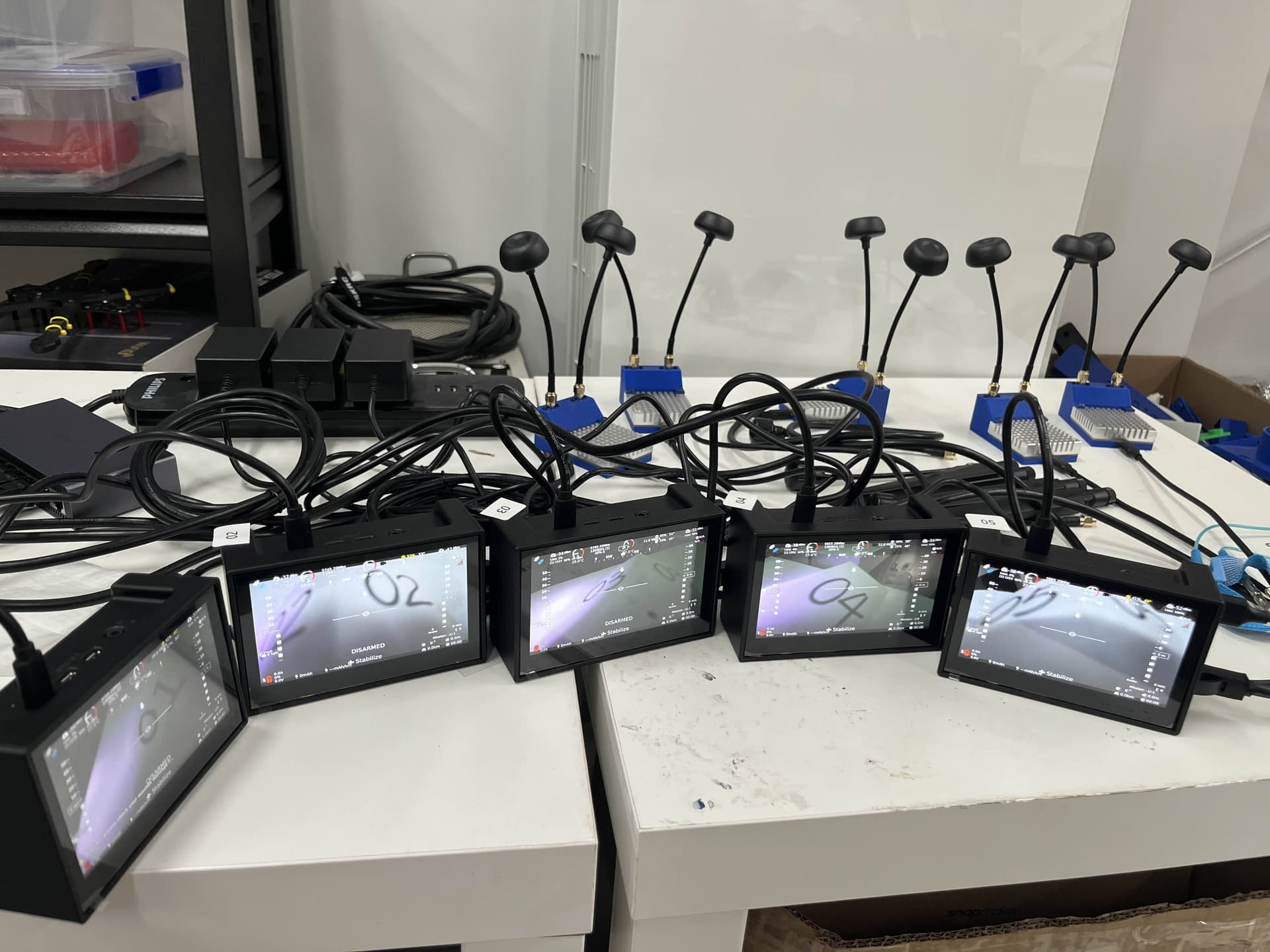

here is a post to share the progress of setup 5 pairs OPENHD both video and mavlink telemetry in same LAN
Hardware Prepare

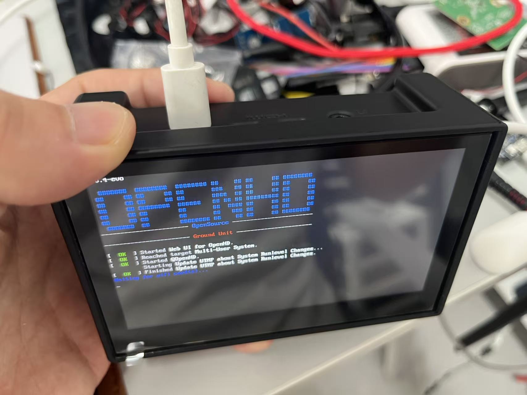

  1. OPENDHD Ground (RPI 4B with a 4.3 inch screen, RTL8812eu as RF adapter, screen is not necessary here, but helpful for debugging, need proper heatsink, use simple custom PCB here)

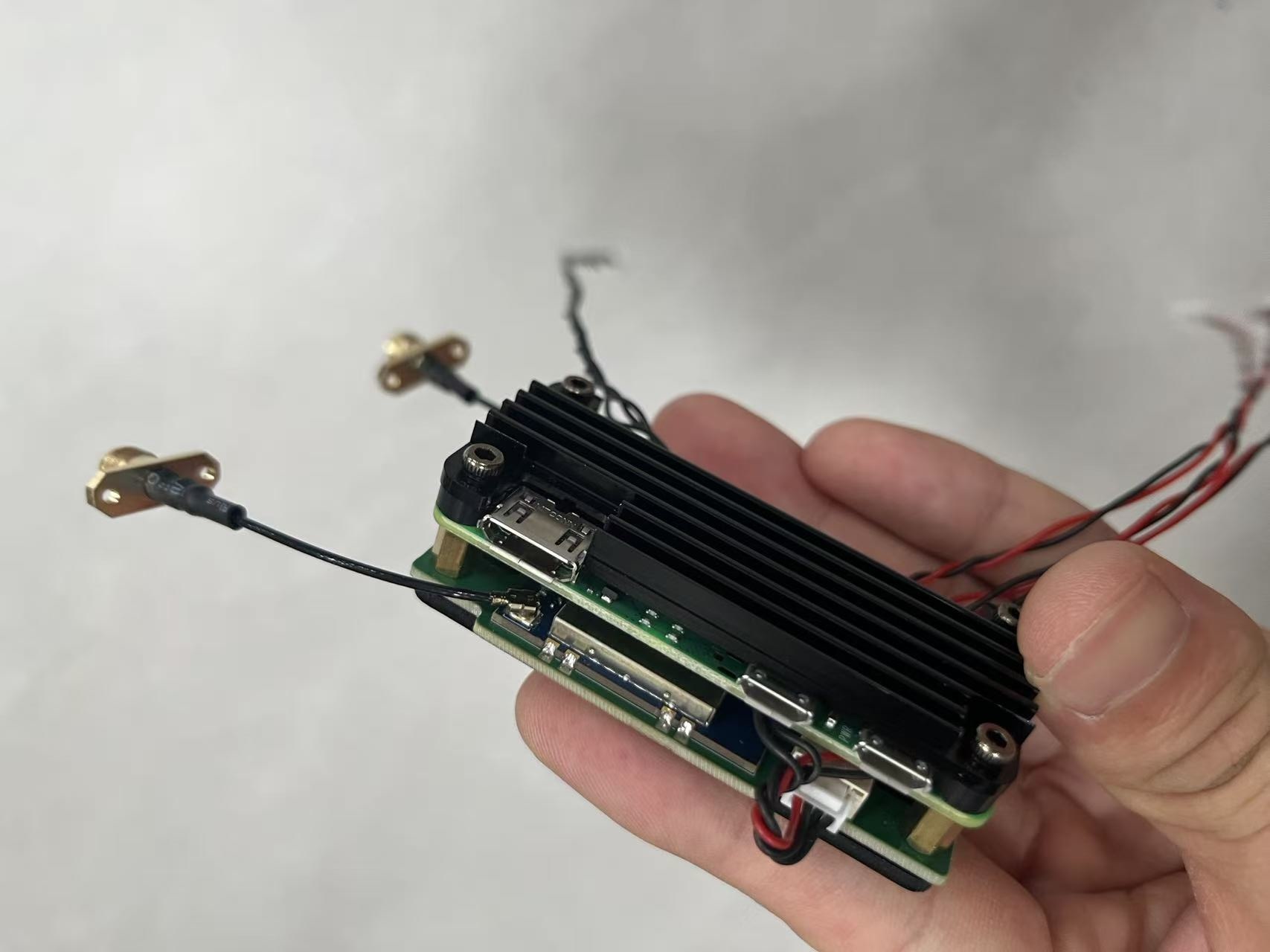

  2. OPENHD Air(Pi zero 2W + RPI camera V3, RTL8812eu as RF adapter, need proper heatsink,use simple custom PCB here)
  3. 8 port 1 Gbps Switch and cables
  4. 5 group of ArduCopter setup(with SYSID from 1 to 5, Telem port connect to OPENHD air with mavlink protocol)
*RTL8812eu module doesn’t have FCC and CE certification

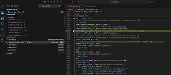

OPENHD development setup

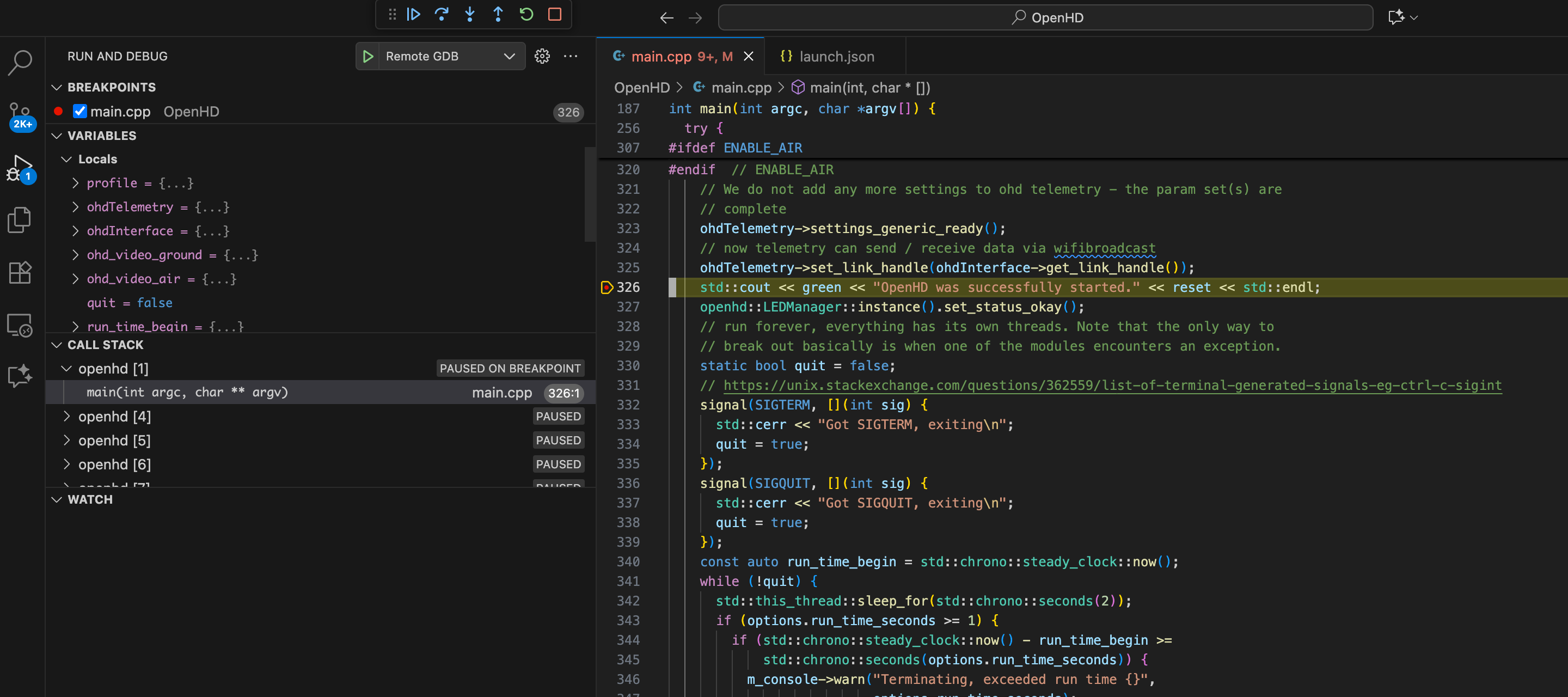

  1. use a x86 ubuntu 22.04 mini PC( security boot disabled on bios), not recommand to use your currently working ubuntu, I will use a plain new system here, I am mac user anyway
  2. OpenHD has dep install script, so it’s quite easy to setup the build env, I will still coding on my mac and run gdbserver on ubuntu, so I can set breakpoints on my mac vscode

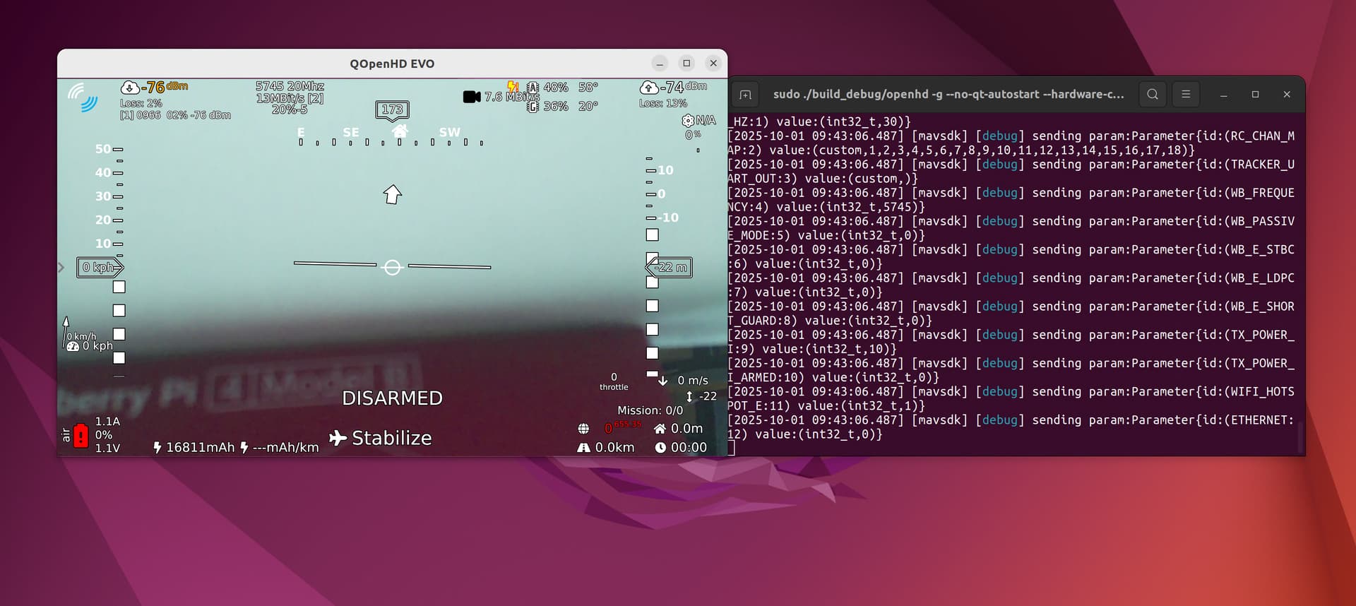

  3. QOPENHD can be easliy install using apt install (pretty awesome), change RDP port in the gui for video display

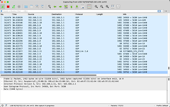

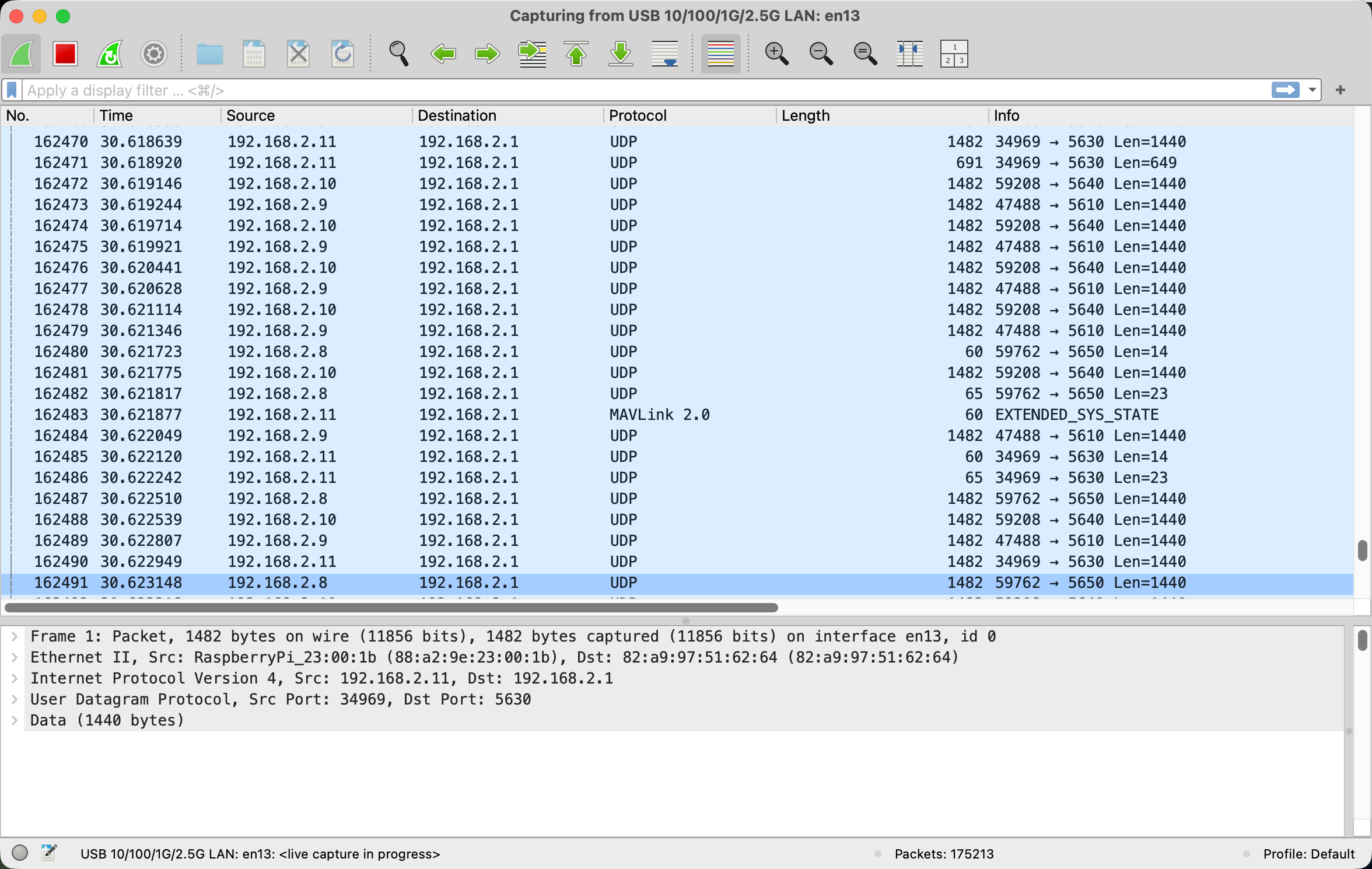

    4.Wireshark with mavlink lua plugin to debugging network layer
After success add the port configure feature, compile it again in RPI platform and add below params inside /boot/openhd/hardware.config
NW_FORWARDING_VIDEO_PORT = 5600
NW_FORWARDING_TELEMETRY_PORT = 14550

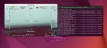

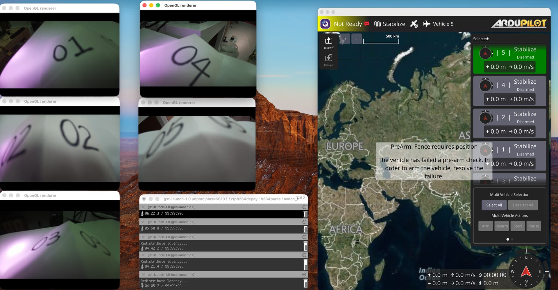

5 ground and 1 PC will both connected to the same switch, I use my mac here and setup network share, so it will be 192.168.2.1 and also provide a dhcp server, all ground will screaming to 192.168.2.1, OPENHD ground need to setup Ethernet to “FORWARD + INTERNET”, using 5 gst-launch to display the video and qgc to connect the mavlink UDP, it works!
gst-launch-1.0 udpsrc port=5610 ! application/x-rtp,media=video,clock-rate=90000,encoding-name=H264 ! rtph264depay ! h264parse ! avdec_h264 ! videoconvert ! autovideosink sync=false

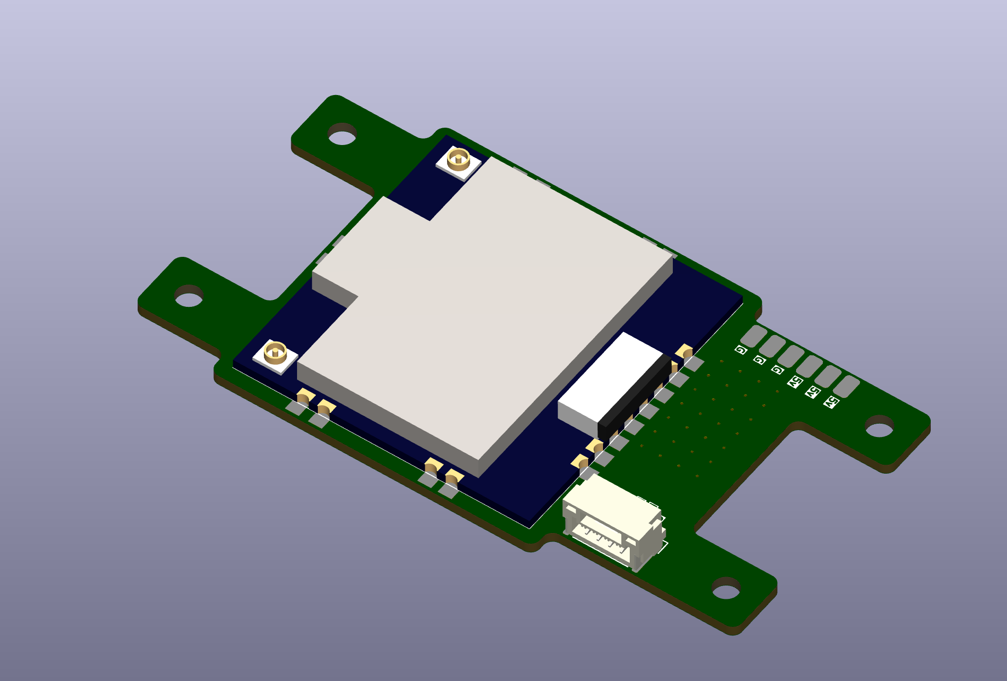

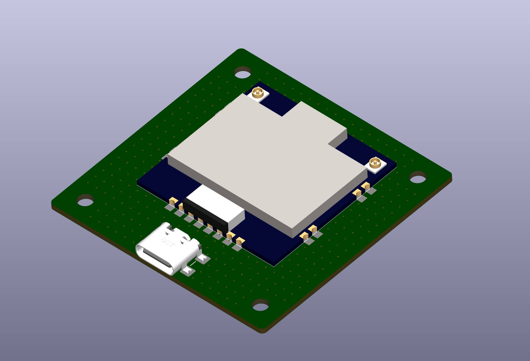

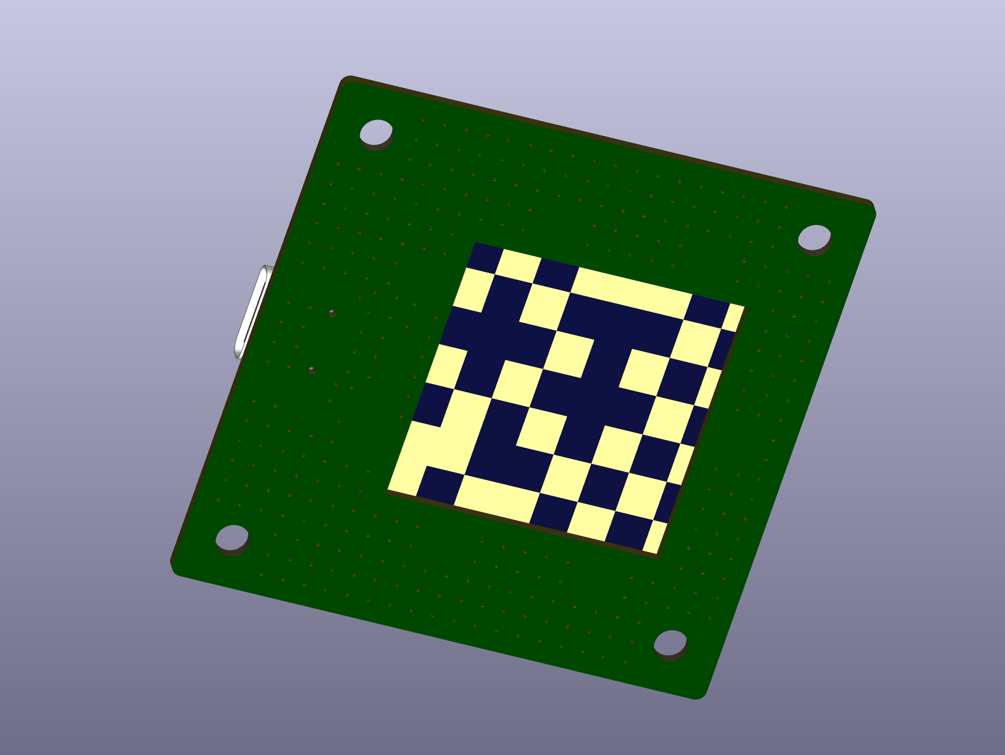

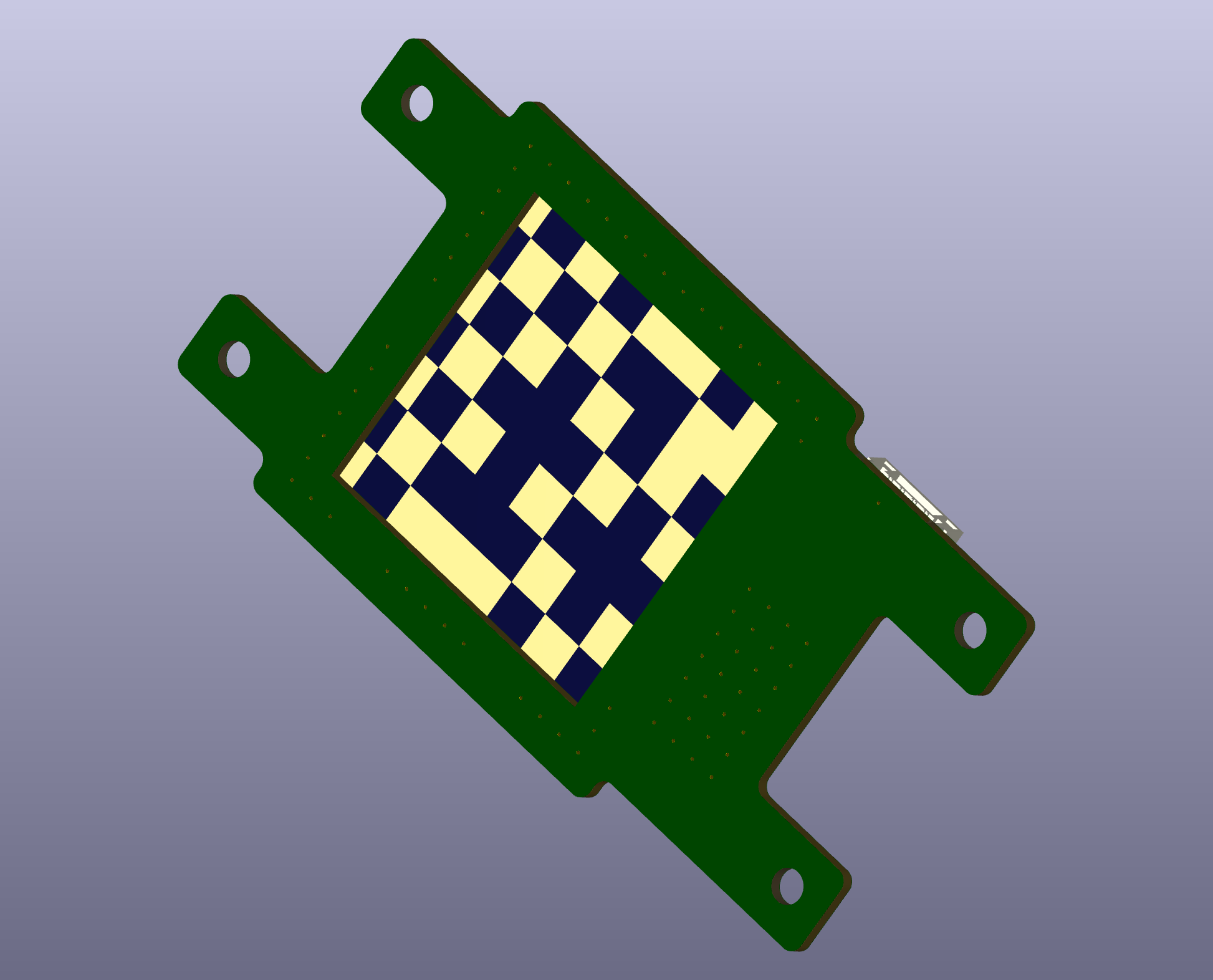

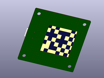

I made my own PCB base board to solder it on and make it easy to mount the heatsink and wiring
Is the PCB open source? I think this would make live lot easier to integrate it into actual drones.

it’s just an empty pinout board to hold the module and heatsink
this is how the PCB looks like, if necessary I can share the KiCAD project, but just very simple PCB,air side shape to fit a pi zero stack, you don’t even need them if you can wire and install the module properly
Could you share a link to the project? I would like to replicate your solution
