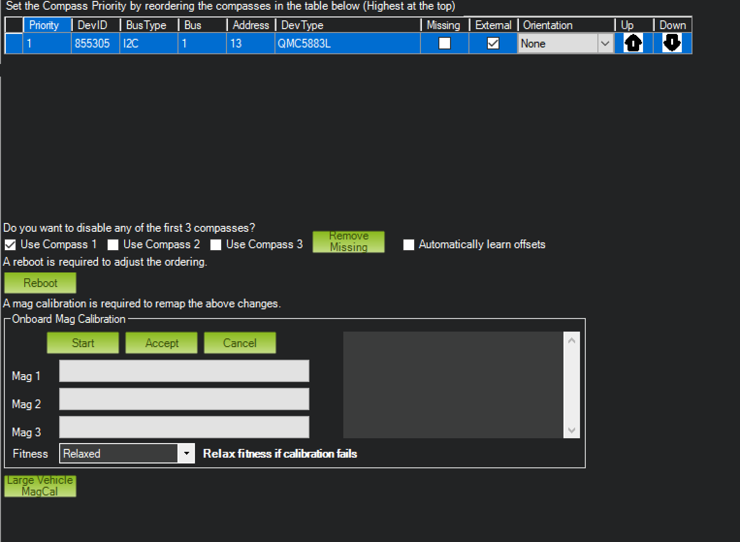

Hi thank you for the hint. I moved the FC and GPS outdoors to get a GPS fix. Despite having a GPS 3D fix the calibration is not working. Below is a screenshot of the calibration page I see.
To clarify: What does not work when you click on “Start” and rotate the aircraft in different positions around the spatial axes?
The green status bar does not show up at all when rotating the aircraft. No progress is shown.

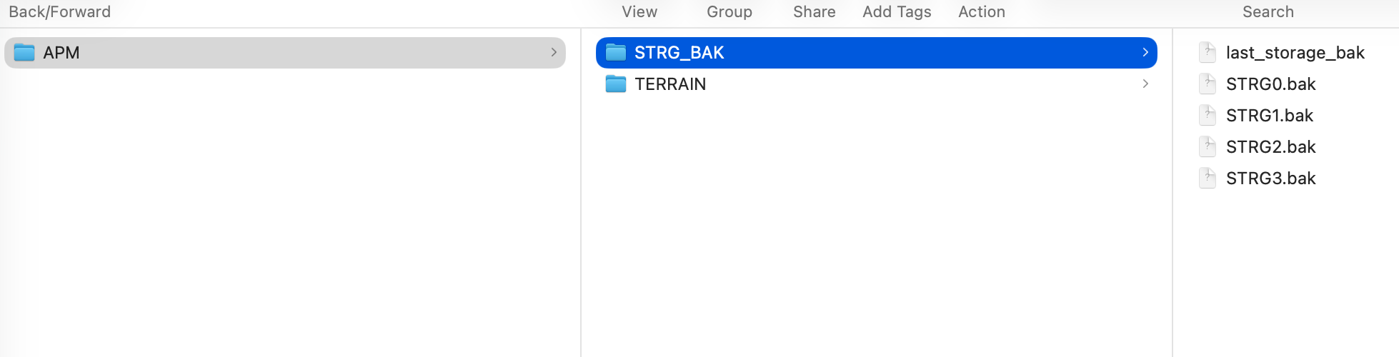

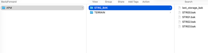

Let me give you some more detail that may be related. After not being able to perform the onboard mag calibration I did the large vehicle calibration. Then I proceeded to fly the plane wanting to collect the data on a micro SD Card (holybro Kakute H7 and micro 10 GPS). The Kakute H7 has been flashed with the latest ardupilot plane firmware. After that I installed a custom .apj file in order to access the new blackbox function for FlightCoach (a flight analysis software). The data logged on the micro SD card was not complete. The LOGS folder was missing and hence I had no .BIN files either. I am sending you a picture of the APM folder. I attribute this problem to the fact that the compass has not been calibrated. But maybe this problem is related to the failed calibration issue. I am also going to upload the adj file if possible. Thank you very much for looking into this. I am about to leave for vacation but I will try to do these things before leaving.

The folder is created immediately, regardless of whether the compass is calibrated or not.
Either your SD card is corrupt, your custom.apj file is corrupt, or both. Initially, you mentioned a Matek H743 Slim, but now you’re talking about a Kakute H7.
I don’t know what to do with the .apj file. Where did you get it from, and has it been compiled for the correct flight controller?
If your firmware isn’t writing log files at all, I would recommend staying on the ground until the problem is solved. This sounds like more than just a compass calibration issue.

I see, so it sounds like nothing is working. That’s not very helpful in narrowing down the compass problem.
Ok, the Kakute should be able to write log files. So please provide a link to a log file (LOG_DISARMED set to 1).
If no log files are being written, please reinstall the original AP firmware and check again.
Are you sure you selected the correct Kakute in CustomBuildServer?
Is the connection to Mission Planner via USB or telemetry? An insufficient transfer rate can also cause the problem. To be on the safe side, I would then connect the FC with a USB cable.

I agree. I will do a new installation on the Kakute H7, skip the custom build and see if I can get the mag calibration working or at least a log file.
The connection to the Mac has been both via USB C cable and via the Holybro SIK 3 telemetry radio. Since the plane is large, I prefer to use the telemetry radio.

Thank you very much for your help. I think that the problem is solved with the Kakute H7 V 1.5. I only need to check if the data will be logged on a micro SD card.
The steps I did are as follows:
  1. I got different USBA to USBC cables (instead of using a USBC to USBC cable) to connect the FC to my Mac with Parallels. I tried one and it worked in the sense that it powered the FC and the attached GPS. This seems obvious, but it is not guaranteed with USBC to USBC cables – I still don’t know which type of USBC to USBC cable works in this application.
  2. I did a full chip erase and installed the latest stable ardupilot plane firmware with bl. using the STM32CubeProgrammer.
  3. I omitted the installation of a custom firmware.
  4. After the “accel calibration” the “onboard mag calibration” worked flawlessly. There was no GPS fix during the onboard mag calibration. Here I am not sure from a post above if I need a GPS fix before the onboard mag calibration or not.
The custom firmware mentioned in 3. may have been the culprit. There is a “blackbox” function on the custom firmware page of Ardupilot designed to simplify the log files for the FlightCoach application I mentioned above. I have to review again carefully the settings for this application. I wonder if I have accidentally impaired the ability to calibrate the magnetometer and to properly record log files by using this custom firmware.
