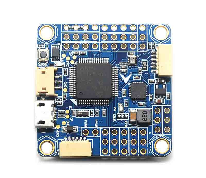

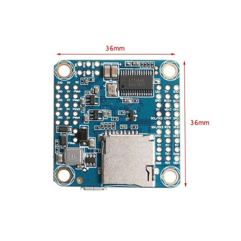

Another mystery “Omnibus F4 yada yada” board.
Is it this one
The Omnibus
:upside_down_face: Have a few of them lying around, this is the one.
