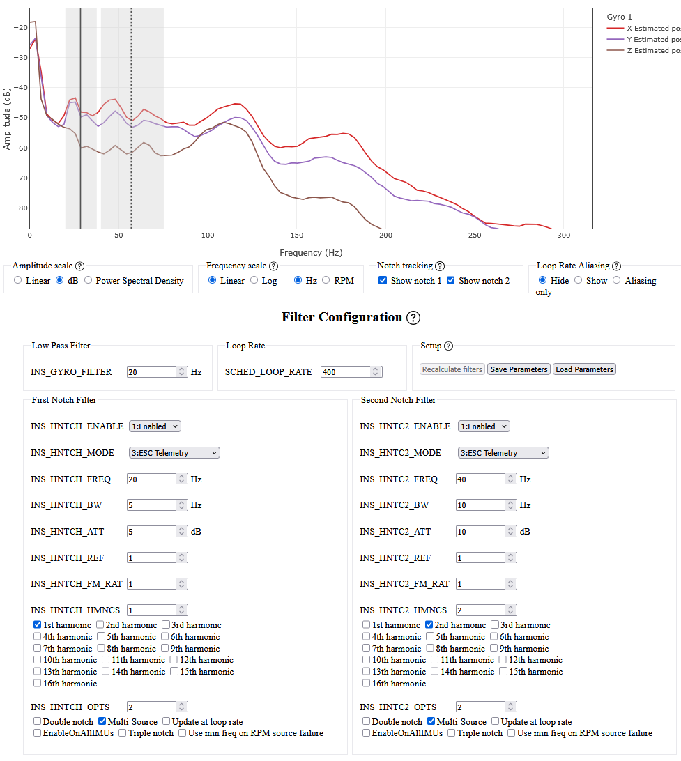

No Yaw bias now. Vibe levels are high.
The tune looks overfiltered which force you to use low PIDs that results in poor performance in wind or ever in just hover.
First you need wider logging
LOG_BITMASK, 180221 # fast instead of medium attitude logging
INS_LOG_BAT_OPT,4 # to log post filter noise
Running autotune after you improve filtering is an option, current P/D balance looks correct but PIDs are too low, in my opinion they need to be like 3 times bigger (0.2 P/I, 0.01 D), FLTT and FLTD is overfiltered, 10 is more relaxed.
2nd internal compass is not helpful, you can disable it.
The vibrations level is on high side, you will need review it after PIDs tune.
Filtering can be a bit tricky, fundamental frequency is much less powerful than 2nd harmonic but still need to be filtered, as an option you can use 2 dynamic notch filters with different attenuation to keep phase lag minimum, something like that:
INS_GYRO_FILTER,20
INS_HNTCH_FREQ,20
INS_HNTCH_BW,5
INS_HNTCH_ATT,5
INS_HNTCH_REF,1
INS_HNTCH_FM_RAT,1
INS_HNTCH_HMNCS,1
INS_HNTCH_OPTS,2
INS_HNTC2_FREQ,40
INS_HNTC2_BW,10
INS_HNTC2_ATT,10
INS_HNTC2_REF,1
INS_HNTC2_FM_RAT,1
INS_HNTC2_HMNCS,2
INS_HNTC2_OPTS,2
INS_HNTCH_ENABLE,1
INS_HNTCH_MODE,3
INS_HNTC2_ENABLE,1
INS_HNTC2_MODE,3
