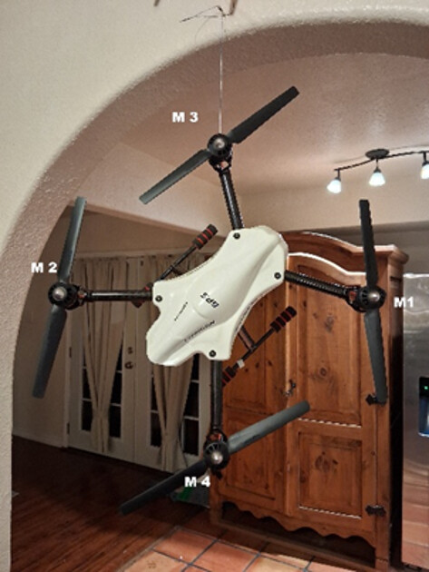

I have developed a unique and novel way of finding the center of mass of odd objects using accelerometers. It is a three-dimensional virtual plumb bob. It can find the center of mass inside of a three-dimensional object. The process is simple and uses statics. No motion is required.

The data is collected wirelessly using QGC.
The red and blue lines are virtual plumb lines. The light blue dot is the calculated Center of Mass.

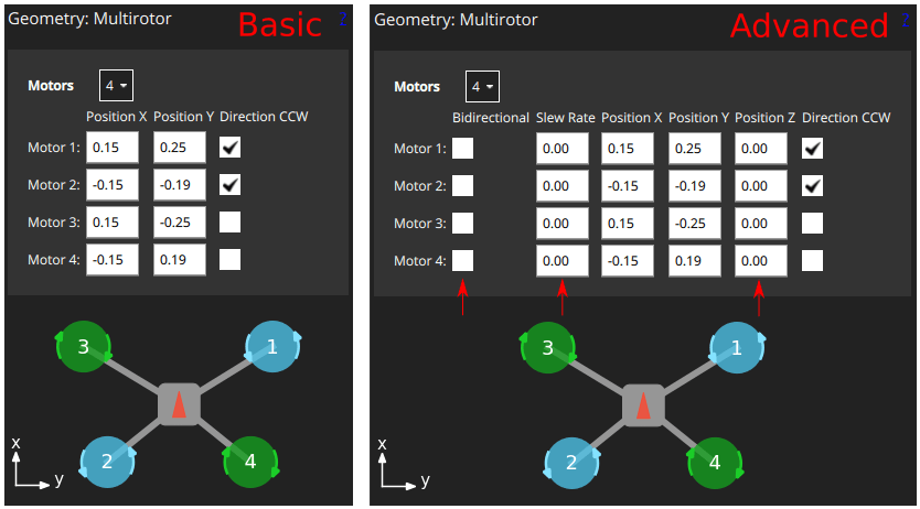

Thank you!!! I don’t think PX4 has that.
What about motor distance to the CoG?
PX4 Motor Position Coordinate System
Two dimensional representation front to back torque stationary flight.
PX4 Motor Geometry: Multicopter
Physically measured motor distance is never used directly in AP. The motor matrix assumes a geometry based on selected frame type and scales thrust accordingly.
AP asumes the CoG is at a known location?
For IMU measurements, it takes the direct offset into account, per linked documentation above. For thrust scaling, it assumes a symmetric geometry, and the control laws loop fast enough to compensate for lack of feed forward based on mass distribution.
(this may be overly simplified, but it’s enough information for you to understand what data is important to the parameter set for ArduPilot)
