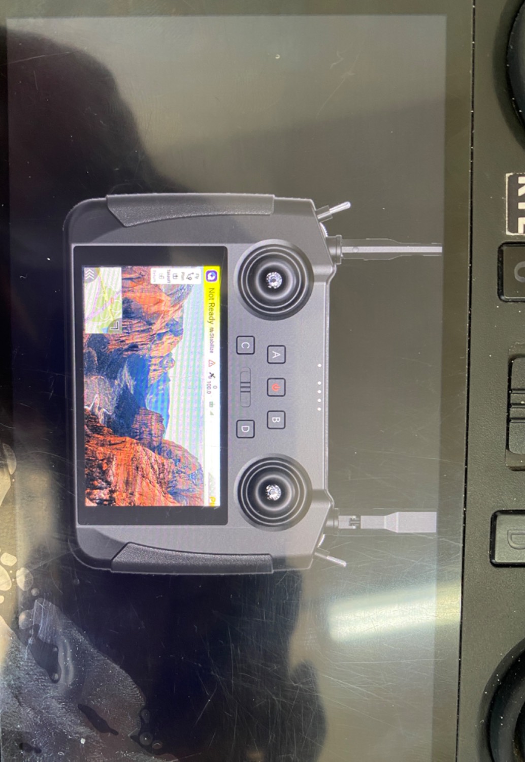

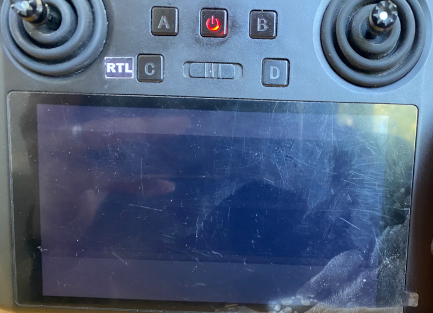

Hello erveryone!
I was using MK15, then the radio was suddenly reset, and the screen with the MK15 image was displayed on the radio (the RC connection was still working).
I updated the Android firmware using both of the files suplier provided many times (using the option “Erase All Before Download” and without it), but no change happened.
I also tested all these firmwares in this Google Drive link (MK32 MK15 Android Firmware Update - Google Drive) that are related to MK15 with the same results (just for firmware v2.0 and v3.0, black screen was displayed).
All these firmwares were written with a successful message.

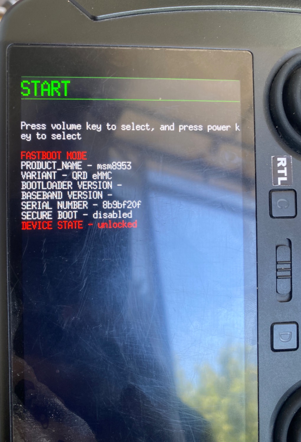

I also tried to use the “Read Data” and “Erase” options for some partitions, that is done successfully. I also tried the option “Erase Entire Flash”.
When I erase the system partition, the Fast Boot option with some information is displayed.
This is an image of flash information data:
Has anyone encountered a similar problem or have any suggestions for fixing this problem?
Hello! Considering that you have attempted multiple times to flash the Android firmware of MK15 but still cannot resolve the issue. Please contact your purchasing channel for technical support and after-sales service.
