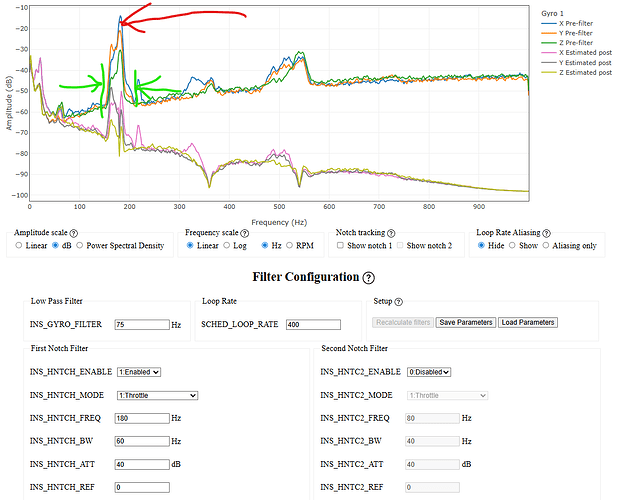

I followed (at least, I tried :smiley: ) the tuning process description, when I reached the part, where I have to configure harmonic notch filtering.
I made the necessary settings to the FC and went to the field for a test ā€œdriveā€. Unfortunatelly there was an issue with the GPS because I mounted a small action camera with a screw, about 20mm from the GPS. This caused some issues at the beginning of the flight. After a few seconds this normalized.
The drone hovered properly and I was able to record the necessary flight data, that was loaded into Filter review tool.
I’m a little bit uncertain at this point:
  • Shall I set the notch frequency to 180Hz?
  • The bandwidth should be the range, that is indicated with green arrows?
Flight log: https://drive.google.com/file/d/1M0c_kdtdgbQdKGmqUFb3doLZ52qXqG_5/view?usp=sharing
Thank you!
Set these parameters, make another flight and have another go at it:
INS_LOG_BAT_MASK,0
INS_RAW_LOG_OPT,9
You have Dhsot configured (should be Dshot600 probably) can you not use Bdshot with the ESC’s you have?

You have it right. Some flight Controllers have a specific Bdshot firmware, some are inclusive of Bdshot. Yours is the later. Good to go to configure for Bdshot and then use ESC RPM as the reference for the notch filter.

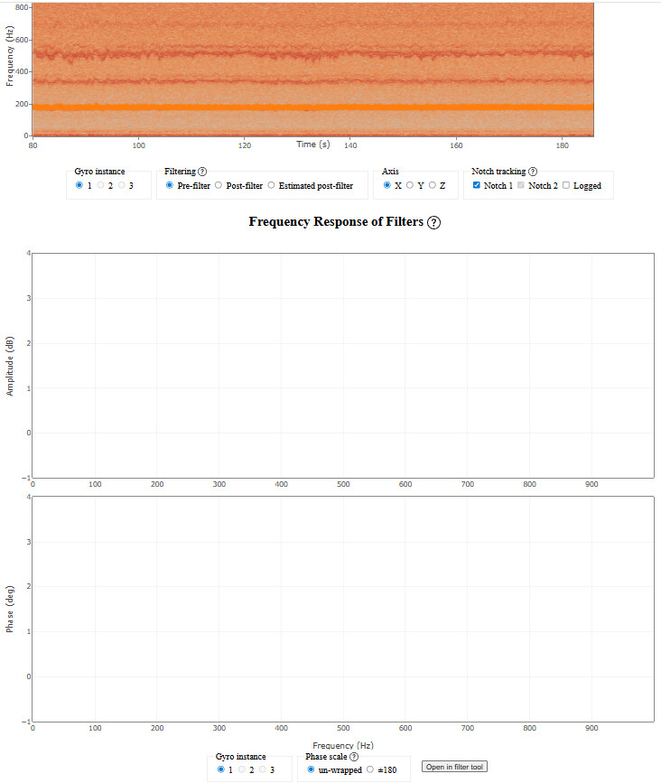

I did a hover-test today morning, but there was a little wind. I wanted to check the noth filter if I set it up correctly or do I need to adjust it a little bit.
I loaded the .bin into Filter Review tool, but whatever parameter I change, nothing changes on the chart.
.BIN file: https://drive.google.com/file/d/1XnYTkVmJnJQC-VW9RRSAfqytlRz4awtw/view?usp=sharing
Is there something to be enabled in the settings of filter review tool?
I tried in two different broswers: Chrome and Edge.
did you pressed ā€œrecalculate filtersā€?
Do not change the freq
change att to 30
disable 2nd and 3rd harmonic
Activate multi-source
And try again.

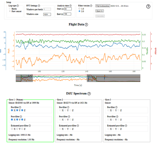

Yes, I was pressing recalculate filters each time, I change something on the settings.
This screenshot was made on my company computer, and still does not change anything.
Here’s the complete filter review tool screenshot. Maybe I’m missing something…
I have just checked the filter review tool with the log file, in my first post (https://drive.google.com/file/d/1M0c_kdtdgbQdKGmqUFb3doLZ52qXqG_5/view?usp=sharing)
With this flight log, the filter review tool works.
Is there some issue with my second flight’s log? Maybe it was windy during hovering and this made too noisy the signals for filter review webtool?
The parameter changes only have an effect in the ā€œEstimated post-filterā€ curves. Not in the ā€œPost-filterā€ curves.
Estimated post-filter curves are empty :frowning:
When I change to throttle based not filter, it seems to do something.
I have noticed, that my second flight log is made with raw sensor logging instead of batch mode.
I see the same issue on chrome. Might be worth putting in a bug report. I’ll dig a little more
I had chance to perform a test flight, just a hover.
I need to enable ā€œMulti Sourceā€ to be able to have updated the charts.
