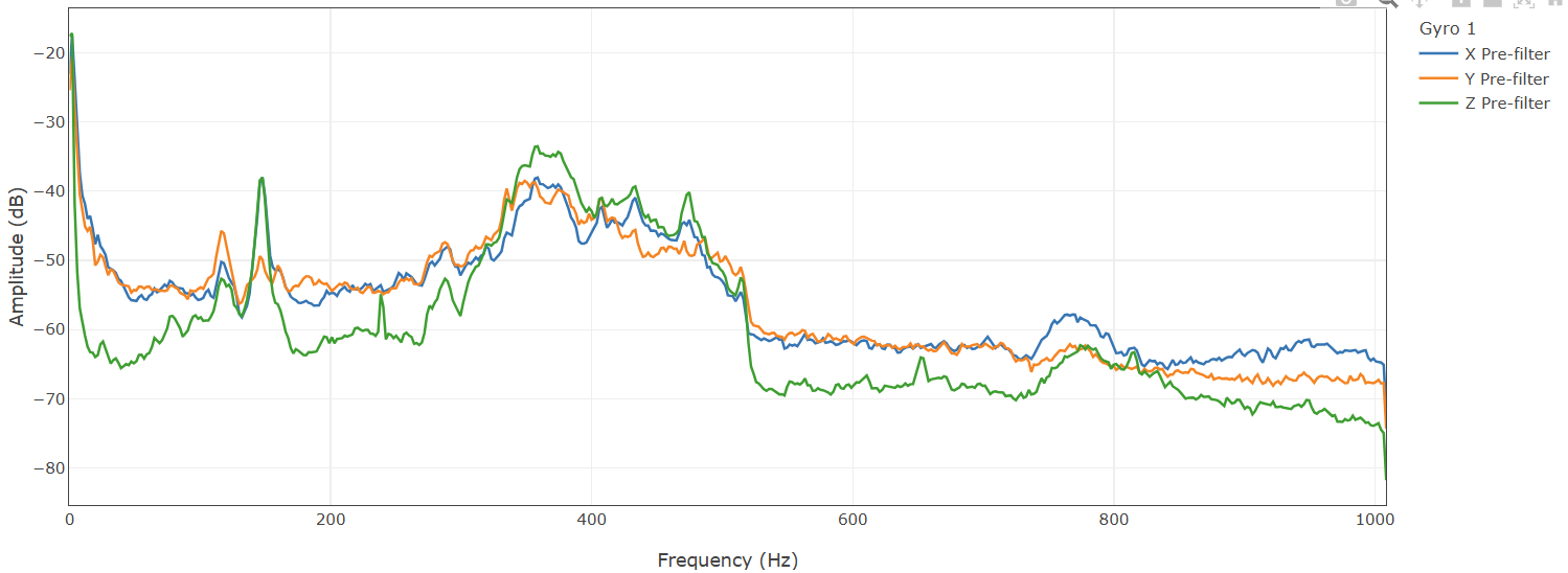

I am seeking some advice on the initial notch filtering setup (Step 19 of the Methodic Configurator) for a custom 4-EDF (70mm) build. I am following the AMC video tutorial and documentation carefully, but the high-frequency profile of this build is proving difficult to tune.

Given the 2100KV and 12-blade count, the primary noise frequency is sitting much higher than standard props. After following the AMC workflow to enable the notch, the vehicle experiences heavy high-frequency vibrations and significant RATE.Rout spikes.
I am attaching a screenshot of my pre-filter FFT. I suspect the current configuration is introducing excessive phase lag or failing to suppress the “whine” of the 12-blade fans effectively.
INS_GYRO_FILTER: With these specific ICM42688P sensors and high-RPM noise, should I be increasing this frequency to reduce phase lag, or is a lower value required to prevent aliasing?
Notch Configuration: Based on the attached FFT (showing peaks in the 300Hz+ range), do I need a wider INS_HNTCH_BW or a higher harmonic count to capture this 12-blade profile?
Geometry: Does the rectangular frame require an asymmetric approach to the notch harmonics to account for different noise levels on the Pitch vs. Roll axes?
Attached is the Methodic configurator zip file and here is the bin file of the log.

No, that looks OK.
No, but you do need to correct the nr of poles of your motor, that number is way off, and is the root of most your issues.
No.
High bade count is not an issue, wrong NR of motor poles is.
MOT_THST_EXPO= 0.1 looks very low. Are you sure you measured and calculated this correctly?
INS_HNTCH_ATT,-40 ← This is completely wrong, the number must be positive !!
The low thrust/weight is an issue. Previous attempts at using EDF’s have turned out poorly. Their inefficiency makes a great rapid battery discharger. And to @amilcarlucas point motor pole count is not fan blade count. It could be 12 I suppose but you need to confirm that.
I looked at the filter FFT and the nr of poles is definitely wrong!
ESC RPM telemetry is reporting incorrect RPM values because of this.
And the notch filters are tracking the incorrect frequencies because of this.

You just need to attenuate 10dB in order to get bellow -50dB post filleter.
So INS_HNTCH_ATT,10 should be enough. And I guess the correct Nr. poles is 16.
Okay, I’ll change the motor poles and proceed with the new test/ noise filtering. For the number of poles, I counted the number of permanent magnets (8) in the rotor since it’s a brushless outrunner motor.
