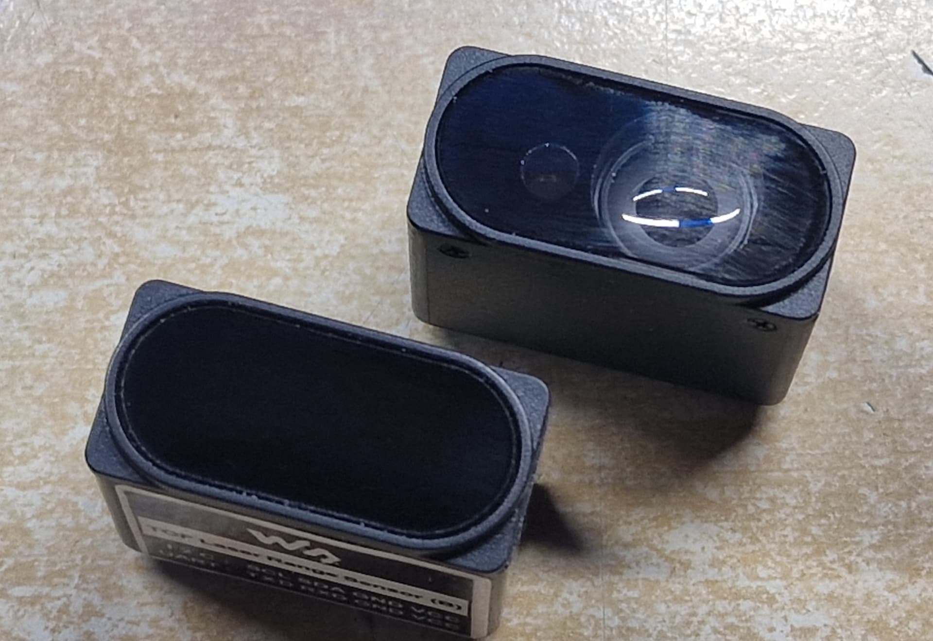

I have a TOFSense F2-P and F2-mini and so far I’m not impressed, has anyone managed to get these working?
Aside from their shoddy documentation and wacko (unlabelled) JST-GH connections, their configuration app “NAssistant” just crashes on me as soon as I try to configure the device over the serial port. I can see RX data flowing in over my TTL link, but as soon as I enable “Recognize” in their app it falls over.
Any thoughts would be much appreciated, including just dumping theses and getting something better!

I have TOFSense F2-P and it works great for me. No issues at all.
NAssistant is not perfest - there is “noChart” version and that one works OK.
Hmm ok, that’s good news at least, Can I ask what version of NAssistant you’re running? I have v4.1 and it just crashes on “recognize”.
Sorry, this no chart is for micoair.
For TOFSense I use TOFAssistant 4.4.0.4 or NAssistant 4.11.0
I think first on is for “clone” I bought some time ago from waveshare
BTW - “real life” usable range is about 30m over terrain (grass/dirt) with daylight, so 50m seems purely theoretical.
Adam you’re a legend, I hadn’t realised it was a generic item, and the Waveshare documentation is really good compared to Nooploop’s. I’ll definite buy from them instead if I need any more.
I’ve just compromised and left the F2-P on the default UART connection rather than I2C and got it working. Thanks for the heads up about the 30m usable, I’ve set that as the RNGFND1_MAX.
Thanks again,
