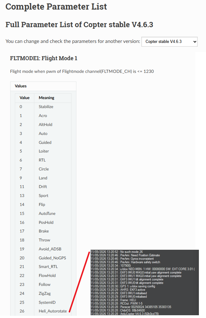

Trying on the bench TradHeli v4.6.3 on a Pixracer R15 flight mode 26 (Heli_Autorotate), having
H_RSC_AROT_ENBL=1
I get message No such mode 26, even with motors on (helicopter on my hand)
This mode appears documented in v4.6.3.
I suppose that having H_RSC_AROT_ENBL=1the program fits on PixRacer R15.
If I choose an absurdly big value for a fligh mode, it gets clamped to 127 and a very similar message appears:
image,
so apparently that flight mode is not possible, even documented.
What am I missing? Thanks.
Hi @Webillo ,
Flight mode heli_autorotate is only available in SITL for now.
While setting:
H_RSC_AROT_ENBL=1
allows you to perform manual autorotations with fast motor respool for power recovery.
Thanks: independent things. Explained here. I suppose on source:
// Autorotate - autonomous auto-rotation - helicopters only
#ifndef MODE_AUTOROTATE_ENABLED
#if CONFIG_HAL_BOARD == HAL_BOARD_SITL
#if FRAME_CONFIG == HELI_FRAME
# define MODE_AUTOROTATE_ENABLED 1
#endif
#else
# define MODE_AUTOROTATE_ENABLED 0
#endif
#else
#endif
#endif
I would add to Ferrucio’s explanation that automatic autorotation isn’t considered mature enough for field use. See Autonomous Autorotation — Copter documentation
