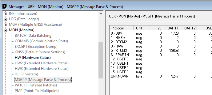

I did a little more digging and connected via U-center in USB to my Drone while the wifi link is active with the base station connected to the computer. In the MSGPP from the MONitor section (UBX) i see that protocol 5, RTCM3 increases with time on UART1.
But a problem I noticed is that altough the GPS receiver on the drone works fine for himself with the 3D fix, in the RTCM3 messages view 1005 RTK Base station is grayed out.
So no correction actually gets to the Drones F9P module.

This is good but there’s more to the story. There’s a section somewhere in there that tells you exactly which RTCM messages you’re receiving. There’s a status message that will go out no matter what, but there are also satellite correction messages unique to each satellite that you should also be expecting in order to fully calculate a solution. It will take me some time to reproduce the setup locally, but with that information you might be able to find it yourself.
Seeing the status message but no satellite messages can be reproduced by taking a working setup and covering the antenna for the base station or the moving baseline “base” receiver. You’ll see the individual correction messages drop off while seeing the status messages come through. An ESD bag will produce stronger results (the gray metallic ones, not the pink anti-static material), or usually removing the antenna and covering the cable with your hand, it should be a noticeable difference.
In the above case, even though RTCM status messages are being sent, the rover will not be able to calculate even an RTK Float solution.
Your base station is sending a lot of unnecessary drivel. If you’ve done any customization in u-Center, it was in error. Undo it.
Indeed it was a misconfiguration on u-center from the Drone GPS module. After a full reset everything is in order.
