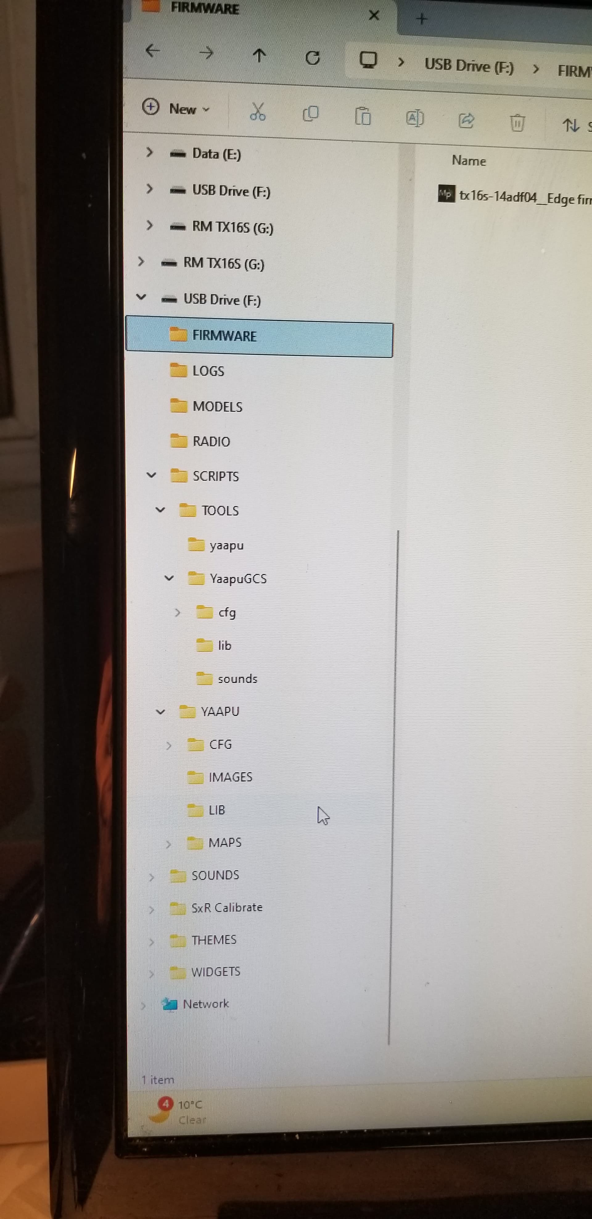

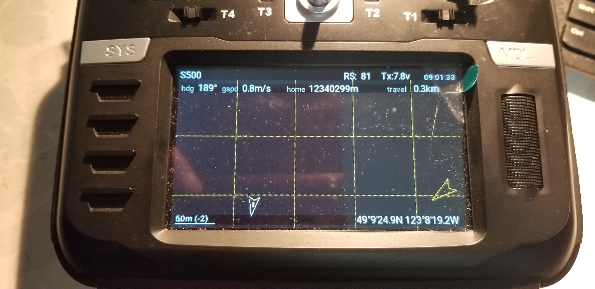

For Yaapu Map, all the folders (from Github) are on my Tx SD card. And the Sat tiles are resized to 100 x 100. See attached photo “No map display”.

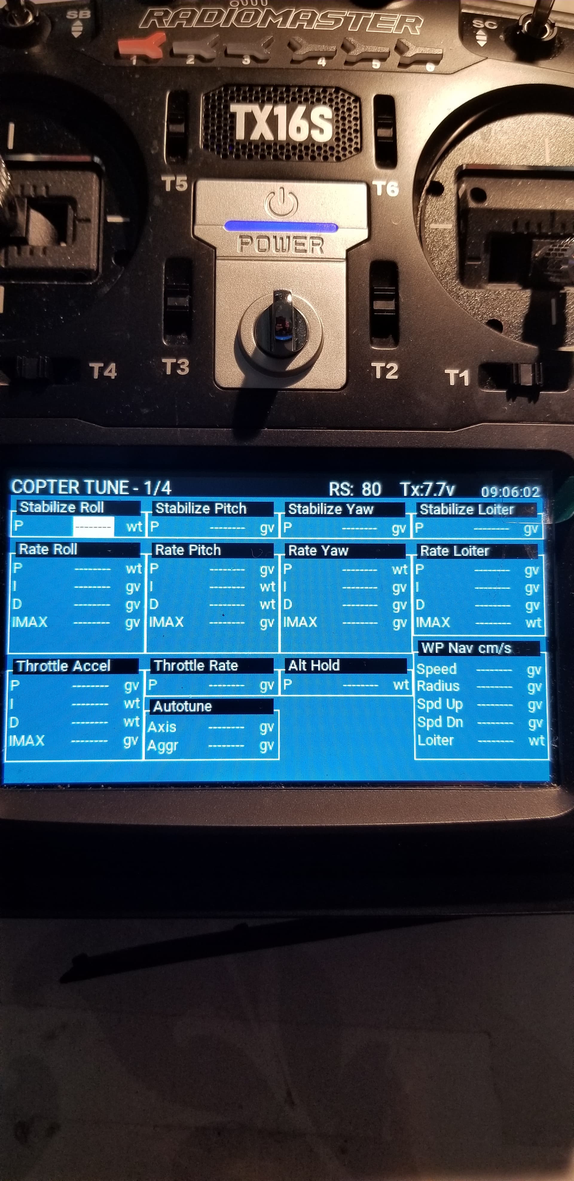

For Yaapu Lua GCS, I was successful to get Pixhawk data display on Yaapu Lua GCS in my Jumper T16 Tx before switching to the present Radio Master TX16S. See attached photo “No param values on Yaapu Lua GCS”.
File structure of SD card in Tx is also attached.

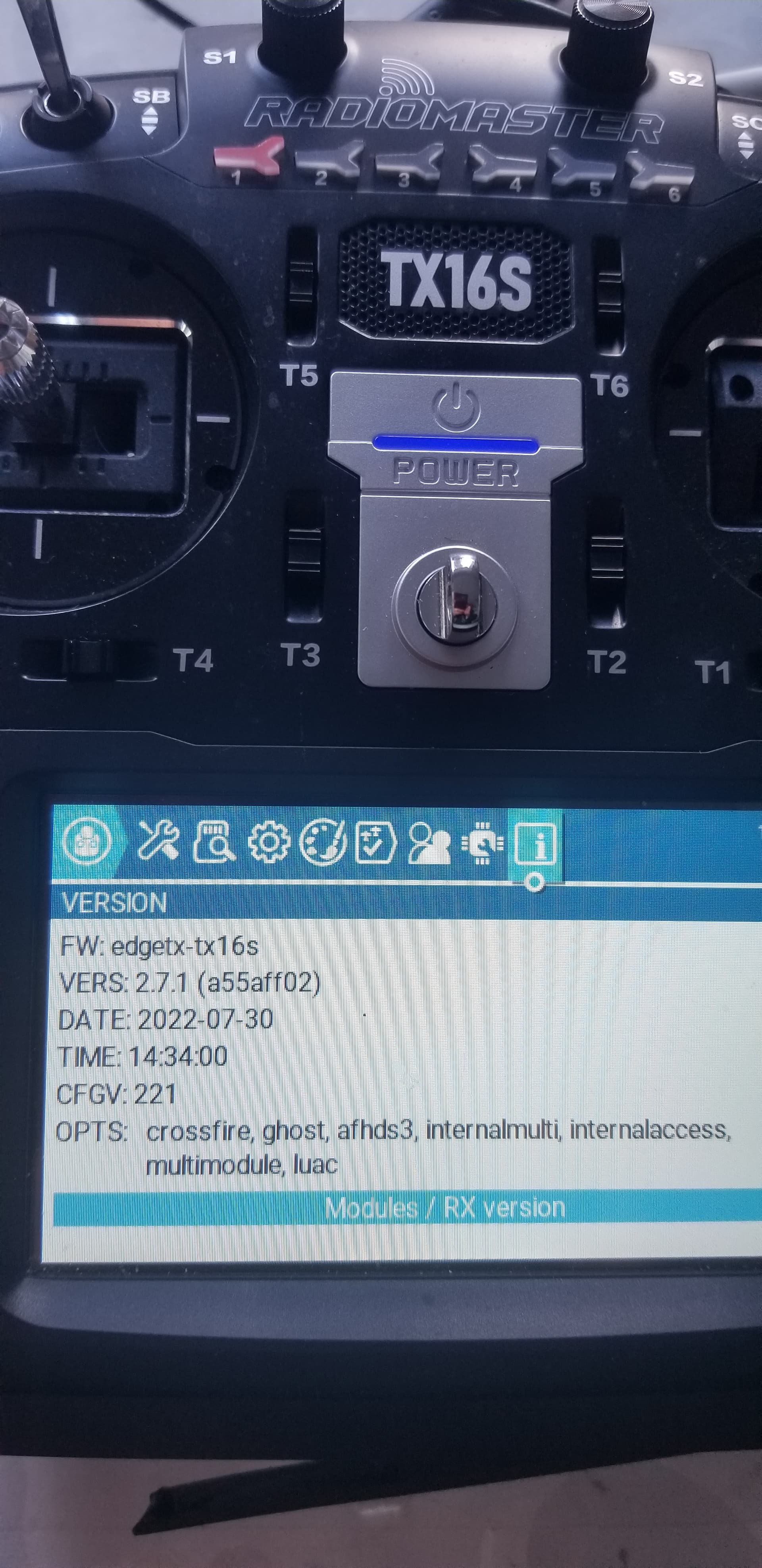

One thing very strange is : In Version page when press “SYS” button of Tx16S, lua c is shown. But in Build Options under Radio Profile of Companion, only lua is shown, but no lua c. See attached screen captures. Could this be the reason for values/data not displayed ?
Appreciate your help.
IIRC Yaapu’s GCS only supports the original FrSky gear.
I used the same Jumper R8 receiver (FrSky compatible) with my last Tx (jumper T16), i got all param values populated in the Yaapu Lus GCS.
After changing to Radio Master TX16s, i don’t have lua c displayed in the build option under radio profile in Companion.
At some point LUA ceased to be an option, it’s enabled by default.
So that’s not an issue.

For the map, GPS coordinates are shown so it’s getting the telemetry values, thus suggesting the issue is with the map file. The map file is location specific, so you need to make sure the map file you created contain your current location, and has enough resolution step files for you to zoom in or out. You might want to try zooming in or out of that map to see if maybe the files do not have the current zoom step you’re viewing at.
Correct me if I am wrong : You said if I want to display the map tiles say, at home, the map I downloaded to the SD card of my Tx should be the area around my home.
I think I downloaded the map in other area. The 3 levels are 0, -1 and -2 with a switch for zooming.
Wil try again see if it works.
