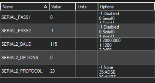

In the process of building an Ardurover with a Speedybee F4 FC and ER8 RM receiver. Radio and receiver are binding ok but I’m not able to do a radio calibration in mission planner. Radio calibration window in MP is greyed out. It seems like receiver is not properly assigned. I used the UART Port on the ER8 receiver as serial 2.

Radio Master ER8 has 8 channels and an extra serial/UART Port. I’m using the serial port as serial 2 in my build. ELRS documenatation said to do few more steps to get the receiver to work under the RC_options which is equivalent to bitmask 15136.

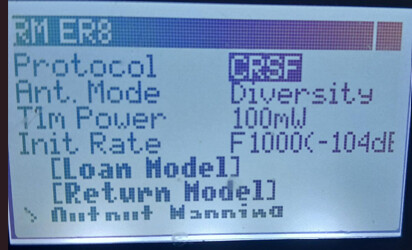

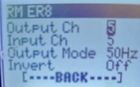

What settings do you have for those RM receivers set up in the ELRS lua script? Can you post a screen shot of those settings just for some ideas?
I’m not 100% sure, but it looks to me like it’s still in PWM mode. The RM website said those serial ports are only for sensor inputs.
