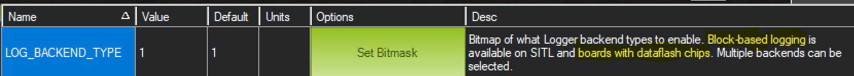

Hi there,
after an update from 4.6.3 to 4.7.1 the data logger isn’t working anymore. It’s yelling
Config error: Unknown logger backend
I’ve been using the same config as before with 4.6.3 where it was working. The FC has flash chip for logging, no SD card. The config
LOG_BACKEND_TYPE is set “block” which should be correct according to the description or am I getting something wrong?
It’s a Matek H7A3 FC.
Thanks Rüdiger
H7A3 have filesystem emulation via littlefs, so for ardupilot it looks like SD card. LOG_BACKEND_TYPE, 1 need to be set
Thanks Mike! :+1:
“File” needs to be set. Seems I was misled by the decription in MP:
