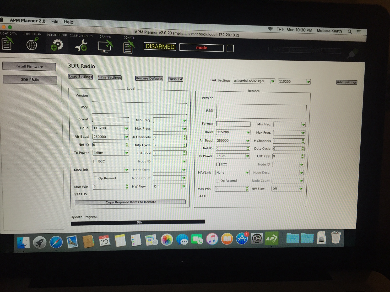

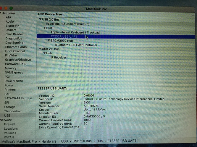

I can get it to connect with the cable between the flight controller and the laptop and I can arm it manually letting my radio gear control it but it automatically disarms after 20 seconds. Also when I plug the usb dongle in I can get it to connect to the usb but then it will not talk to the flight controller at all. I saw it all working perfect on the guys computer but can not get it to work on mine

In your GCS have you selected the correct port to connect to?
Have selected the correct rate (5600) to connect at?
Then when you click connect what message do you receive?

Yeah I am powering up the copter with a battery, I have not connected my radio to my laptop but when I connected my copter to my laptop I was able to configure my radio and see the values change when I moved the sticks on the screen.
I can get the usb to connect in apm planner 2.0 but nothing shows in the initial setup tab for any of the settings to change etc.

First image : Baud rate - 57600 - not the 115200 as that is what you can use over USB direct connection but the radio modems are slower.
That should be all you need to do - hit connect and done, unless you mucked around with the radio modem configuration on the copter.
