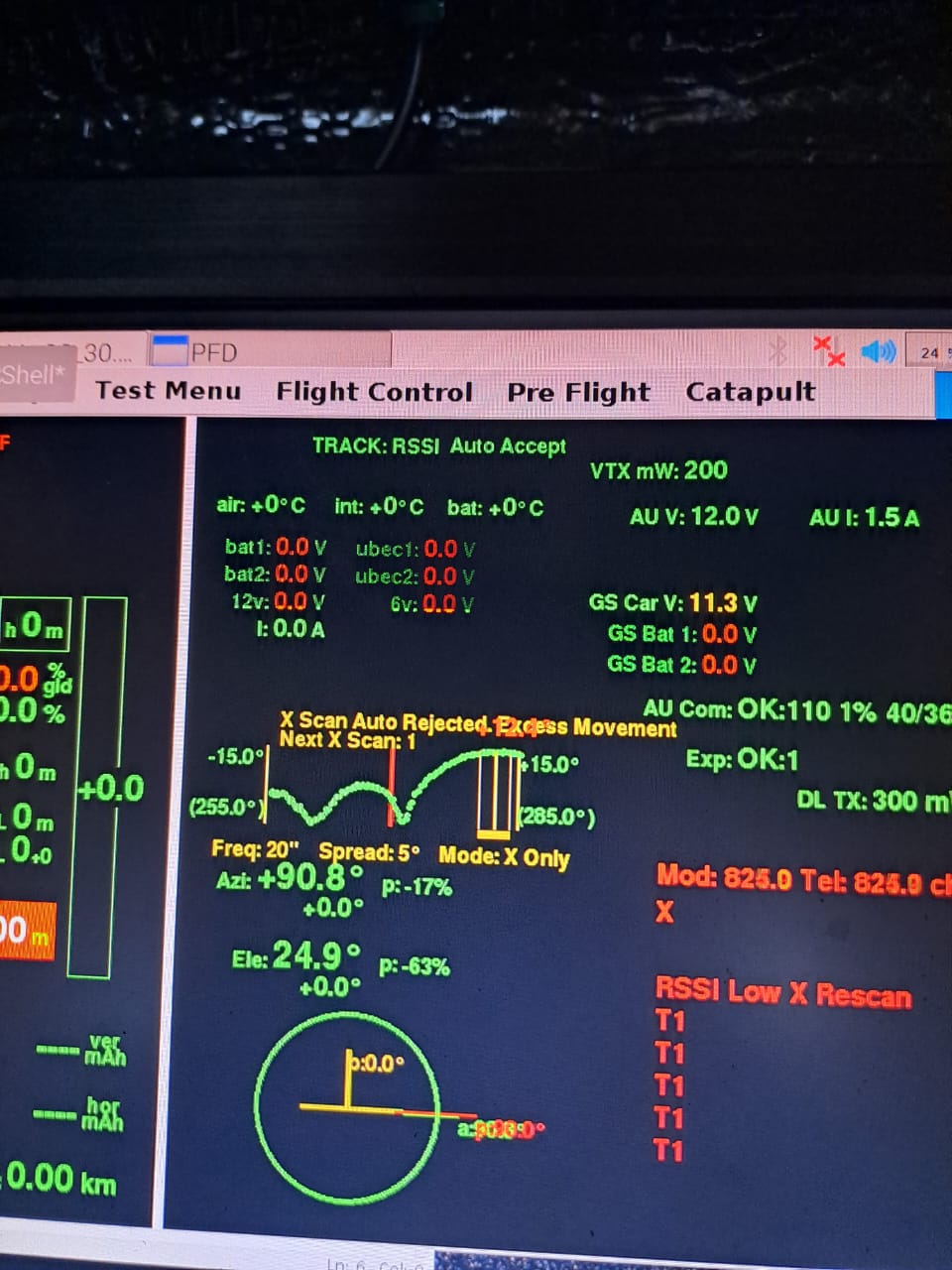

The experience I had with narrow beam trackers I have used before (30 dbi/5.8 ghz) was that in addition to simply following the plane using the GPS position, you always had to correct for the best reception using RSSI scans. So you would roughly setup the antenna for plane GPS position, then get the sweetspot using RSSI scan, and then you continue tracking using GPS, but still from time to time doing an RSSI scan. I believe I was able to get close to 1 degree pointing.
I also did a tracker mode for following planes without GPS data, i.e. the tracker would scan both elevation and azimut, and it also worked fine for intermediate distances.
Now, the 17 dbi antenna is much more lax, so that the autoscan feature may not be necessary, and one could just use GPS position of the main copter…
As far as controlling the Relay copter, I have several ideas, but it is not as simple as let it take some intermediate position. Depending on geography, you would have to take it to the correct spot, if you want to fly for instance beyond the ridge, you would want the relay copter be just above the ridge.
I think that the best way is to fly tandem, i.e. the relay copter follows the main copter closely and autonomously, maybe using guided mode, where the coordinates are sent from the main copter continuously to the relay copter. Once we reach the spot where the relay copter will stay, a button press would revert it to something like Loiter Mode where it will simply hang around and work like an antenna tripod…
Examples of autoscan RSSI: first one shows multilobes when the scan is wide, and the program rejects automatic decision, leaving the operator to decide, second one is a more typical and simple to get automatic decision for the best angle correction.

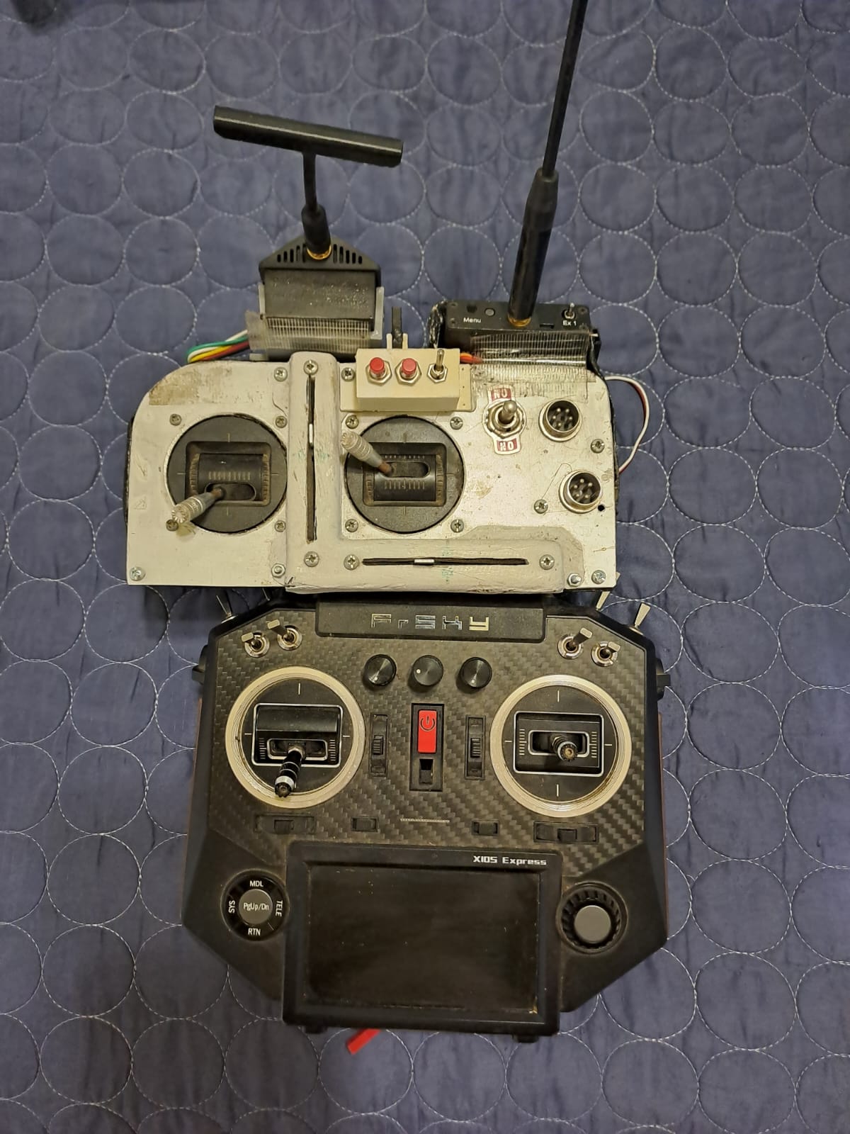

I have been thinking about the RC control structure, and also about the telemetry for the system.
Implementing the RC seems not to be too complicated, what I have to do is use one set of TX and RX which goes on the Relay copter, and another set of TX on the Relay copter, and the final RX on the Main Copter. It is quite obvious that it is preferable to have different frequencies so as not to cause range reduction due to a powerful transmitter being close to a RX, so the natural thing would be to use 2.4 Ghz for the GS – Relay copter, and 900 Mhz for Relay to Main Copter. So far my experience with express LRS was that even with 2.4 Ghz there are no range issues, it goes pretty much to 20 km with standard equipment and antennas, and if needed, a Moxon or even small Yagi on the GS TX would almost double the range, so the reason for using 900 Mhz is purely for separating frequencies. I do not have a second 2.4 GHz transmitter to test out the potential interference (maybe I am just worrying about something it is not there).
One big problem is how to control two copters using just one RC Radio. I have a radio with additional sticks which I made for controlling two pan and tilt cameras for fixed wing, but they obviously can be used for controlling another copter. The way it works is that there is an arduino nano which reads using adc the stick positions, and also two sliders which were used as trims for pitch and roll for fixed wing, and then sends these in PPM stream into trainer jack of the main radio.
LRS has one option where 16 full channels can be used, and I am inclining for using these 16 channels for controlling the two copters. That is, there would be one transmitter which sends all the 16 channels, and there would be two receivers, one on the relay copter, which would use about 7 channels, and the other on the main copter, which would use 9 channels. The main copter will receive the channels through the 900 MHz link.
