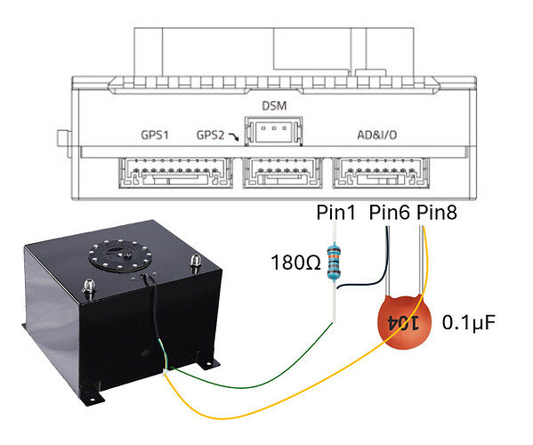

Final fuel sender design:
Here is a simple, one-line schematic that includes the 0-90 ohm fuel sender connected to the Pixhawk RPi CM4 Baseboard with a noise filter capacitor and voltage divider:
Simplified One-Line Schematic with Noise Filter
    +5V (Power Supply)
   [180Ω]  <-- Fixed Resistor
      +-------> ADC1_3V3 (Analog Input on Pixhawk)
   [Fuel Sender]  [0.1µF] <-- Noise Filter Capacitor
    [GND]      [GND]
Description:
  1. Fixed Resistor (180Ω): Connect one end to the 5V power supply, the other end to both the Pixhawk analog input and one side of the fuel sender.
  2. Fuel Sender (0-90 Ohms): Connect one end to the fixed resistor junction (and the Pixhawk input), and the other end to ground.
  3. Noise Filter Capacitor (0.1µF): Place between the analog input pin (ADC1_3V3) and ground to reduce noise in the signal.

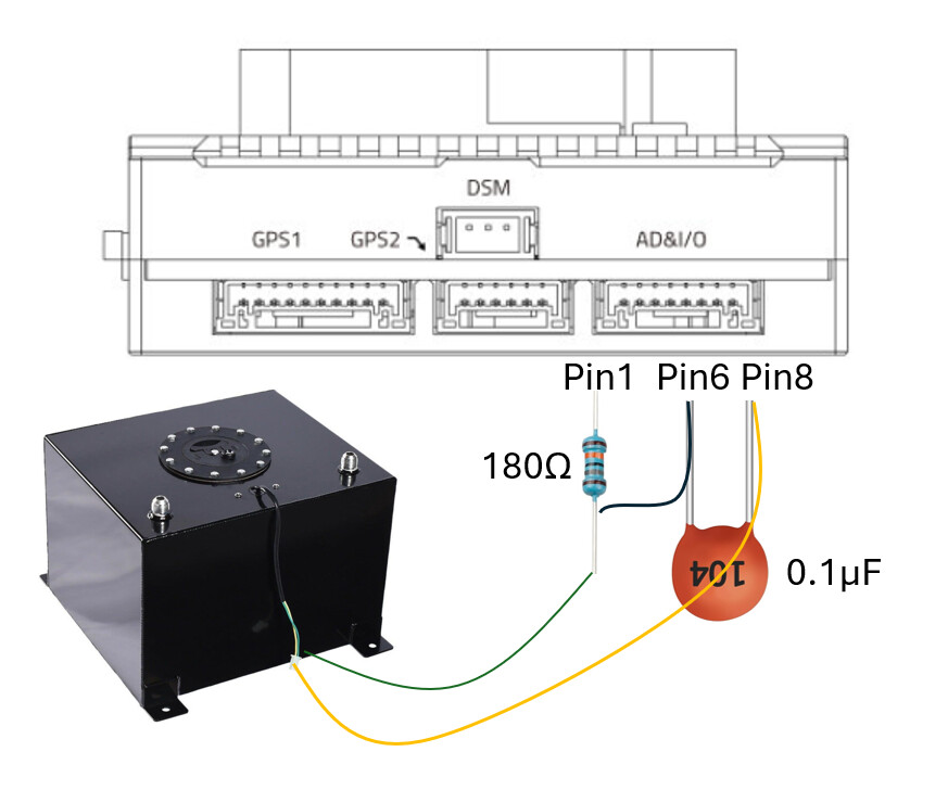

Hope all is well with you and your bro - take a look at my fuel schematic and see if I missed anything. ChatGPT helped with the instructions…cd
I think your post of the fuel sensor setup is great. It looks fine to me as long as the voltage being read by the Pixhawk is always below 3.3v for all float levels in the tank. You did a great job of laying this out for others to use.

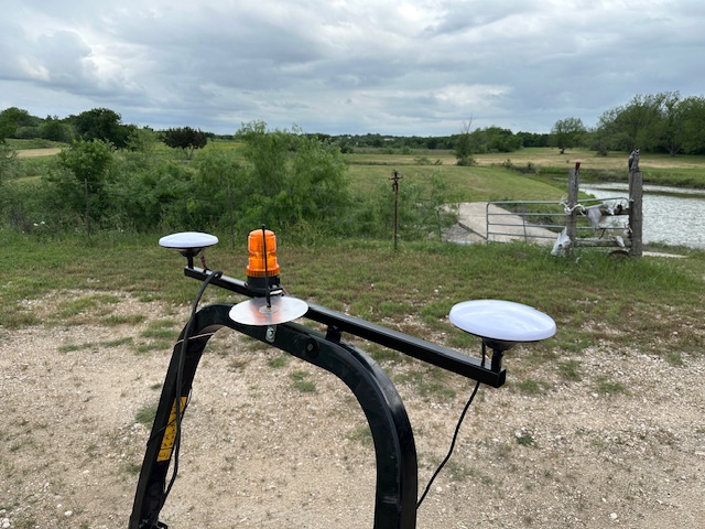

Thanks for the config @SJohnson ! I just moved my telemetry and nav antennas to the top of my ROPS hoping to alleviate a float/no fix issue, but no joy. Further I may have a problem with one of my servos. Likely self inflicted, but will start troubleshooting and see what comes up.
Re the antennas - WAY easier to manage the POS settings than my last array. . .
No judgement on my wire treatment - just in place to make sure it all works. Will dress them in when all is tested.
Also, magnetic mounting of the safety light worked out well - has been in 4 locations so far…
Great to see the upgrades and see you are still working on the mower. My antennas are up high also and the only trouble I have is tree branches once in a while, so I have to either trim the trees or stay farther back from them.
I think all mowers should have a safety light!

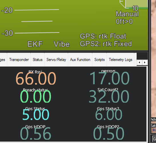

Ok - fiddling with this too long:
Problem - cannot reliably attain RTKfix on both GPS radios.
Work to date - moved GPS antennas as lower mounts thought to occlude parts of the sky; fiddled with GPS config settings (with ardupilot reboots in between); compared my config to @SJohnson 's (his setup is slightly different, older rev, but close); researched what I could find in ardupilot forums.
Logs from today: Ardumower-TORO - Google Drive
Config:
24Apr25.param (16.2 KB)

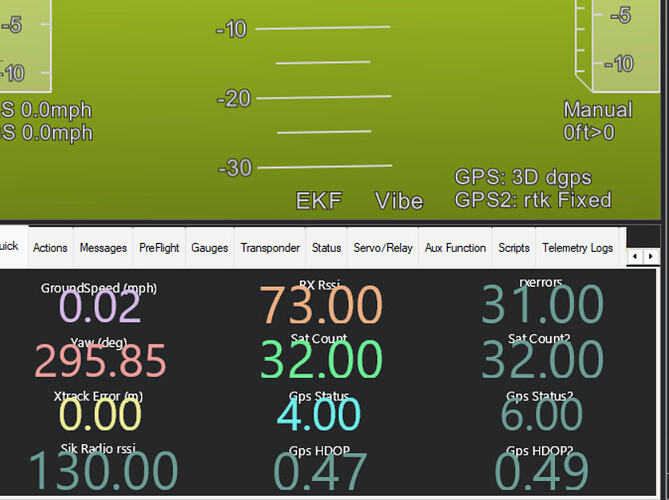

You need to separate concerns. Is it the moving base or onboard rover that’s problematic? In other words, is GPS1 or GPS2 the issue?
Step 1:
If you stop sending external corrections, does GPS2 retain an RTK Fixed state?
Thx for jumping in Yuri - totally appreciated. GPS1 seems to be at issue - RTK Float is the norm for that radio, but not always. In clear view of the sky and with corrections being sent for > 15min, still mostly RTK Float. This used to be my indicator that I didn’t turn on corrections and after enabling, GPS1 went to RTK Fixed. Not the case anymore.
I’ll double-check the corrections this afternoon and reply, but if memory serves, for GPS2, RTK Fixed remains with/without corrections.

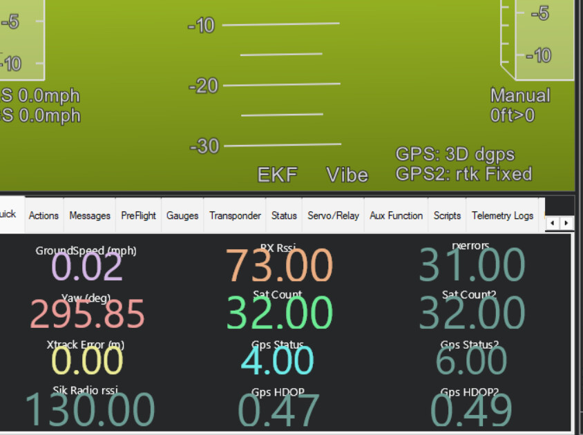

Fresh from boot of ap/radios; no corrections; clear view of sky
Corrections enabled
Noticed “breach status” (from object avoidance / fence testing) replaced my sat count for gps1; fixed for tshooting nav

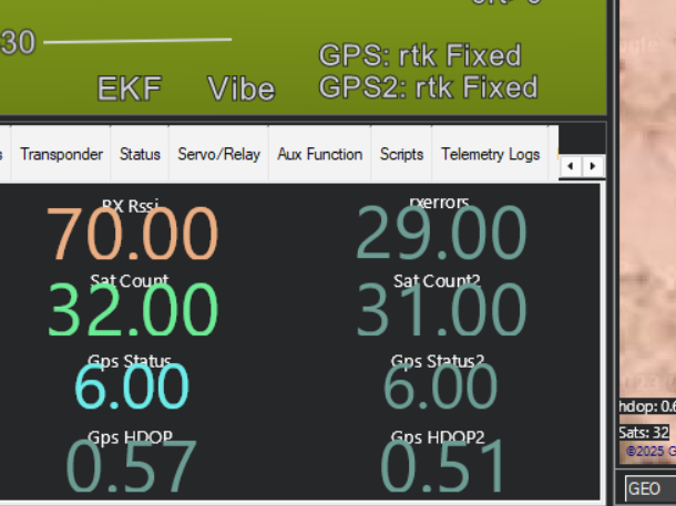

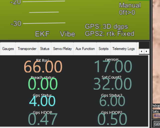

Swapped connections to antennas - no change
Swapped radios - RTK Fixed on both (left corrections on) (might not have waited long enough for RTK Float to reappear)
Corrections off
Swapped radios back to original - initially RTK Fixed on both (with corrections on), but over a short time (3min) became intermittent RTK Float/Fix - mostly RTK Float.
Getting Unhealthy GPS Signal too (when not in RTK Fixed)
This feels like I’ve mucked up the configuration of one of the radios in Ardupilot/MP config. I haven’t had to touch the radios with U-Center since the first day I installed them.
Was hoping for a cabling problem - easiest for me to resolve. Anyway, if you can point me to some diagnostic tools, ie., what data labels to review in the logs would be really helpful.
