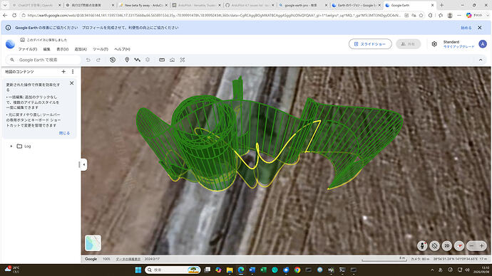

I experienced a serious fly-away / circular flight behavior after upgrading my CUAV X7+ from Copter 4.6.3 to 4.7.1.
The same aircraft and hardware fly normally with Copter 4.6.3, but the problem occurs with Copter 4.7.1.
The sequence of events in the 4.7.1 flight log is as follows:
  1. The aircraft takes off normally and enters Loiter mode.
  2. GPS reception is good, with approximately 23–25 satellites and HDOP around 0.56–0.60.
  3. RC inputs are essentially neutral; the pilot is not commanding the circular movement.
  4. At approximately 97.1 seconds, an EKF yaw reset / in-flight yaw alignment occurs.
    • Log event: EV 62 – EKF_YAW_RESET
    • Message: “EKF3 IMU0 MAG0 in-flight yaw alignment complete”
  5. Immediately after this yaw reset, the flight controller begins generating large Desired Roll and Desired Pitch commands.
  6. The actual aircraft attitude follows these commands, and the aircraft starts moving in a circular/spiral trajectory without pilot input.
  7. At approximately 113.95 seconds, I switched to RTL. The mode change to RTL was correctly recorded, but the aircraft continued the abnormal circular movement instead of recovering normally.
The important point is that the aircraft does not simply drift. The flight controller itself appears to generate large roll/pitch targets immediately after the in-flight yaw reset.
I also tested the same aircraft with Copter 4.6.3, and this behavior did not occur.
