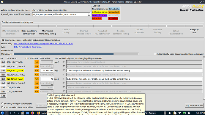

Can I report an issue here? Sometimes when an explanatory dialog box is big enough, the bottom part will clip out of view. So it is possible to dynamically adjust the dialog boxes depending on the position and size of the dialog? I am on Linux (X11, Ubuntu based)
I prefer reports using the correct way of reporting software issues
I will try to move the tooltip box upwards, so that it fits inside the window.
Thanks I’ll create a big report there

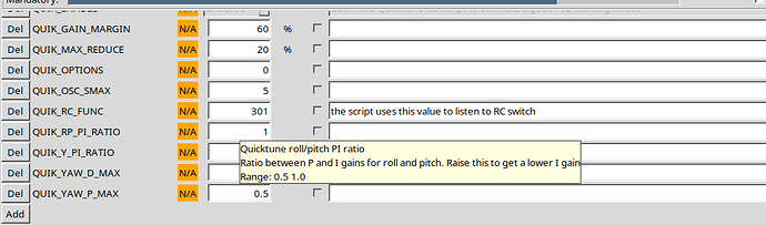

I tested the new release but it seems like now the tooltips occlude the field over which you hover. That is, the lateral alignment is off now by not being flush with the right or left edges of the field
Sometimes the tooltips if they are big enough causes problems with occluding other fields too so you can’t hover over those occluded fields.

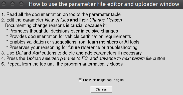

Clear, probably I was too naive and thought that tool can help novices who don’t understand what they are doing to configure their drone by pointing to minimal knowledge they need reading docs, but it comes that you still need to understand and check all parameters you are feeding in. Thanks for clarification.
Yes, it does exactly that. And the novices need to read, understand and use the docs that the tool points them to.
Nowhere in the documentation nor YouTube videos does it say that it does everything automatically for you, nor does it say that you can turn your brain off and stop thinking :thinking:
Yeap, now you got it.
@mike_tk here is one of the instructions you did not read:
