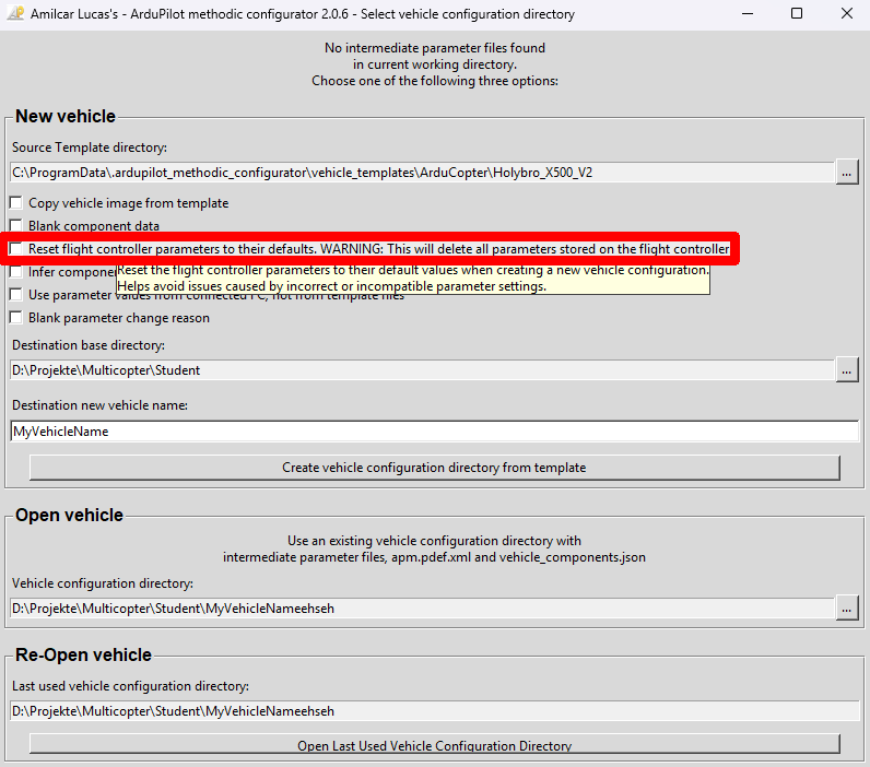

v2.0.6
Added the option to reset all parameters to their defaults before starting the configuration

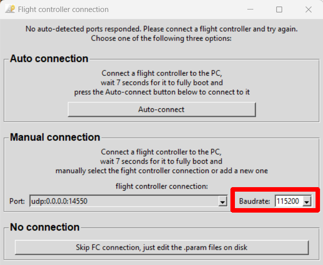

v2.2.0
New feature: FC connection baudrate selectable in the GUI

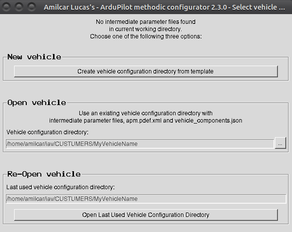

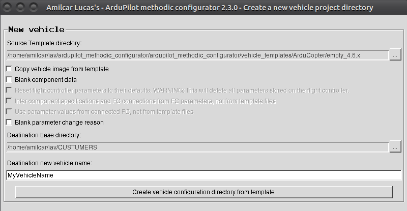

v2.4.0
Changes since previous release (v2.3.0):
Separated project selection UI from project creation UI:
