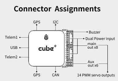

But does Cube orange+ mini have aux channels?
And yes i have main 1 to 8 main out in cube plus wher I’m using 1 to 4 for motors and 5to8 for leds.
Sure it does. Use them for NeoPixel. You can find this kind of info all over the place:
