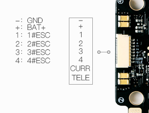

Need help with ESC telemetry for CUAV V5 with Velox V50A Tmotor 4 in 1 ESC
Hi I’m using CUAV V5 with 4 in 1 ESC Velox V50A from Tmotor.
I’ve I’ve connected the ESC signal with Autopilot via regular signal pins and also via AUX pins.

I think You need to use AUX pins, and configure mask properly to enable bdshot on them.
Be sure to use the side DSM/SBUS/RSSI port for your RC signal in - the SBUS pin.
If the motors spin with the MissionPlanner motor test, then probably only the telemetry wire is connected wrong. ESC Tele wire to RX pin of UART4 (or Telem2 if you wish).
I would change the ESC telemetry wire over to Uart4 anyway, to keep that Telem2 port spare for accessories that might need the RTS/CTS lines. The same two pins are used, RX and GND, in the same positions too so you can just shift the connector.

This is not needed, only where you have other servos operating on DSHOT that are not the main motors.
SERVO_BLH_MASK,0
And if you have the motor/ESC signal wires connected to A1 → A4 of the V5 you are good to go, and a - pin to the ESC GND
Beware: dont connect the + of the ESC connector to anything, it has full battery voltage on it and has no place going near the flight controller. I remove the + and Curr wires from the housing if I’m not using them.

I’ve connected in the AUX port 9, 10,11, and 12
I’m able to arm the drone via transmitter
I checked with those option Telemetry cable was connected to Serial 2 RX pin,
BLheli version is 32.9
