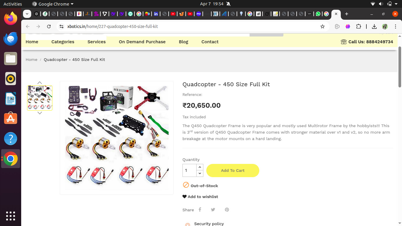

we are using f450 frame and simonk esc
sir i would like know from you we didn’t fix anything so far.
Your description of the motors is suspect too. Do they look like this?
yes sir..
we would like go for an good and advanced one could please suggest some..
basically we got them as a bundle i will attach them below..
Unfortunately I think that’s a kit of exactly what not to buy.
I would start with EDU-450 or X500.
Then decide between outdoor and indoor localization options.
It’s very disappointing seeing a new builder, particularly students, start out with a kit like that. Based on past experience here with plenty of others in your situation, students in India, the problem is sourcing acceptable hardware that you can afford.
That kit shows a Pixhawk 2.6.8 but you have a Pixhawk 6X?
we got Pixhawk 2.4.8 from kit later by our research we came know that its not at all useful for us so that we bought 6X seperately sir
we will buy X500 frame sir..
we need indoor localization sir
Excellent. That’s the one piece of hardware you have that is a great choice. And the X500 frame/kit would be also.
