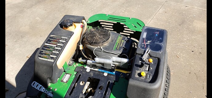

I converted the mower, a John Deere z445 to RC in 2020 during covid. It’s worked flawlessly from day one. I’m retired and have back issues and need to convert it to autonomous operation.
I am definitely not nearly as sharp on this stuff as many of you on here. I have read through many of the posts and am impressed with all the knowledge y’all have and your willingness to help out. I’ve read a ton and have a good start and have made some headway but it’s getting a little overwhelming.
I’m trying to perform the motor test in mp. The flight controller is denying the request. I’m connected to the fc via mavlink. I’m using a sabertooth 32 motor controller to power 2 linear actuators for steering and throttle. I’m using a Flysky I6x tx and a FS-ia6b receiver connected to a cube orange + and cube pilot uavonix carrier board. I’ve set what I believe to be all of the parameters for this stage of the setup. I eventually want to install the cuav rtk 2hp and get gps yaw working. I have the ntrip working. So, I’m getting there but some help and advise would be greatly appreciated!

Thanks for the encouraging words. I’ve made some progress and each time I advance just a little, it is a rewarding feeling. I’ve just never dealt with this level of complexity but I like a challenge. Up to a point though. Then I have to step back for a while. It appears that actuators aren’t as popular for these zero-turn conversions but I have over 100 hours operation with no problems.
Whatever works for you. Although I haven’t used actuators I think the concern is that they don’t react as fast as servos. My mowers make razor sharp lines and the servos are working like crazy to do it. I have a video somewhere and will try to post it.
Edit: https://youtu.be/A7pDSTeqnP8
I did a lot of research before I built mine and noticed the concerns about acuators but the setup for those favored the type drives and their location on my mower better. They have a 4" throw and 2" per second travel speed. I like your video!
