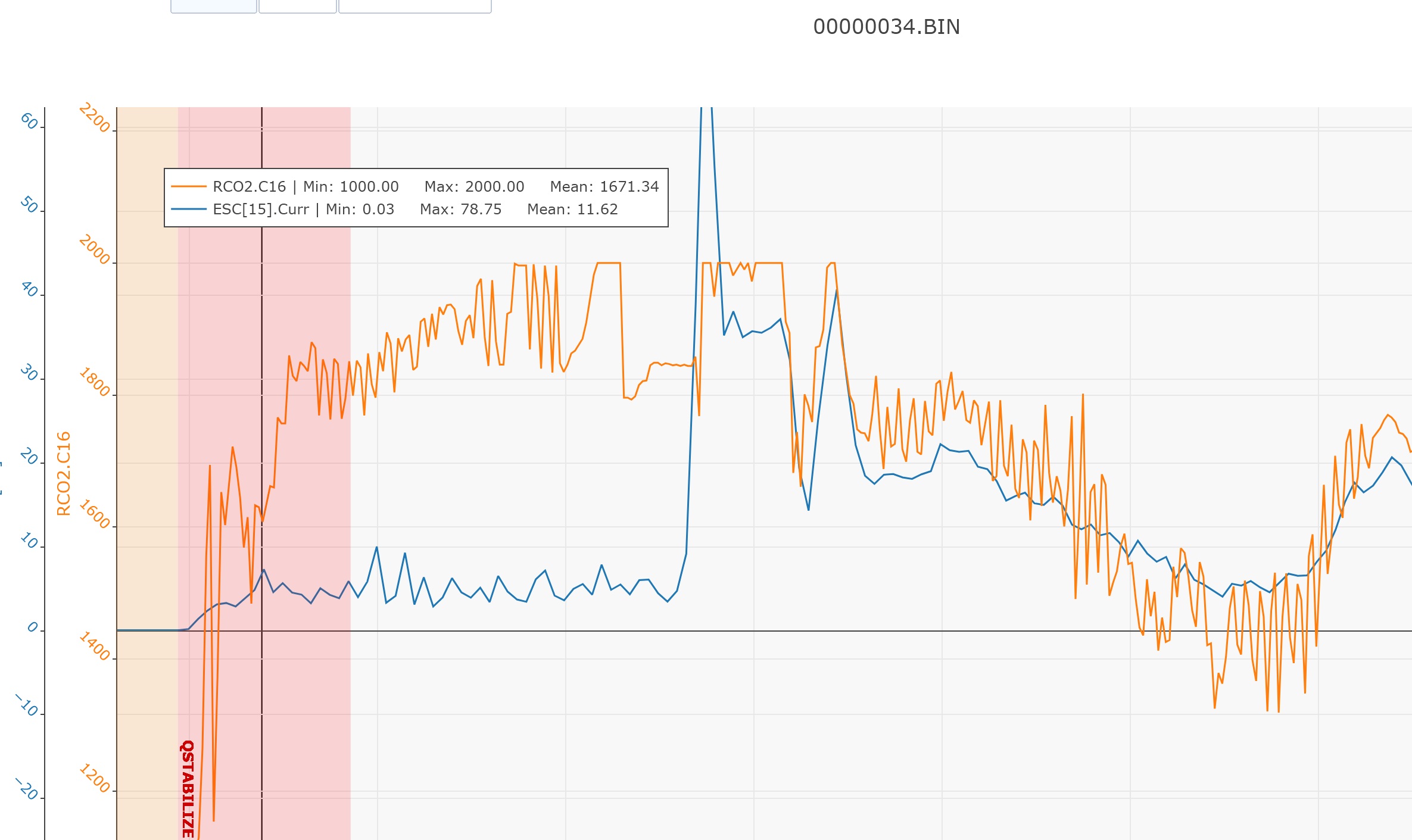

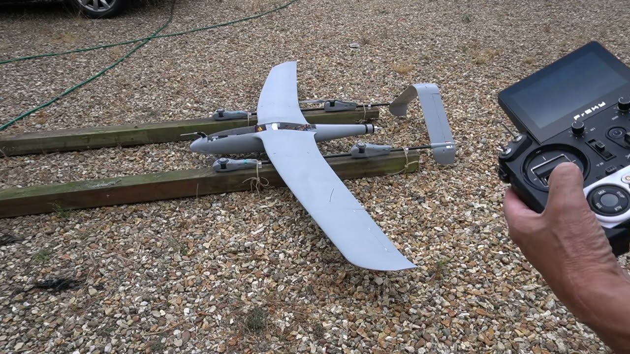

Have just done the 2nd flight of my Kite3 VTOL. On the transition back to VTOL it did an alarming roll and recovered at about 3m. My interpretation of the logs is that one lift ESC was slow to respond to the PWM demand but please advise. I cant see anything else strange here.

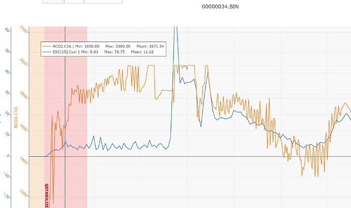

You will see from the logs that the motor balance seems off but this is probably wind effect as it seems to depend on heading.

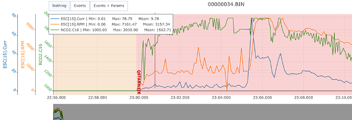

The pic shows the current demand lags the PWM demand but then catches up.
A.I. thinks it could be my ESC setting ‘startup power’ was 50% and min duty cycle was 1%.
The pullup braking is quite sharp and I guess could lead to reverse flow in the lift motors.

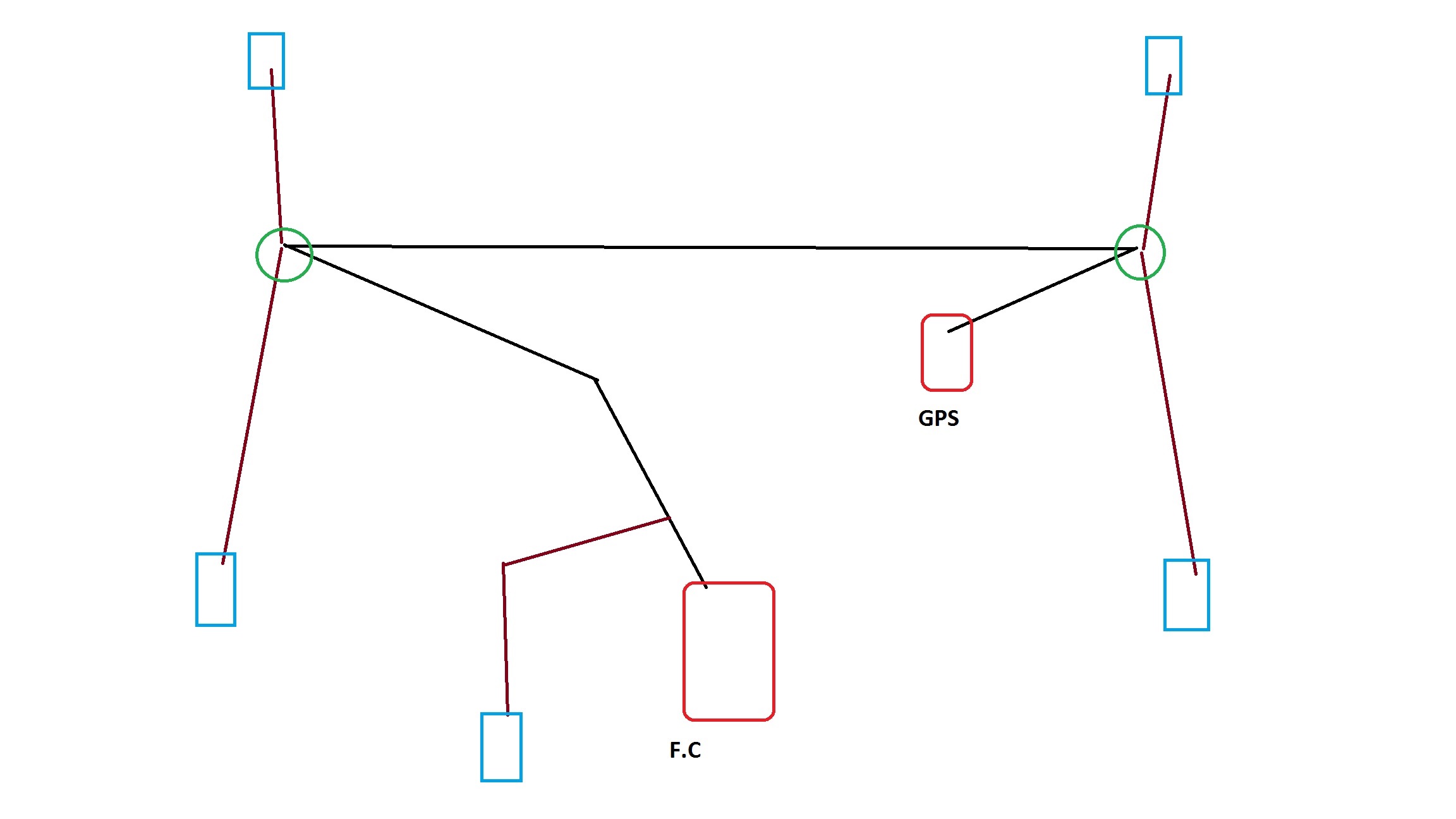

Yes im now convinced it’s due to can stubs being too long. I had a star config with the longest about 75cm. I seem to have got away with it on the previous Kite2 with the same arrangement. Without massive re wiring I can probably do the main line out to the motor beam plug and have 30cm stubs.
The FC and the GPS have fixed terminator resistors so I shall try to finish the line with the GPS in the wing stubs.

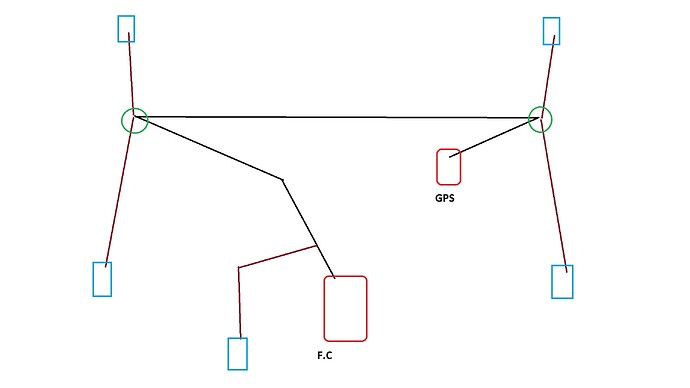

I obviously overlooked some of the canbus requirements so will rewire like this.
The green circles are the motor beam connector block. The stubs are now only 30cm or less.
FC and GPS have fixed terminator resistors.
