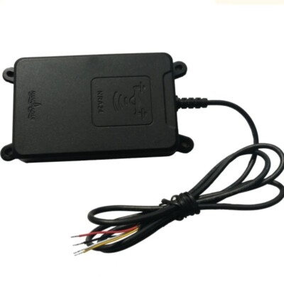

I have a new NanoRadar NRA24 that cannot be made to work with the latest Arduplane 4.6.2 on a Matek H743 Wing V3 on Serial 1 (3.3v) or Serial 4 (5V tolerant) when powered by 12V.
I have it all configured as per wiki. Rangefinder 1 in Mission Planner never registers any readings on the bench. I am aware that movement is needed to register a reading and I have successfully tested this with Nanoradar’s test software ( NSM_Tool_V2.0.7_20250115 I) with an FTDI>USB adaptor. It registers correct readings on the bench.
I have seen others have the same issue when trying to use the Ainstein USD1 driver with this rangefinder. I really think the wiki should make this more clear even it did indicate that it has not been tested via UART by Devs. I suggest updating it to state that UART does not work. I have had to spend another $300 and order a CAN version.
If anyone has any ideas I am open to suggestions. Anyone have one of these working via UART? I am 100% sure the wiring is fine and power supply is fine. I have contacted Nanoradar via email but heard nothing back.

Hi Marc!Nice to meet you here!My name is Jenny a sales engineer from Nanoradar.May I help you? My WhatsApp is 8615973700250, my email is heyazhen@nanoradar.cn. The NRA24 UART has different versions. The open-source version we provide supports it.
Jenny how do I tell which version I have? I purchased the UART version from this seller.
I tested it with your PC software and it works. But not when wired up to an Ardupilot FC as per my first post.
Could you take pic about the NRA24 label,we need make sure about the type. Also can send it to my WhatsApp ,our testing engineer also will in the chat group.
Here is the backlabel. https://photos.app.goo.gl/6aF4RQtMXDNxNEA19
Looks like NRA24 200v1.0.3_U

Yes I was. I contacted Nanoradar’s support who were actually excellent. My basic issue is that I had the wrong version. For Ardupilot you need to have the Open Source version. This is not explained well in the Wiki or even on their website. If you buy a UART version off Ebay or Aliexpress then you likely have the incorrect version. First thing is to download the PC Tool from their website and see if it connects to it via an FTDI adaptor (ie USB>TTL dongle). If it does you have the wrong version and you need to use that same tool to flash the firmware – this is really easy to do BUT do it carefully as it is a one-way trip. I could post the firmware but I do advise you to send a pic of the version to Jenny of tech support (see a few posts up). If you power-down accidentally while flashing you can brick it and I understand as of now you can’t reflash it after flashing the open source version. Their downloadable tool does not work with the open source version. I think they can send you a version that will. It is my understanding that they are going to release a version of their tool that will work for all versions. Here is the page to download the NRA24 PC Tool software. Drone Radar_Hunan Nanoradar Science &Technology_Accurate Detection
Here is their manual for the Open Source version.
And here is the UART version of their open source firmware. Proceed with caution and make sure you do indeed need to flash it by verifying what version you have by connecting their tool as linked above. I also have the CAN version of the open source firmware.
