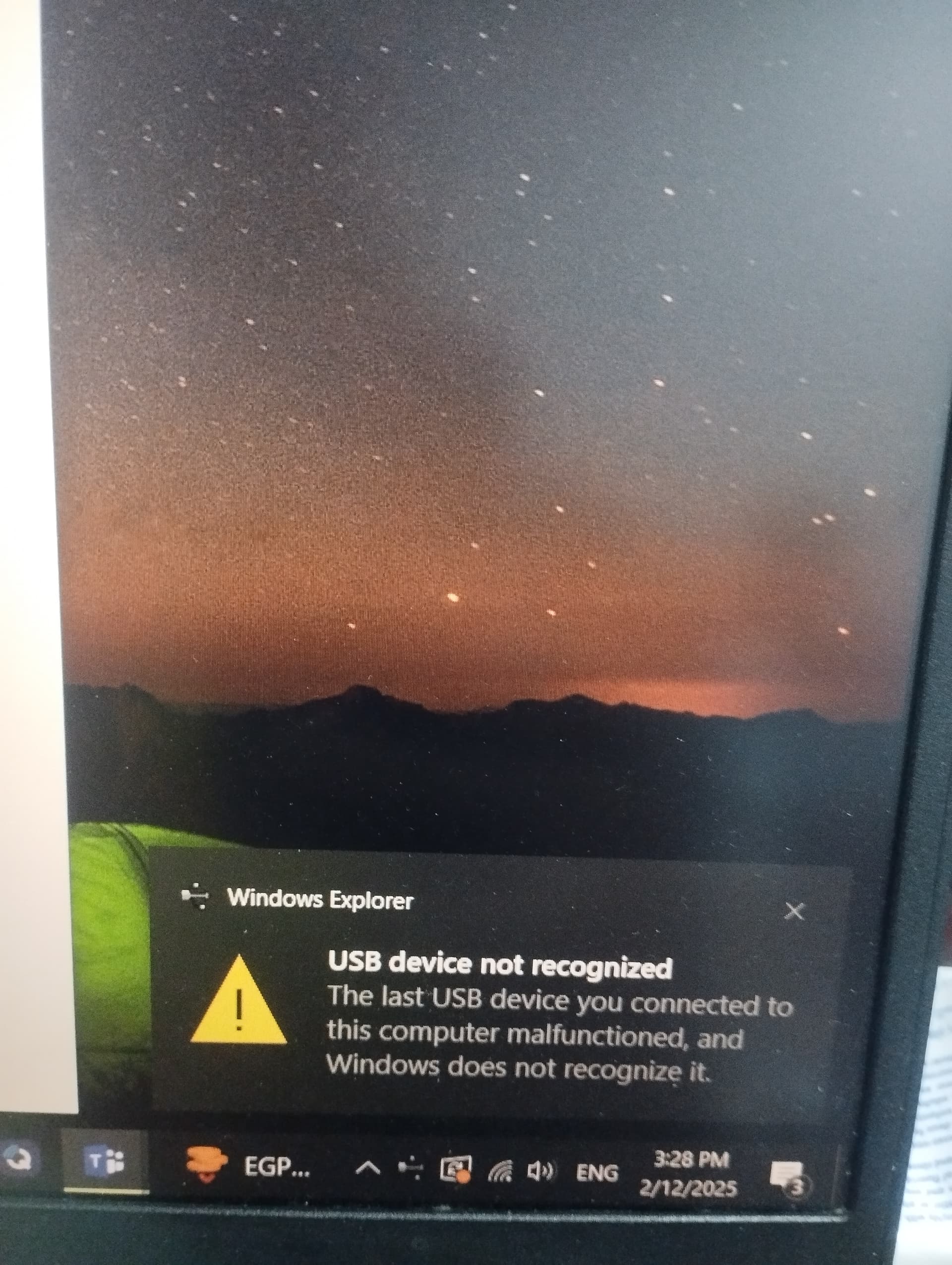

My laptop not recognize Fc
Some one give me drone to repair it when I connect it to laptop it’s not recognized but the Fc is ok and working
I think he disabled msp or USB some how

How are you trying to connect and to what? Mission Planner?
USB cable . Laptop not recognize it at all

Press the Boot button, plug in the USB cable and flash Arducopter with whatever application floats your boat.

My issue my laptop not recognize the Fc because usb disabled I just need solve for that
Do as Dave suggests and then start the ImpulseRC Driver Fixer. Normally this will fix the DFU connection and activate the correct driver.
Then disconnect and reconnect the USB cable. Then it should work directly.
