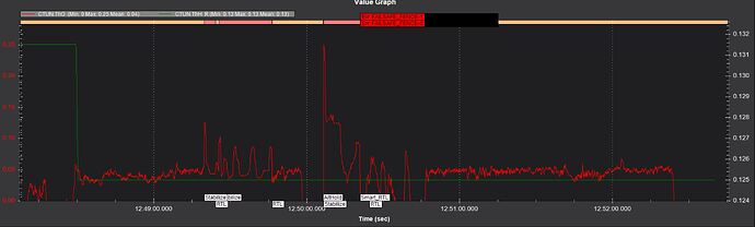

I think you have the pleasure of having a quad that is very highly powered. In general, I would say the quad did what it was told, while I appreciate that wasn’t what you wanted or expected.
When the quad was in Alt hold, there was a very slight descent, but controlled and not falling out of the sky. (much less than 1m/s)
Notice the throttle output is very low and the motor outputs are averaged below 1400. Probably closer to 1360-ish. Also notice the throttle was below half, also below 1400.
When the quad did it’s moon shot:
In stabilized mode the throttle is totally under your control. The stick is at mid point, throttle output is higher and the motors are running faster. So the quad climbed. It’s worth pointing out that as you pulled the throttle down the climb did level off, but I appreciate at over 100m that might have been very hard to see.
My gut reaction is to say that MOT_THST_HOVER is still to high at 0.125. The log suggests to me something like 0.06 (give or take) but I don’t have any experience setting one that low so I don’t know if that’s safe or not.

What do you think about bringing MOT_THST_HOVER to 0.06 or there abouts? Is it reasonable to go that low with it given how this appears to be powered?
Yes, I was writing what you suggested when you posted. The craft will be a handful but it can for sure be tuned. If this was my craft I would have weighed it w/o the battery and then bought a 6S battery of a weight that would produce a desirable thrust/weight. It’s what I always do.
MOT_THST_HOVER shouldn’t allow values below 0.125. I suspect if you intentionally set one that low, that it will revert to 0.125. Might be worth testing to confirm, but I recall a discussion with Leonard to that effect.
Right. It will not learn a value below .125 but you can set it manually. I have a few craft in that range.

A clue. There is no Vibe problem and what you experienced was not unintentional. If you don’t believe the reason that was given in the above posts then believe this if you know what you are looking at.
I just added a note to section 7.1 (first flight) about setting the MOT_THST_HOVER for high powered copters. So @FossilRider Use the latest version of the Methodic Configurator and read the documentation that it presents you in the browser and you will be fine.

I’ll be blunt: You’re making a mistake. Vibrations are not the problem and if you introduce too much foam or other damping you are risking introducing problems.
From your original flight log:
Most vibes below 10, other than a couple of peaks. It’s not broke. Don’t fix it.
You are barking up the wrong tree.
