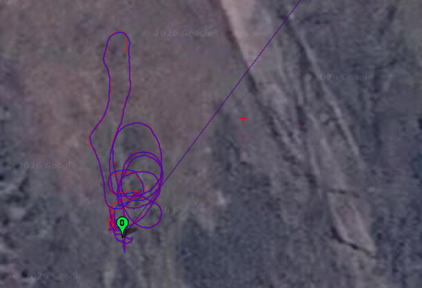

However, in Circle, it seems to be a random ride. I can see some partial circle shape in the track log, but these circles are not located in the same place, and in general it is not reproducible. Also, I can’t see any turn servo corrections. How to diagnose this problem?
The log (here, the Auto route has been set in a completely different location, but I’ve tried only Circle)

It sounds like you have the steering reversed. Then you have reversed the RC to fix it rather than reversing the controller servo output.
