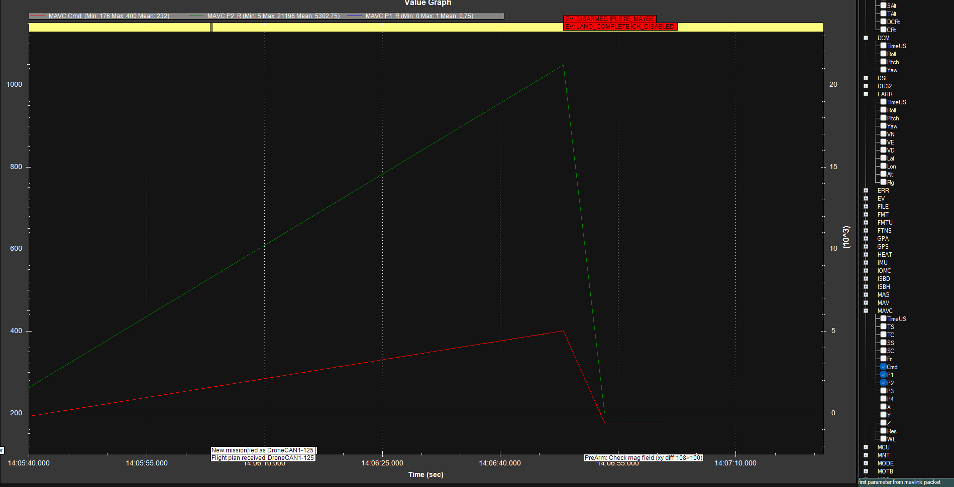

Hi, I just had a look on the logflile.
Apparently, the channel in #3 is constant (so it might not be a rcin failsafe).

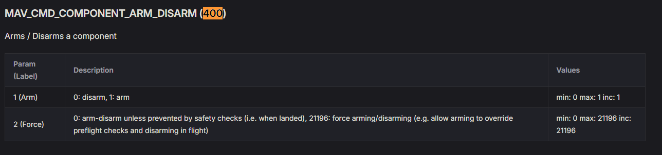

But the MAVC logs show that the flight controller receives a mavlink command. The message id is #400, so it’s a arm/disarm command, and the field P2 is 21196 which means ‘Force’. So the drone received a ‘force disarm’ command from the gcs midair.
Looking your log, you have numerous rc failsafe and gcs failsafe. If you have a poor GCS/Drone link, it could be an old command sent minutes later (I had it once using rockblock).

Thanks @AlexisMGL.
I have a screen recording of the GCS for the entire duration of the flight and the disarm command has not been given from it. Is there any other way that this can happen? (Possibly from the controller?)
Within 5 seconds of the new mission being uploaded in the air, the drone got disarmed.
Do you have a tlog file ? it could help
But usually, controller only sends channel in signals. What GCS are you using ?
I am using QGroundControl. I do not think I have the tlog file anymore.
