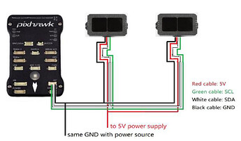

On second thought, are you sure TF02 pro supports the I2C interface?
Some people on the internet are suggesting it could be due to a power insufficiency issue. Then you have to use external power to power each of them. Application of TF02-Pro IIC in Pixhawk.
Alternatively, you may want to use the GPS 1 port pins 4 and 5 without an I2C splitter to see if it works.
The TF02 pro can be used either with serial protocol or with I2C. The ardupilot rangefinder documentation doesn’t include the TF02 pro i2c, but I got the I2C version from Benewake and the manual says that it is compatible with Pixhawk. I don’t think this is the problem. Both of the Lidars get power from a large 4in1 BEC from Mauch, so I don’t get how it can be a power insufficiency issue.
I will try to power them individually, externally and also use the GPS 1 port.
Thanks for the reply
You can disconnect the I2C bus connector on the FC, connect it to an Arduino and check independently with an i2c_scanner or similar program, and check if the lidars and other I2C devices are detected, with their different addresses.
If that works, try an Arduino program to read the lidars alternatively.
It seems not needed. You can use a passive splitter:
